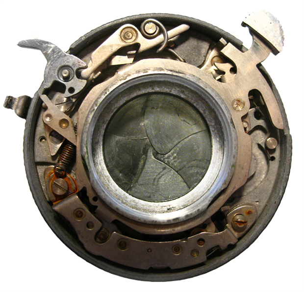

After many years of usage there are several parts in a camera which can require replacement. One of them are the curtains of the shutter – often made of rubbered silk, controlled by a mechanical clock-like mechanism, which controls exposure times. Sometimes the shutter needs to be disassembled also during replacement of the grease and lubrication of the mechanism.
After reassembly it is necessary to check the correctness of the work of the shutter. All times has to be controlled because multiple problems are possible – the shutter has to:

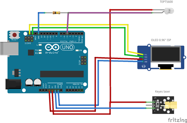

I decided to use an Adafruit SSD1306 OLED screen and a Chinese laser module (Keyes KY-008). Both of these modules can operate on voltage from 3.3V to 5V, which are supplied by the Arduino board.
The most important part of the device is the photoelement. After my research I decided to use phototransistor. Some further research shown me that the range of phototransistors sensible to red laser light (635-650nm) are not so common. I’ve found a series of TEPT phototransistors, produced by Vishay [1]. For my particular application I’ve chosen Vishay TEPT5600TEPT5600. The phototransistor itself has got a very good datasheet [2] and very attractive price.
In the presented configuration, the LST can be used for measuring shutter times as short as 0.00061s (enough for speed of 1/1000s). The program is using Arduino micros() function which, combined with Arduino Uno 16MHz clock, produces resolution of 4us. The phototransistor, according to the datasheet [2] has got rise and fall time of 310us. In the worst case scenario, the total rise and fall time is 620us, measured with resolution of 4us. If a better performance is needed, a load resistor of the phototransistor should be replaced as described in [2]. The Vishay TEPT5600TEPT5600 phototransistor was selected as a very cheap module, easily accessible, with good documentation and reliability. The resistor visible in the schematic below is a load resistor, chosen to suit the phototransistor, according to [1].
The overall device is presented on the schematic below:

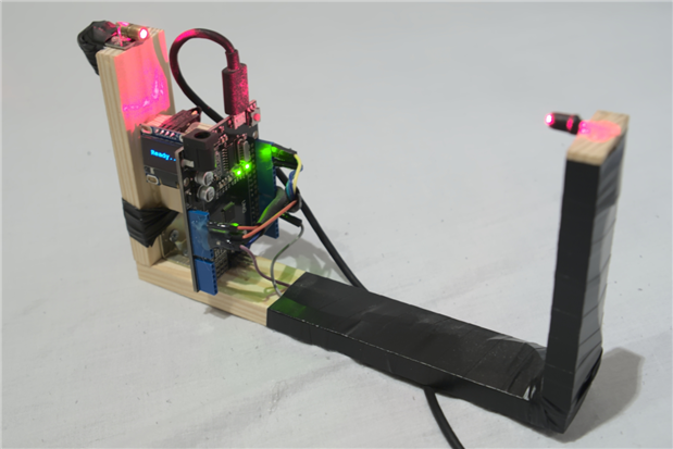

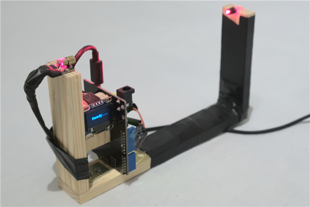

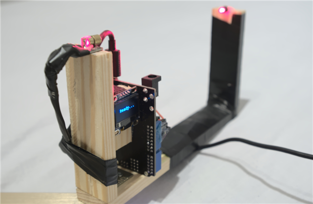

All modules were mounted on a wooden frame to provide rigidity and stability of the laser beam.
Usage
After powering up the LST it will boot and display "Ready..." on the screen. Afterwards, the tested shutter should be placed between laser emitter and sensor (the laser's beam must be placed within the shutter area). Next the camera should be fired at preselected shutter time. The measured time will be displayed on the screen. If it is longer than 1 second, it will be displayed as a decimal fraction. Otherwise, it will be displayed as both decimal and proper fraction.
