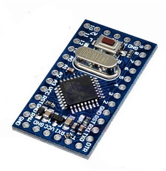

So as I'd made these two elements rather too easy, I decided to forego using a Real Time Clock module. Some of the Arduino's in my collection have actual crystal oscillators on them, rather than rather temperature sensitive and fundamentally inaccurate ceramic oscillators. So if the RTC module uses a crystal and I've got an Arduino with a crystal on it, why can't I write the code to run a reasonably accurate clock? The single biggest issue is the an RTC uses a crystal tuned to 32,768Hz which is rather easy for a computer to divide down to 1Hz aka a one second tick. Whereas I've an Arduino running at 16MHz which doesn't divide so easily and, as a surprise to some, means the millis() function is actually off by just a little bit. It's reliable & consistent, but the difference needs to be corrected. I already had some pointers from various pages on the internet about tracking the accumulating error and how, once there has been some calibration, the difference can be accounted for.
This is a fairly typical Arduino Pro Mini with the large oval can that is a proper crystal oscillator.

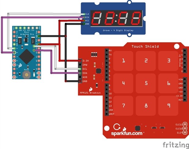

Here's the connections to be made:
There is some artistic licence going on here with the TouchShield - but the labels are very clear on the 12 pad model like the parts I used here.

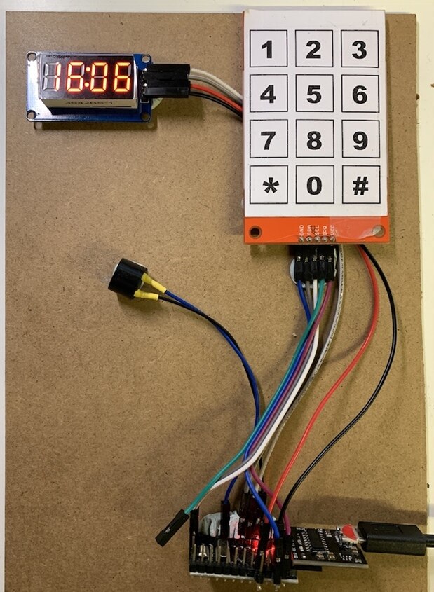

And this is what I've got going now.
You'll spot that I've sneaked in a piezo buzzer as well so the alarm makes a noise - I've got those on pin 5 and ground.

    Arduinos typically come with crystals, you probably already know, but it's to support an external clock(some chips such as 328P have a 1MHz internal, while arduino IDE wants 16 and the chip supports max…
  • hugohu
    hugohu over 5 years ago in reply to ajcc
    Oops, must have recalled for the wrong chip.
  • ajcc
    ajcc over 5 years ago in reply to hugohu
    hugohu  wrote:
    Arduinos typically come with crystals, you probably already know, but it's to support an external clock(some chips such as 328P have a 1MHz internal, while arduino IDE wants 16 and the chip supports max 20MHz)
    The internal RC oscillator is 8 MHz and the Atmega328P chip comes configured to run at 8 MHz.
    If you dig into the Atmega328P datasheet you'll find that there's a low-frequency crystal oscillator made for use with watch clock crystals. However using that as a timer reference does require the Atmega to run on the internal RC-oscillator, because it's using the same XTAL1 and XTAL2 pins. Although I guess that also makes it somewhat easier to modify one of the small Arduino boards? (But it still requires new loading capacitors). As far as I know you can't change the fuses without modifying the board-files, but I haven't used the Arduino IDE in a long time so it might be easier these days?
