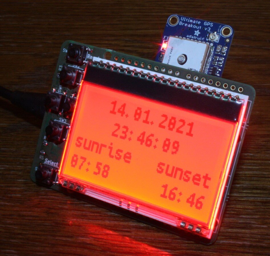

My project is based on an Arduino MKR WiFi 1010.
As GNSS receiver I use the Adafruit Ultimate GPS Breakout (https://www.adafruit.com/product/746 ). This is based on the MTK3339 chipset.
As display I used my ArduHMI shield which I already introduced here: NFC-Badge - Update your badge with your smartphone - Design data of the HMI shield . The latest version of the shield has also an Arduino MKR connector. So it can be directly plugged on top of the Arduino MKR WiFi. The data of the HMI shield is available on github: https://github.com/generationmake/ArduHMIShield

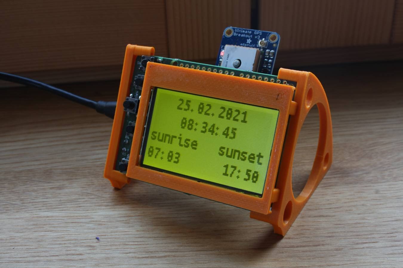

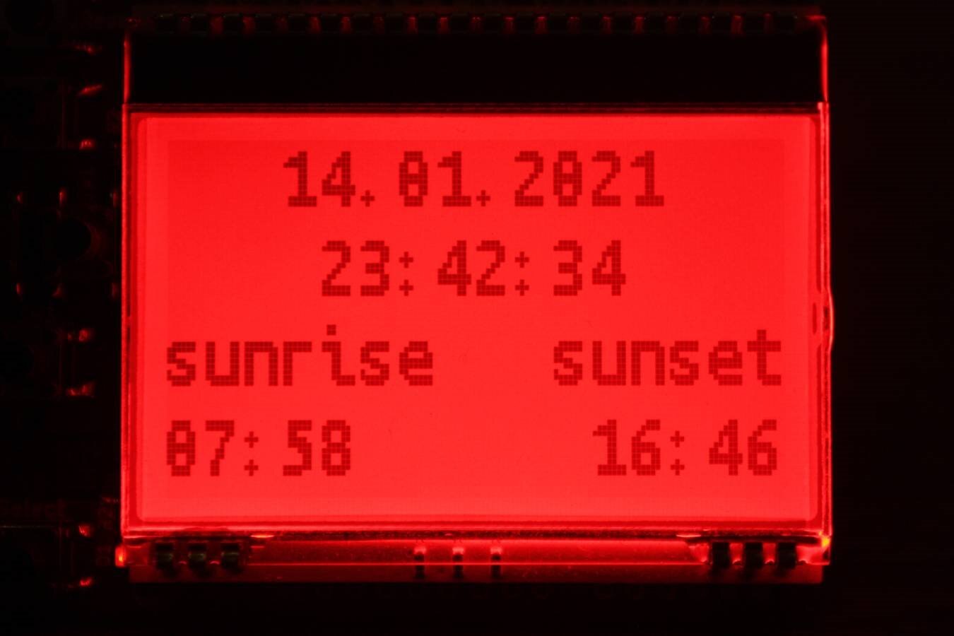

The first screen shows time and date on the top center. Additionally it prints the time of sunrise and sunset of that day.

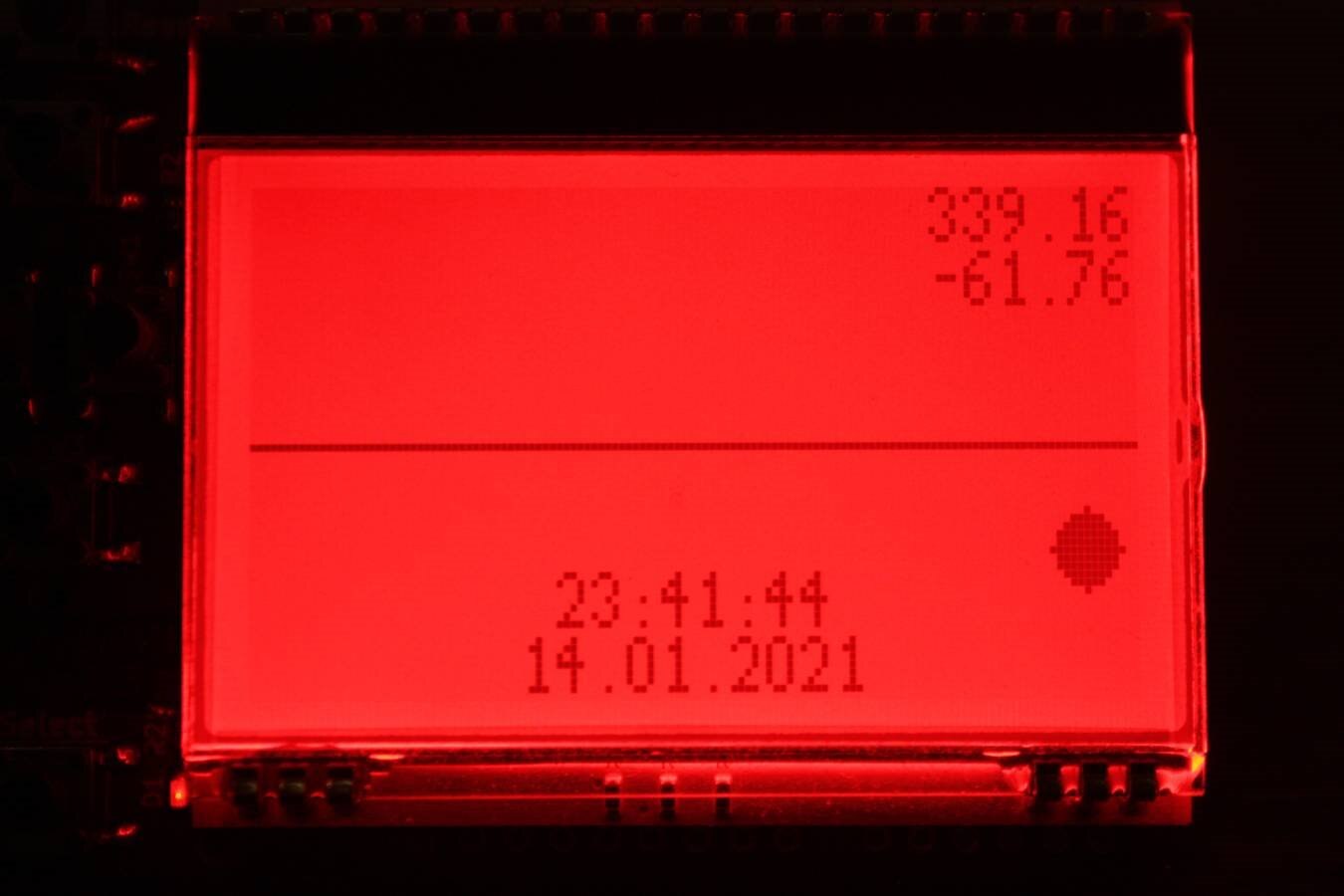

The second screen also shows date and time, now at the bottom center. Additionally it draws the postion of the sun as graphic. During the run of the day the sun will pass from left to right. additionally the numeric values of the postion of the sun are printed on the top right.
The following is a time laps video which shows the path of the sun during one day. Sorry for the bad quality.

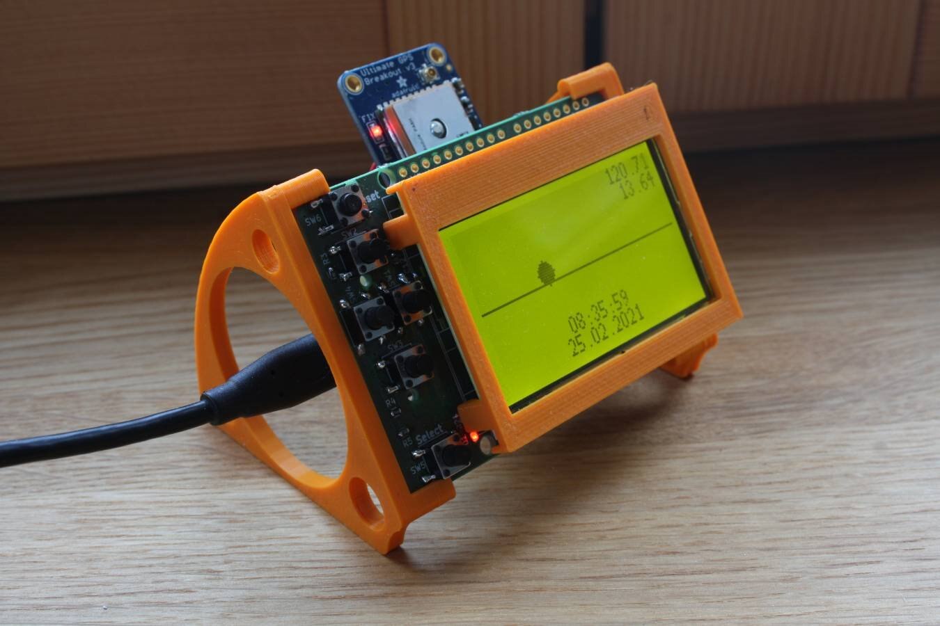

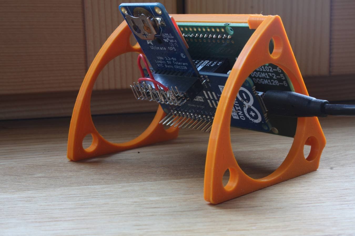

Holder
(update 2021-02-25)
In the last days I constructed a holder so that the SunPathClock can sit comfortably on the desk. Additionally I also constructed a protection frame for the display. The display has a glass substrate and may be easily damaged. If the display falls only sligthly on one edge and then the glass cracks and the display is destroyed. I already destroyed several of them. The frame hopefully reduces this risc.
The holder was produced with a 3D printer. The production data for the holder is available on the github repository for the shield: https://github.com/generationmake/ArduHMIShield/
