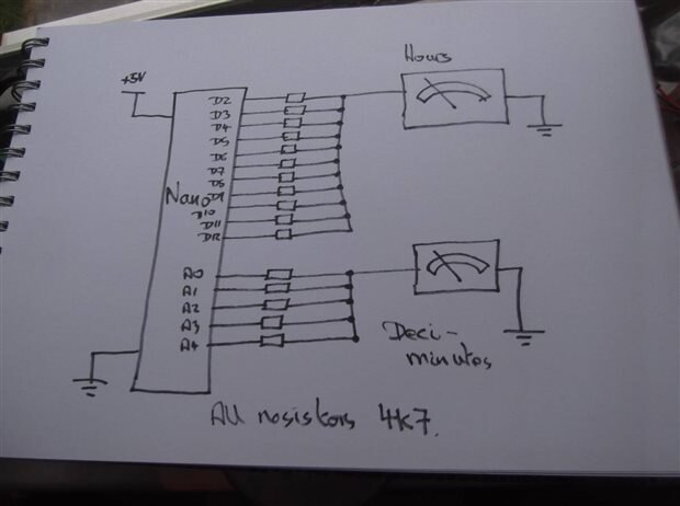

After a long think about what I might do for the Making Time Project14 challenge and thinking I might not be able to come up with anything suitable I had the idea of creating a current flow that would represent the time, hence the name current time. I thought it would be fun to create a circuit that would create a current between 0 and 11 microamps to represent the hours 0.00 to 11.00 o'clock - I had trouble thinking about whether 12.00 o'clock should be 12.00 or 00.00 and in the end decided on using 00.00. So all I needed was to create 12 different current steps, 0.0 microamps to 11.00 microamps. My initial idea was to use a stabilised voltage source such as a Zener combined with high precision resistors, controlled using analogue switches. Sadly, at this point my thinking went awry and for some reason I decided that I could use analogue multiplexers for the analogue switches with just one value of resistor. As I had some analogue multiplexers and had just purchased some resistors I thought I would be OK. I also wanted to use moving coil meters to display the time, one for hours and one for minutes. At this point I stopped thinking and went to do something else assuming that I could get the meters later.
Unfortunately it seems that low cost moving coil meters can only be obtained from China and the delivery time was after this competition ended. I was then about to give up when I just thought 'well, I could use digital multi-meters to display the two currents', as a sort of proof of concept. I was just about to start construction when I also realised that analogue multiplexers would not provide an incrementing current value if the same resistor value is used. So, I was about to give up for a second time when I thought 'maybe I could use the 4.7V digital voltage outputs from a Nano, with a 4.7 MOhm resistor on the output to create the increments of 1 microamp. Unfortunately, Nano outputs do not work properly unless more than 100 microamps is drawn. Was I discouraged? Yes! But decided that perhaps I could use 1 milliampere increments rather than 1 microamperes and happily, this is the case. So I needed 11 digital outputs from the Nano for the hours - it has 12 so that was OK.
I decided to make a neat little stripboard construction, with turned pin sockets as I had a Nano with turned pin connectors already soldered in. Everything went fine, everything was soldered together, I made preliminary tests and it seemed to work quite well, although getting exactly 1.00 mA increments was difficult but I managed 1.0 mA +/- 0.05 mA which I thought would be satisfactory. After all, the original design called for moving coil meters and these small discrepancies would not have been visible. At that point the Nano decided it didn't want to be programmed anymore so I had to change to a Nano with the square 1 mm pins, which of course, do not fit into turned pin sockets. Nor could I get any turned pin connectors in time to solder to a different Nano. So at that point I gave up on being next and went into just getting it connected together somehow mode. I used a protoboard for the Nano and used single core wire to make connections to my already assembled stripboard - as I didn't have enough 4K7 resistors to start again!. Success, it all worked well.
Then I turned my mind to how to create the minutes. A bit more tricky. To get minute increments I would need 59 different digital outs and 59 resistors, - none of which I had. So I thought, why not use 5 minute increments and then I would need only 11 more digital outputs. Unfortunately there were not enough on the Nano to do this so it would have meant using two Nanos synchronised together. Time was running out and I didn't think I would get that going in time, so just went for 10 minute increments (deciminutes) - why not! This required 5 digital outputs so I used five of the Nano analogue I/O pins, hoping that their digital output voltage would also be 4.8V .Fortunately, they were. And it worked. Houray.
I had hoped to be able to show the 10 minutes increments on the second meter, but this could not be achieved. It needed more than 100 uA to get the analogue outputs to work (programmed to be digital outputs), 1 mA worked but didn't increment in steps of 10 and using 10 mA from each output would have needed 50 mA for the Nano and something was bound to change if I started to drawn that much current, so I settled on just incrementing in deciminutes. I would have worked on a moving coil meter. The circuit diagram is shown below.

    genebren over 5 years ago +5
    Dubbie, Interesting concept for a clock. I was wondering if your mind went down the path of using binary weightings for the current sources. As all the currents sum prior to the meter, you could use a…
    shabaz over 5 years ago +3
    Hi Dubbie, If the Arduino functions expose PWM easily (I think they do, but I've just not done it), that could be another approach (i.e. change the duty cycle, so that the average voltage varies). Anyway…

    dubbie over 5 years ago in reply to navadeepganeshu
    Navadeep,
    There always has to be some voltage drop between the supply voltage and the digital output on a digital circuit and for most 5V systems it is usually around 0.1 to 0.3V. It is pretty much a coincidence that the digital output voltage is 4.7V and matches the 4K7 resistor value in order to get a 1 mA current. I did have some control over the voltages if I used a separate power supply so that I could vary the supply voltage between 4.5 and 5.5V which would also vary the digital high output voltage. Fortunately when the Nano is powered from A USB cable it works out pretty much perfectly.
    There is a temperature effect so as the Nano warms up the digital output voltage does increase by about 5% but again, fortunately, this moved the current in the right direct from 0.95 mA to 1.00 mA, or thereabouts. I didn't run the system for hours so I have no idea what the long term stability is. Probably not very good. However, if I had been able to get some moving coil meters there small variations would (probably) not have been noticeable.

  • navadeepganeshu
    navadeepganeshu over 5 years ago
    Wow! Loved the idea and build.
    Matching matching with 4.7 image . I just realised that Arduino nano gives only 4.7V though its marked as 5V. Couldn't that drop be compensated with diode compensation circuit easily?
    Good that it helped in this project as 5K resistors aren't common to get 10mA for the clock, yet seems so wrong to have marked 5V output onboard though it never supplies it.
    Hi Dubbie,
    If the Arduino functions expose PWM easily (I think they do, but I've just not done it), that could be another approach (i.e. change the duty cycle, so that the average voltage varies). Anyway, as usual, there's many ways to tackle an idea!
    Just to throw another idea out there for discussion, in the past there also used to be analogue meters with two needles, they used them for ham radio SWR meters.. I wish these meters would make a comeback for representing two pieces of data.
