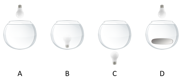

I tried a couple of approaches on how to achieve an effect similar to the one caused by the sun and  water surface interaction. As I wanted the pattern to be dynamic, I decided that I would need to use liquid to generate the pattern, so I used water. There are different ways light could be used to illuminate the water surface, Initially I thought about using a light over the surface (A), under the surface (B) and under the transparent recipient that holds the water (C). Ideally I wanted to illuminate the ceiling and the walls, so illumination would have to be under the water surface or under the transparent recipient. Keeping light under water requires water proofing, so I discarded it. To illuminate from the bottom of the recipient I would have to hang it or build a structure that could hold the recipient and leave space for the light, so I discarded those solutions as well. Finally I decided to illuminate from the top to a submerged mirror (D), this would also have the effect of increasing the caustic effect as light would have to cross two times the water surface.
2.2 Illumination
As explained before, without divergent (point source) or collimated light the caustics degrade considerably and their edges get blurry. In my first attempts I tried some high power small LEDs, but the results were mediocre. The closer the LED illuminated the water surface, the bigger the solid angle, and the less it acted as a point light source, leading to blurry caustics. Moving the LED farther from the liquid surface decreased the solid angle, but increased the light leak (light that does not hit the water surface). The alternative of course was to use lasers, as they are collimated. Initially I tried inexpensive 5 mW lasers and they produced very sharp edged caustics, but there were two drawbacks to this approach, light was very faint (as the lasers were low power), and the projected caustic was small, (as collimated light does not diverge). Finally I figured out that I needed more powerful lasers, so I removed some from DVD drives. These lasers could be used at 400 mW and without a collimator, they projected a divergent beam, making the projected caustic effect much bigger.

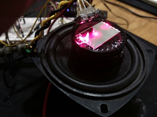

Caustics can be observed in swimming pools when water is agitated, usually by swimmers or the wind. If water stands still, caustics disappear and as my project would not have wind or swimmers to agitate the water I had to look for alternatives. I found that blowing the water surface with a fan would produce long wavelength waves, which would require me to build everything in a bigger scale. To keep everything small I decided to use a 12 W salvaged PC speaker and a small recipient which was placed over it. This also allowed me to tightly control the water motion by sending any kind of signal patterns to the speaker, which in turn allowed me to produce interesting effects like standing waves or pulsed water motion.

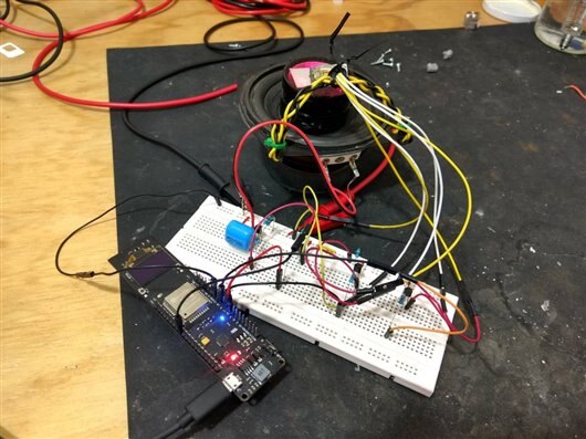

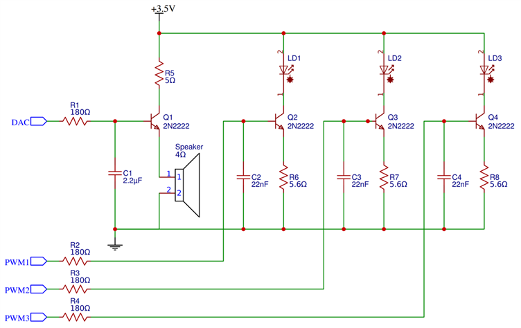

The circuit is pretty straightforward and very inefficient, but it was relatively fast to build with components I had at hand. The circuit was built for an ESP32 microcontroller, some advantages of this microcontroller are that it is very fast, can source or sink up to 40 mA, and has a very fast and customizable PWM which allowed me to set it to 5 khz and 13 bits of resolution. One not so great feature of the microcontroller is that its DAC has 8 bits of resolution and is relatively slow, still both constraints did not have any negative impact in the project.
Some notes on the circuit:
  • There is no decoupling between the DAC and the NPN base, this allowed me to generate signals up to sub-Hz frequencies. It also had the detrimental effect of reducing the effective DAC resolution as 0.7 V of the full 3.3 V swing could not be used because of the base-emitter voltage drop.
  • Even though the speaker is driven by DC and current flows all the time (unless the transistor is shut down), the speaker power rating is far higher than the power its dissipating.
  • Lasers are driven at around 400 mW with PWM signals at 5 khz.
  • The maximum power consumption is around  3 W

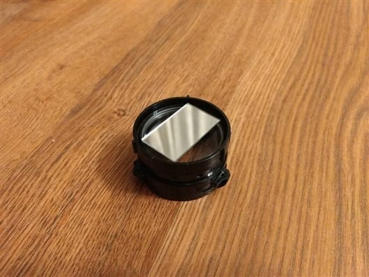

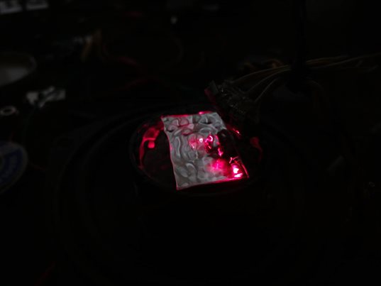

As the liquid recipient I used a small lens that I salvaged from a projector.  As it can be seen, it is very shallow, and this gave me greater flexibility at choosing the illumination angle. The mirror was also salvaged from a projector and glued to the recipient (lens) with hot glue.

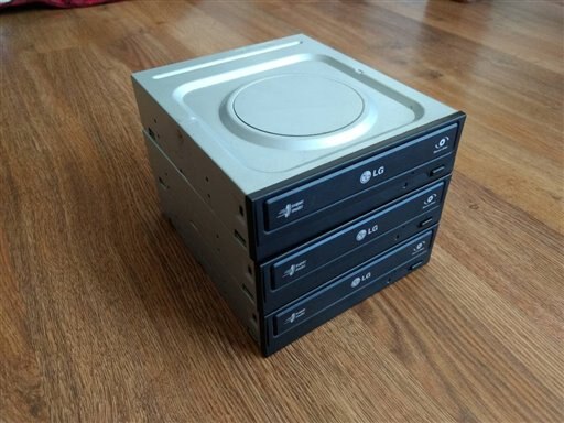

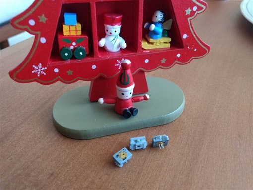

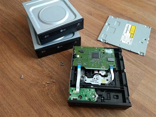

The 3 laser diodes were glued together with hot glue and fixed to the speaker through a PC power supply cable braid. As expected, this was far from the ideal solution, but I would not have finished the project in time if I spent more time in holding the lasers more firmly.

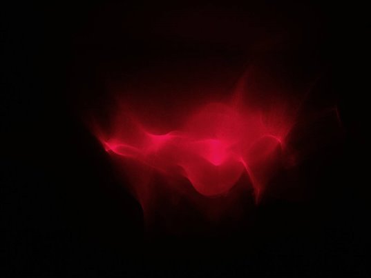

Standing waves occur as waves get reflected back and forth when they hit the recipient border. This effect occurs only at specific resonant frequencies and produces beautiful light patterns as it can be seen in the images and videos (which sadly don't look like the real thing). The small points that move around in the first video are floating dust particles. The second video shows how these floating particles move within the recipient.

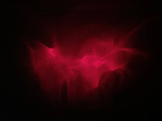

3.2 Chaotic stationary waves
When some conditions are met, the standing waves don't converge to a defined pattern, instead the pattern keeps changing in a chaotic way, producing at the same time higher spatial frequency patterns, as it can be seen in the image and video.

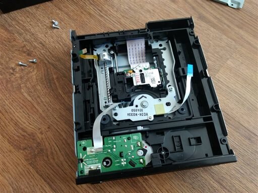

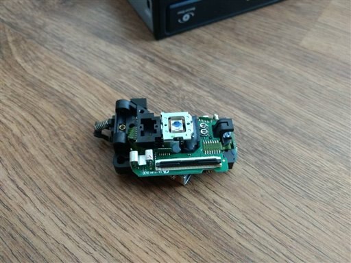

    Taking extra measures is never a bad idea. You could use the DVD lasers at much lower power, or stick with laser pointers. I initially used 5 mW pointers, and they looked nice, much brighter as the beam was collimated. If you want to try it, let me know, I can give you some tips on how to build something like this...

    Yes, DVDs come with an IR and a red laser, and protecting eyes when playing with lasers is always a good plan. In this case the 400 mW lasers are not that as dangerous as you may think because they are highly divergent (without a collimator). For instance if we assume a 5 mW laser pointer has a beam of 4 mm2, the 400 mW laser would drop its irradiance below that of the laser pointer whenever its surface gets >320 mm2, which is roughly a circle of a diameter of 20 mm, and this occurs at a pretty short distance from the lasers.
