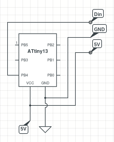

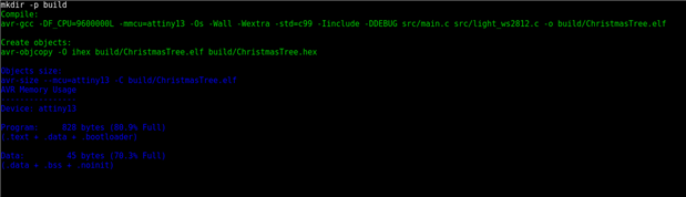

I would like to present a small Christmas tree made from 15 WS2812B LEDs connected to attiny13 MCU. Tree is made from 5 stripes with 5, 4, 3, 2 and 1 LEDs. LEDs are driven from single pinout PB4 of Attiny13 MCU. Below is schematic:

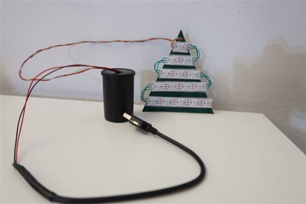

MCU was put in cartridge from 35mm tape. As power supply I have used 5V from USB. Code is written in C with usage of light_ws2812 library. Below there is output from compilation:

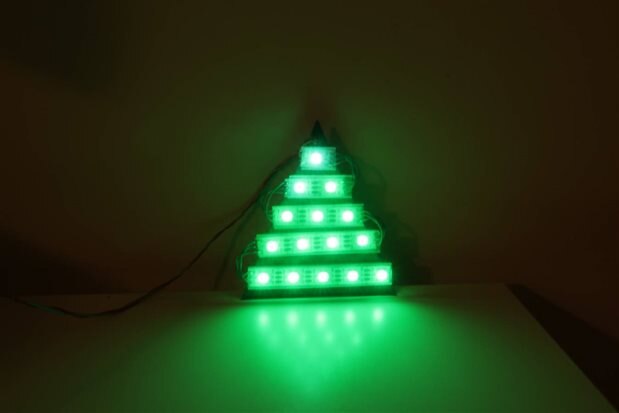

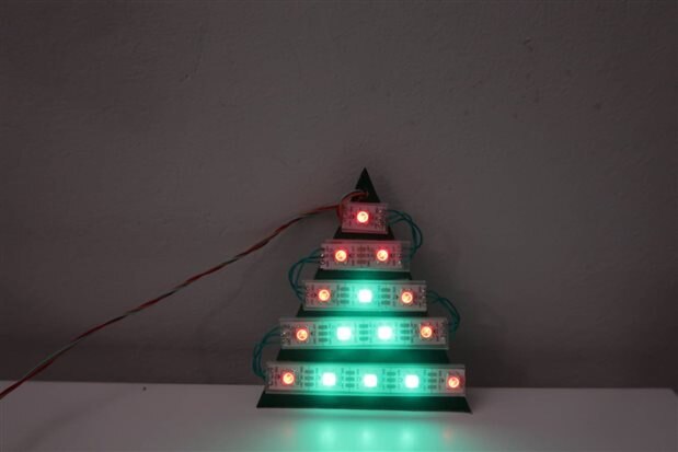

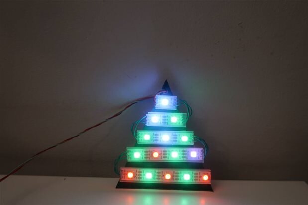

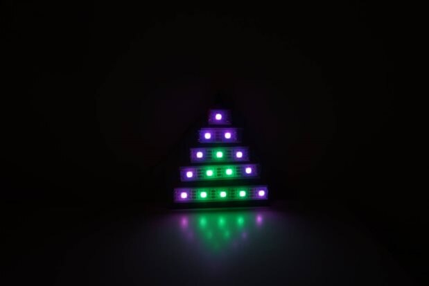

There are five different effects for which we could modify brightness and delay. Below are few more photos:
Source code is available in attachment. Below there is short video presentation:
Second video recorded with different camera setting:

    Hi,
    For programming I am using this USB programmer: https://www.fischl.de/usbasp/  and avrdude software. Example of command to program this MCU you could find in Makefile in attached sources.
    Here is example of connection:
    dubbie over 7 years ago
    What a brilliant LED Christmas tree. I'm not entirely sure what ws2812 LEDs are though.
    Also, how did you program your attiny13? I have purchased some atiny85 to use in my ideas but so far I have been unable to programme any. All the searches bring up UNOs (which I do not have - I have Nano V3 and so far I haven't found any information on how to use these to programme the attiny85). SparkFun do an actual programmer which I was going to buy one but they do not have any in stock.
