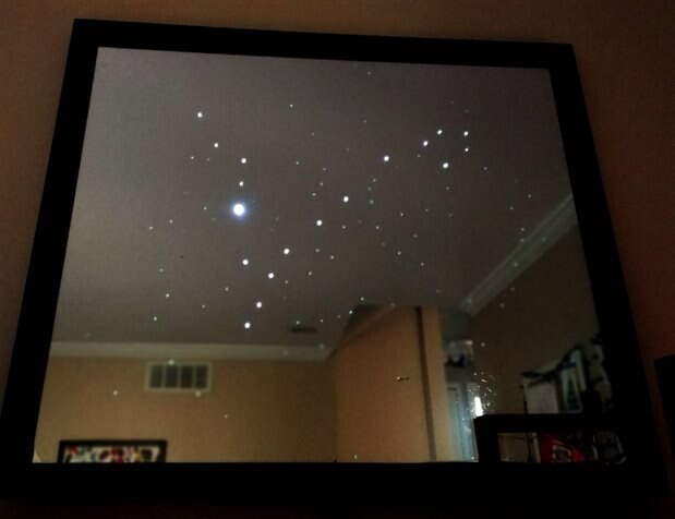

My eldest daughter loves all things space and is constantly looking skyward at night wondering what planet she can see.  One night I taught her about constellations and she became obsessed with Scorpio and I made this small little display stand for her using some scrap outdoor solar LEDs.
As with most of my projects the objective quickly escalated--could I build something that had all 12 zodiac signs...and Orion...and the Little Dipper...and Alexa...and EVERYTHING!
Thus, the Magic Star Mirror was born.
I had various needs and wants:
  1. I knew I wanted multiple constellations, but I didn't want them all lit up at once.
  2. I wanted to re-use LEDs whenever possible, to save on wiring
  3. I also wanted the stars colors and luminosity to be roughly true to life
  4. I needed to do this in a format that was acceptable to display in a living area and not just my workshop

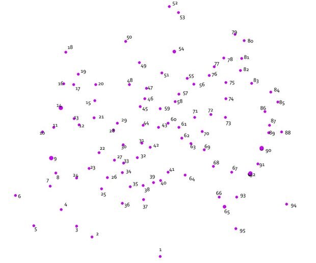

Step 1: Picking out the constellations
  1. Using Photoshop, I had layers made up of various constellations and did my best to overlap and re-use points as much as possible
In that jumbled mess are Aquarius, Aquila, Aries, Bootes, Cancer, Capricornus, Cassiopeia, Cancer, Corvus, Cygnus, Gemini, Leo, Libra, Orion, Pisces, Sagittarius, Scorpius, Taurus, Ursa Minor, Virgo
    2. Once I had all the constellations mapped out, I transferred this map over to luan plywood and drilled each hole and painted the star field black

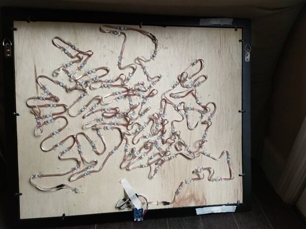

  1. I used a strand of generic WS2812b "neopixels" that came prewired to avoid having to solder each pixel individually.  I still had to do some soldering but not as much
  2. Each pixel was hot glued into place and the wires stapled down to secure them
  3. Powering the whole thing is a Wemos D1 Mini esp8266 board.  I went through several iterations of separate power supplies and supplemental power leads but in the end the most stable configuration was just powering it straight from the board.

  1. To make it look more finished, I used two-way mirror film on plexiglass within a frame to at least give the facsimile of a mirror.  The mirror film I obtained from AliExpress and it arrived slightly crinkled which made the mirror not quite perfect, but who cares when you have a party mode!

    Hi J, This is not only a very neat idea but a well executed project. Thank you for building it and sharing it with us. I bet your daughter thinks it is magic and will treasure it. John
    genebren over 7 years ago +2
    Welcome to the element14 community! What a great and thoughtful project that you have built for your daughter. The design is a combination of art and electronics and the results are magic. Well done! …

    shabaz over 7 years ago
    Awesome project! The dedication toward replicating the shapes of star constellations and their brightness level was really impressive!
    If you get a chance, it would be great to see a schematic or slightly more detailed photo showing which wires to connect where on the microcontroller board, because I think others will want to recreate this project too!
