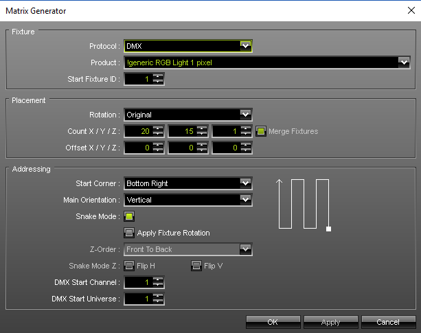

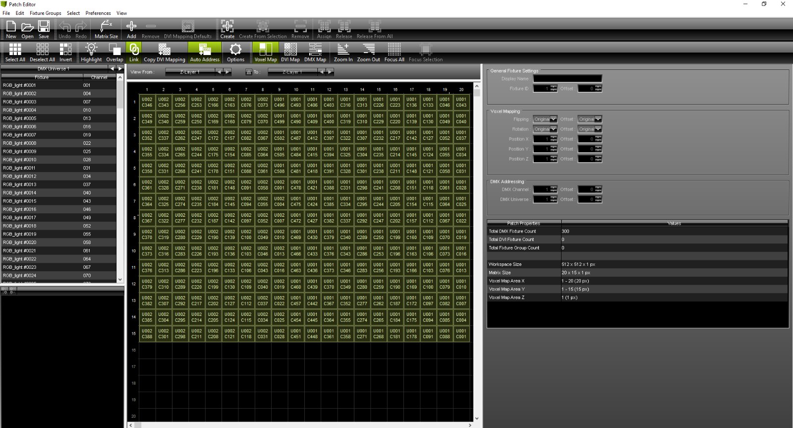

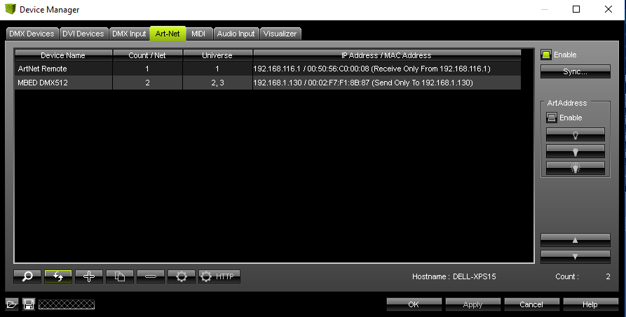

      • Madrix

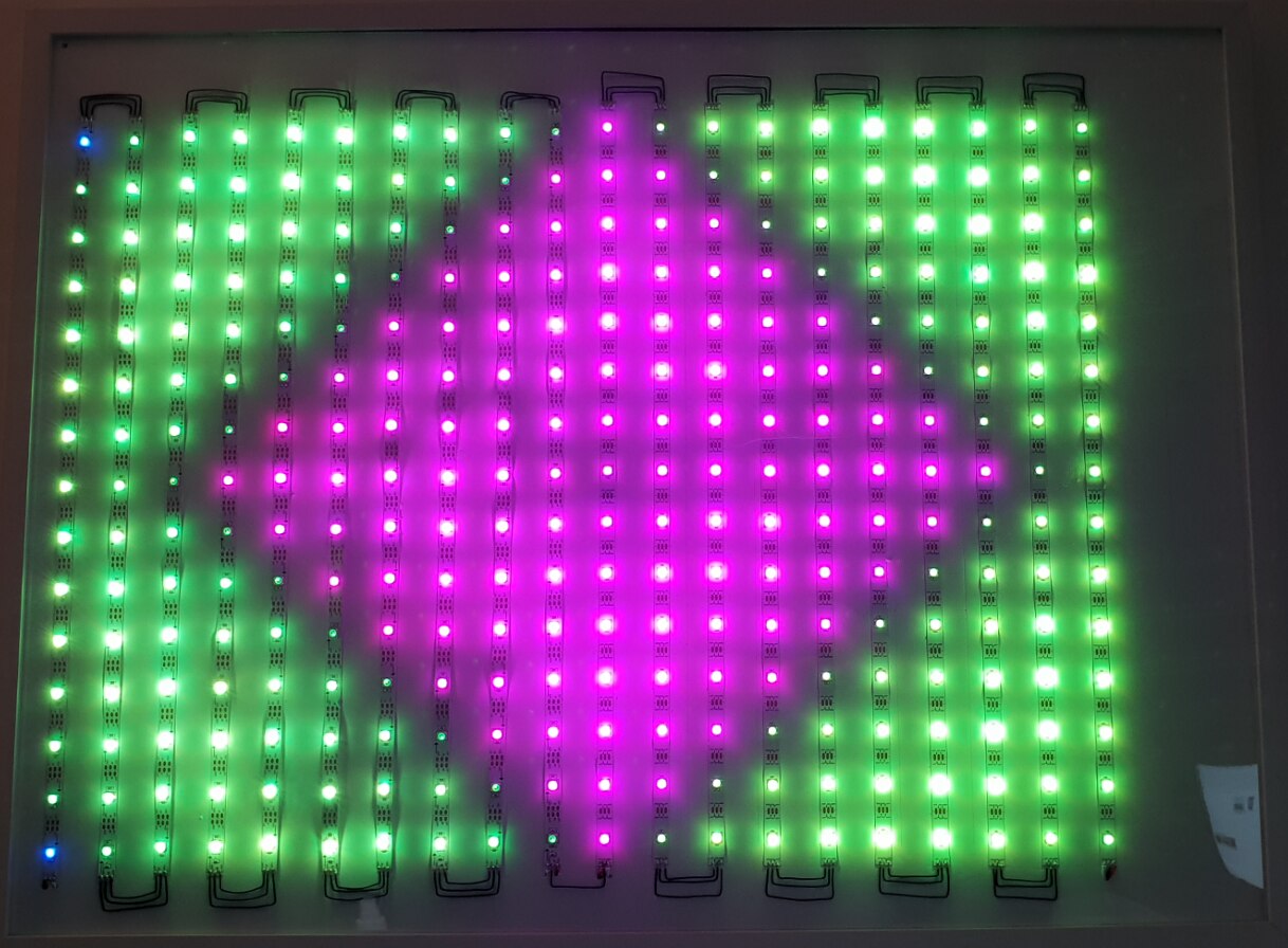

I have always been fascinated by LED displays and the effects that can be produced.  Over the last few years multi colour programmable LED's such as Neopixels, WS2812B LEDs etc seem to have become very popular and with the ever increasing amount of cheap development kits on the market it has become a lot more reachable for a hobbyist to create some pretty cool projects with LED's!  So I decided to build an LED matrix picture frame with an mbed LPC1768 board and 10m of WS2812B LED strip.  I have programmed the LPC1768 board to use Art-Net so that I can send data to the matrix from my laptop using Madrix or Glediator software.  Although this is not the most creative LED project, I am still pretty pleased with it!

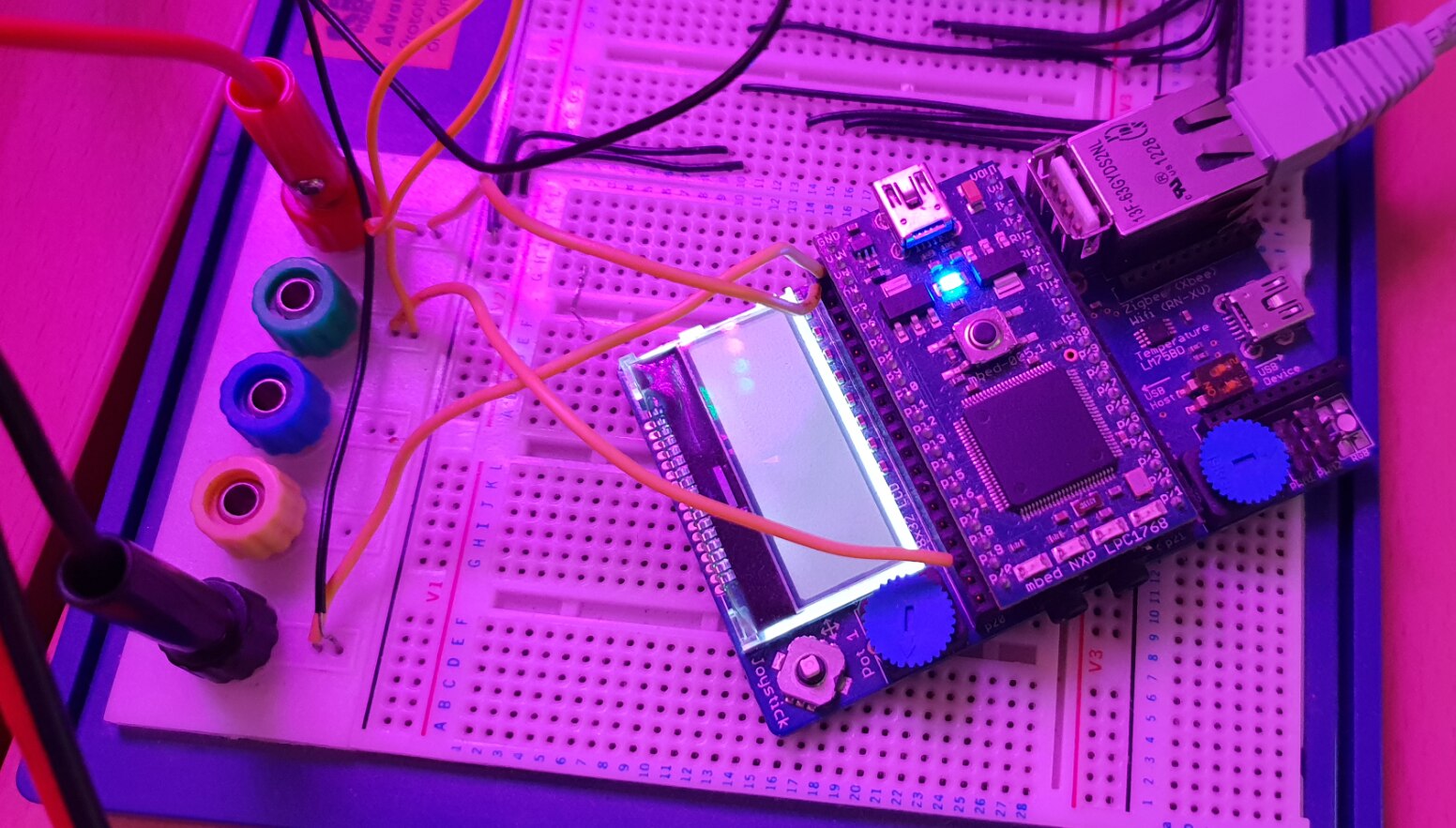

mbed LPC1768 control board

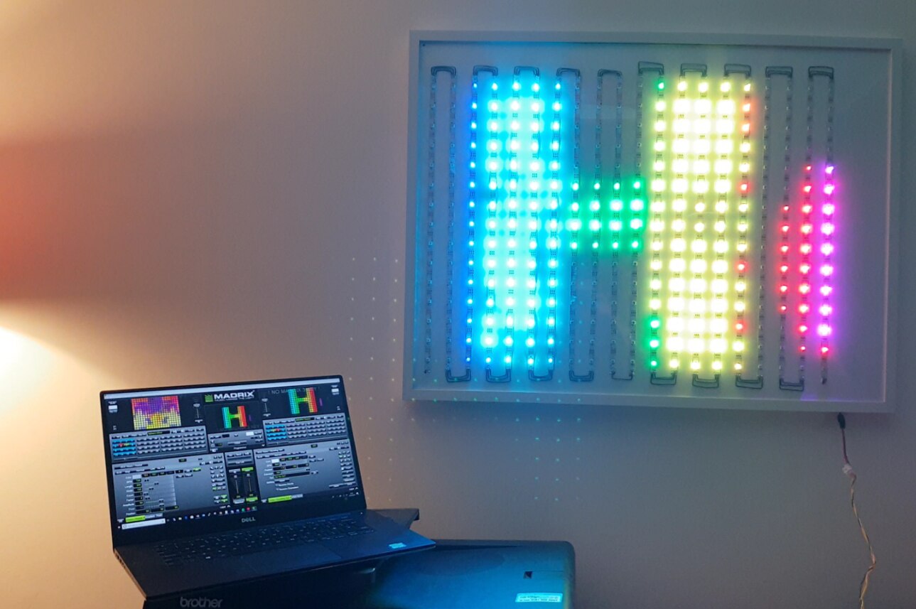

Full set up - note the laptop is only connected via WiFi

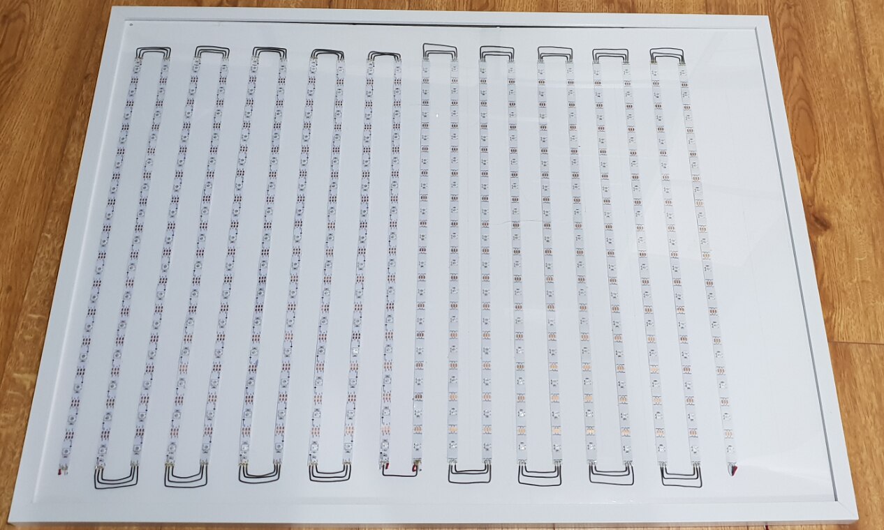

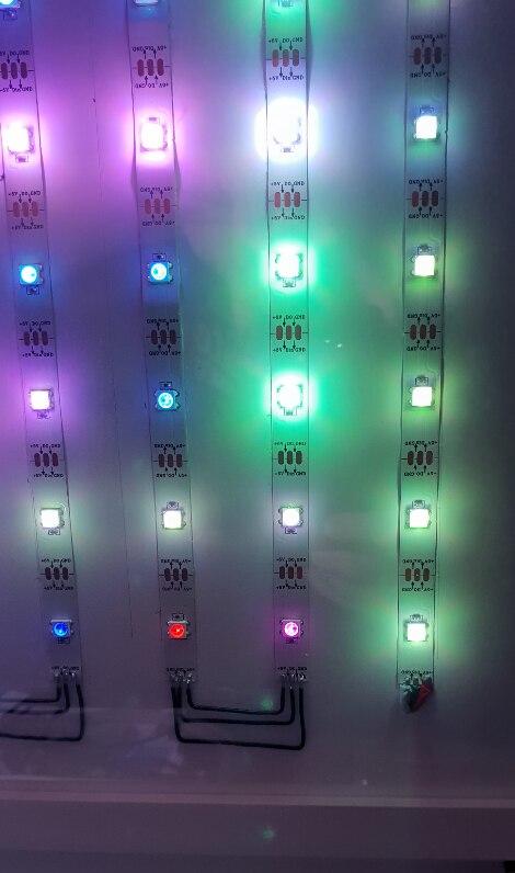

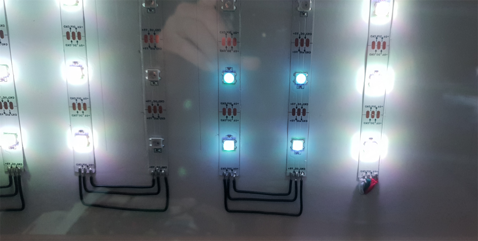

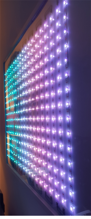

Construction for this project was pretty straight forward, although quite time consuming!........
  1. I cut the WS2812B LED strips into 20 lengths of 15 LEDs as this would fit nicely onto an A1 board and made a matrix of 20 x 15 LED's.
  2. I drew out and measured guide lines on the Foamex board so that I had a guide to stick the LEDs to.
  3. The fiddly part!......The LED's have a sticky back, so I peeled the protective tape and stuck the LED strip to the Foamex board.  This was a lot fiddlier than I expected as the strip is difficult to get to stick down in a straight line.

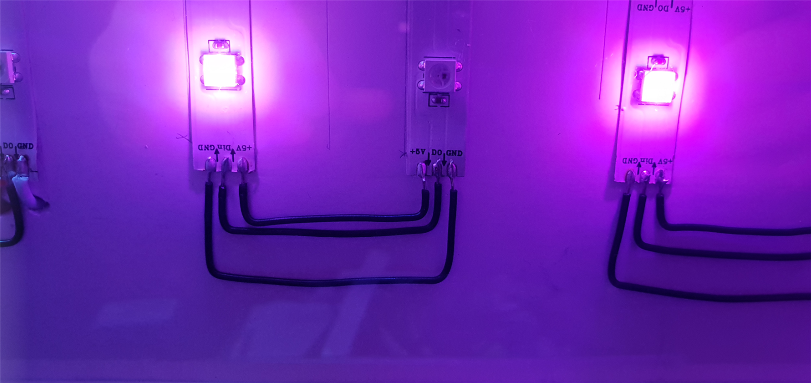

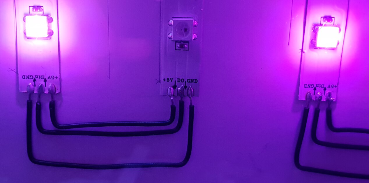

  4. The time consuming part!..... WS2812B LED's have a data in and data out pin on every LED allowing them to be daisy chained - to remake the daisy chain data and power connections on each individual strip, I soldered wires between the ends of each strip.  I also added two power connections with thicker wire at the half way point and end points.  This was to avoid a dimming effect you can get if you only connect power at one end of a long strip.  I would recommend 1 power connection feeds no more than 5m of strip.  The overall connection of the strips is in a snake like pattern.  My connections are not as neat as I would like, but I don't think it detracts from the overall project too much.  At the ends, I have drilled small holes through the Foamex board and pushed the wires through to the back.
    5. Then, I taped the wires down on the back of the board and routed them to the bottom right hand corner.
    6. Finally I mounted the A1 Foamex board inside the frame, assembled it and then connected the power and data connections to the mbed application board and bench top PSU.

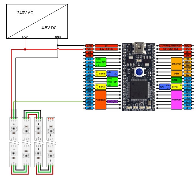

Connections
Connections
Connecting up to WS2812B LEDs is pretty straight forward.  I have a pretty basic bench PSU with only a selection of voltages (A descent bench top PSU is definitely on my future shopping list!) For this project I am using 4.5V as this allows me to feed power to the mbed board and WS2812B LEDs whilst also allowing me to connect the 3.3V data signal from the mbed board to the LEDs without needing a level shifter - as the data pin voltage should be no less than 70% of the supply voltage to the LEDs.  I could get away with up to about 4.7V.  This is not really good practice, but I can get away with it on this.
The only other connection then, is the data pin - for this I have used pin 18 of the board which is connected to one end of the strip.  It is important that this is connected to the input end of the strip which is marked with an arrow.

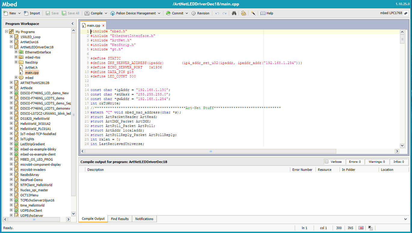

Main MCU Program
As I am using the mbed LPC1768 (which is a great little board!) I have utilised the online mbed IDE which is part of the arm mbed system.  The programming language used is C++.
Here is how the mbed complier looks:
The libraries that are available for mbed enabled devices are fantastic - the level of abstraction makes it very easy for a novice programmer to get going easily.  There is a very well documented API on the mbed website.  As an example, to toggle an on board LED, you just need the following code:

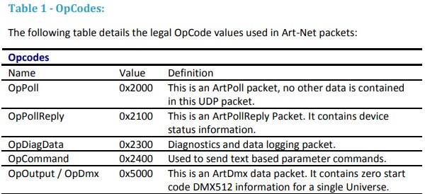

  • This is a packet of data that is sent by the controller - in my case, my laptop and then the node responds with a reply with some basic information.  It is effectively used for the controller (software on my PC in my case) to discover devices.
  • There area a number of OpCodes defined in the specification that define the message type - for my project, I am just using OpPoll (0x2000), OpPollReply (0x2100) and OpOutput / OpDMX (ox5000)
The program on my PC will initially send an OpPoll message with the OpCode 0x2000 and then my mbed device will respond with an OpPollReply message with the OpCode 0x2100.
These two packet types used are defined as structs in the ArtNet.h header file:

#define ArtMaxUniv 4 // Universe
#define SizeRecvBuffer 700
#define ArtHeaderID "Art-Net" // packet header
#define ArtUDPPort 0x1936 // UDP port 6454 for Art-Net
#define ArtVersion 14    // Art-Net version
#define OP_Output 0x5000 //Art-Net DMX Packet 'Output'
#define OP_Poll 0x2000 // ArtPoll
#define OP_PollReply 0x2100 // ArtPoll Reply
#define StyleNode 0
#define StyleServer 1
#define STR_LongName "Art-Net to WS2812B - By Tony Beck"
#define STR_ShortName "MBED ArtNet LED"

The IP settings are assigned to some const arrays at the start of my code:
const char *ipAddr = "192.168.1.130";
const char *snMask = "255.255.255.0";
const char *gwAddr = "192.168.1.254";
The code to initialise the Ethernet Stack is:
  EthernetInterface eth;
#ifdef STATIC
    eth.init(ipAddr,snMask,gwAddr); //Use DHCP
#else
    eth.init();
#endif
    eth.connect();
    printf("\r\nIP Address is %s\r\n", eth.getIPAddress());
Note, I have left code in place to use DHCP if I did not define STATIC.

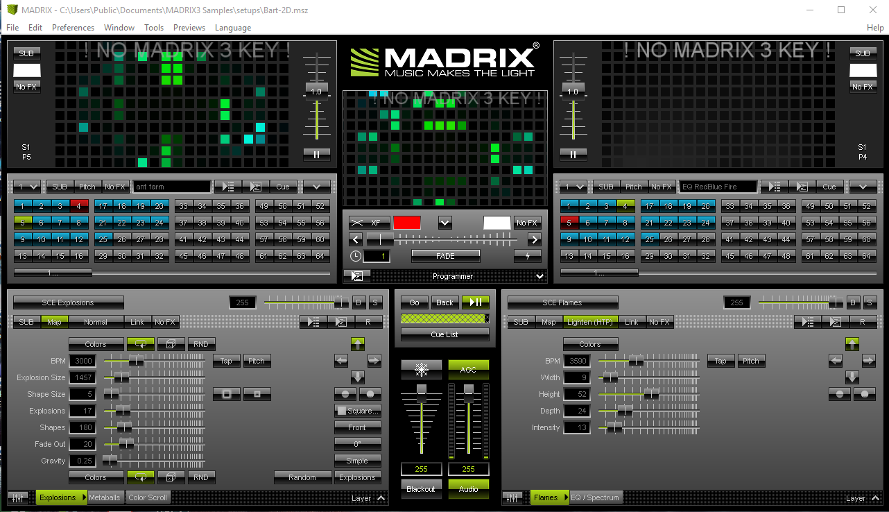

Madrix is a full professoinal grade LED lighting control software made for the industry and has a price tag to match!  It is very powerful and can produce some awesome displays......some of which I can only wish to work on!
Madrix
Thankfully for me, you can run Madrix in demo mode which has a few limitations.  One of the main limitations is that the output will go off for a short time at random intervals.  It will also stop its output after about 20 minutes. You then have to restart it.
I have used version 3.6 as the newer version 5 does not give any Art-Net output at all in Demo mode. Here is the download link.
{gallery} Madrix

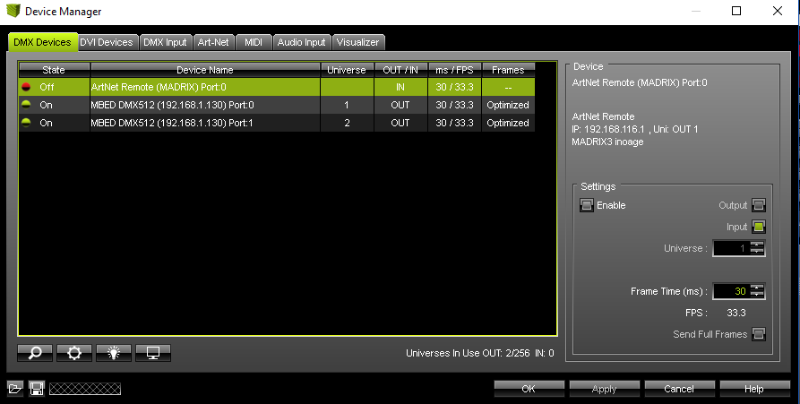

Here is the GUI that you are presented with
To set up initially, you need to set up the matrix dimensions and the actual device.  You then have to patch all each pixel to an address
This is the display to set up the mbed module as an Art-Net device

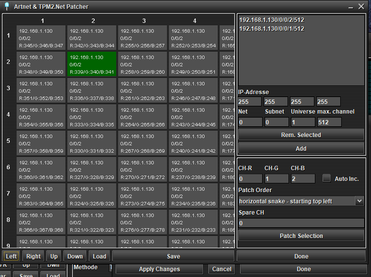

This is the view of the patch editor
This is the tool to automatically assign each channel according to how the strips are wired

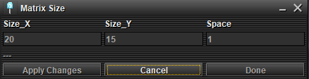

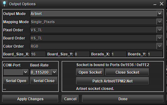

Glediator
Glediator has been written by a couple of guys to control LED matrix and strips.  The link to their website - solderlab.de is here.  As I mentioned above it is free to download and use.  It is not as advanced as Madrix but, it is still pretty cool and can make some great effects!
As it does not have as many features, it is easier to use!  The only tricky part was the initial set up.
{gallery} Glediator
The first part is to set the matrix size
Then set up some basic settings for the output
and finally patch the LEDs to their corresponding address
