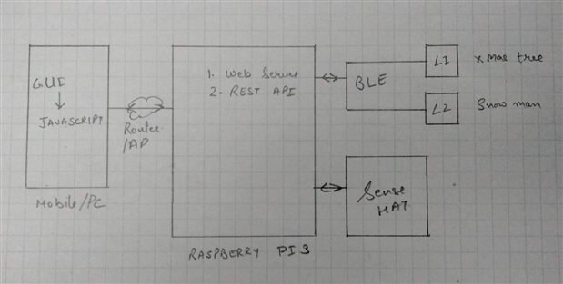

Here is a basic block diagram of the plan.
Working
The Raspberry Pi 3 runs a Python Flask Server that does two things.
1. It serves up html/css/js files that are requested by a web browser. The loaded page contains a GUI with coloraturas pickers as well as action buttons. The page is also loaded with a javascript element that allows coloraturas picker data to be sent via simple REST like call to the python server.
2. The Flask server also exposes a REST like API that allows a client to select a light and send it coloraturas data
Once the web page is loaded, the user can use a coloraturas picker for a particular light. Once the user make a selection, a REST call is trigged and the RGB data is sent to the Flask server. This is translated from text to hex values and passed onto the Bluetooth LE module.
The Bluetooth LE module is also written in python and allows for the scanning and then communication with BLE lights. The UUIDs are made part of the module and hence once the RGB values are passed to it, it scans for BLE light presence. If found, it then updates the BLE light's characteristics thereby changing the light.
There are a number of components to this and the code is flexible enough to allow future expansion. I also added an animation function that sends varying RGB data to the lights making them change colour in sync with each other.

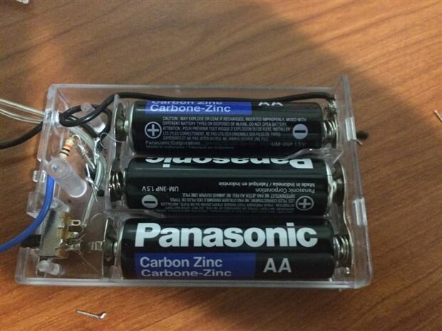

One of the Microbits have the pins broken out and I used 2N3904 NPN Transistors as switched to turn ON and OFF two things. First was an LED strip which was procured at the dollar store and the LEDs change colour due to their internal circuitry.
Second, is a small house with a music chip that plays the Christmas carols which was perfect. After hacking it open, I connected the transistor and resistor directly to the contact.
The code sends commands to toggle the GPIOs ON and OFF and the state is saved within the remote itself.

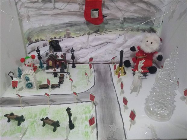

Water colours can and will bring out the child in everyone and my better half was more than happy to create a model. Cotton for snow and just paint and crayons made this project a family effort. After all its all about bringing everyone together. image
Some Christmas toothpicks and ornaments later, we had a small village with Santa Clause, reindeers and a cottage. My son added his collection of Paw Patrol pups and I added a Lego Anakin Skywalker with R2D2. Everyone had a lot of fun
