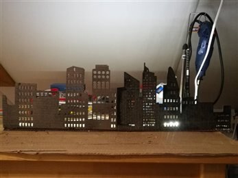

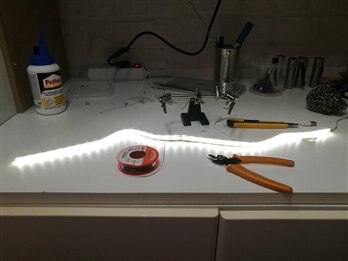

The City Skyline
The hardware parts have been assembled and tested separately with small programs before starting the assembly of the box. The images below show the white LED strips and the testing effect when placed behind the city skyline. The power supplied to the robot controller - the main power line - is 6.5V 2.5A The two LED strips are originally provided with a USB port to be powered by a max 5V by a power charger or a laptop USB port; to avoid overvoltage I connected two strips together creating a 60 cm LED array.

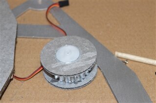

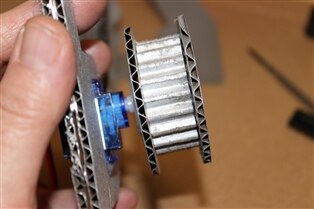

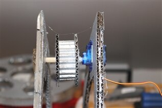

The Big Rotating Gear

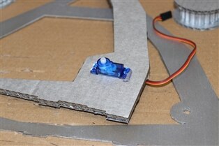

The big rotating gear is the main cardboard engine activated by a smaller gear to the base connected to a continuously rotating servo. The all-in-one robot controller can drive up to eight servos independently; I used five with great result: all of them worked as expected. The images below show the servo connected to the driving gear.
The video below shows the servo bench testing.

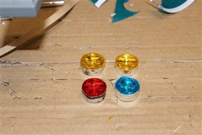

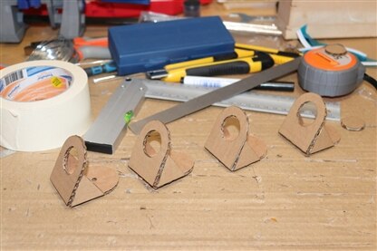

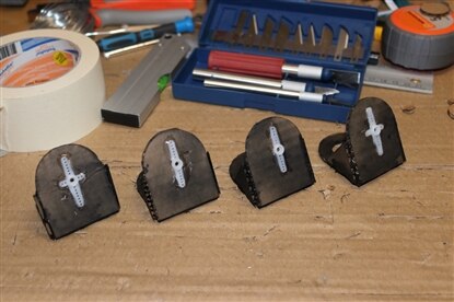

Coloured Flashlights
To make the colored flashlights I have used four cheap high brightness portable flashlights like the one shown in the photo after the complete disassembled.
Like the case of the white LED strips these lamps operate with three 1.5V AAA batteries so I connected a couple of them in series to avoid overvoltage. Also, the light reflecting support has been hacked to make it colored. To create the front screen of the lights I have used the top side of four of my preferred transparent sunshade caps.
Every light has been glued in a support connected to a microservo to create the rotation
Video showing the light mechanism under the bench test.

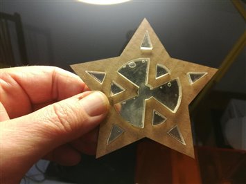

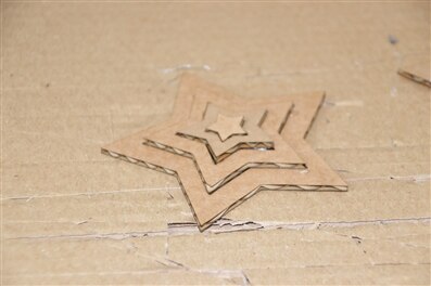

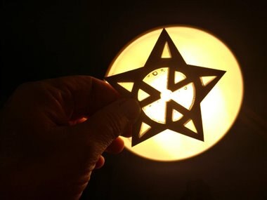

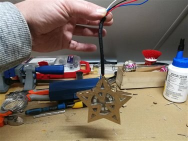

The Glowing Star
The glowing star is a double cardboard star with the fronm side partially open - making a design - with transparent 3D printed plastic cover. The internal part of the star has a 12 NeoPixel LEDs.
Note that the star uses the micro:bit PIn 16 of the GPIO. Together with the electret microphone is the only device directly connected to the board pinout while all the other parts are managed by the all-in-one robotic board.

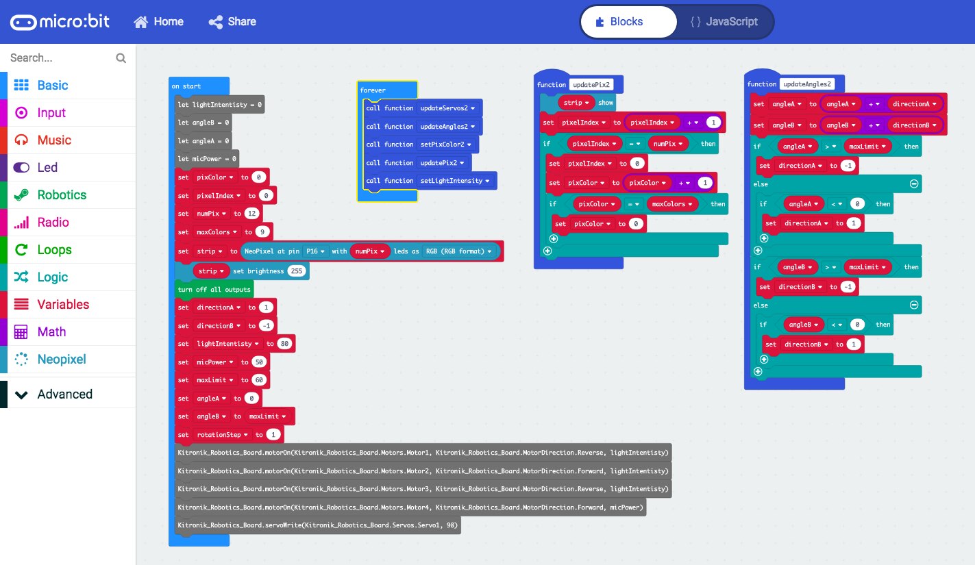

I wrote the software in Javascript, to make it easy to be used (fully or partially) also with the visual editor Blocks (that is a different javascript representation). About the software, some important notes.
BBC micro:bit Firmware Update
As far as I know, the micro:bit internal libraries managing the I2C and SPI protocols has serious bugs. Someone has no difficulty to use them while in other cases (like me) it seems impossible to work correctly. The Kitronik's all-in-one robotic board communicate with the micro:bit through the I2C protocol; I had serious issues on the first run then I checked the firmware version of my board and it was 2.30 while the last update from the microbit.org site is the version 2.50. Everything worked fine after the firmware update.
To update the firmware of the micro:bit follow the instruction on the microbit.org specific link: https://microbit.org/guide/firmware/
Libraries and Sources
The last updated version of the javascript sources is available under a CC 3.0 NC-ND-SA license on GitHub under the Java folder
If you just copy and paste the java sources in the online micro:bit editor does not work. Don't forget to download the libraries from the Extensions option in the blocks online editor. you should install the Kitronik Robotic Library and the Adafruit Neopixel Library.
