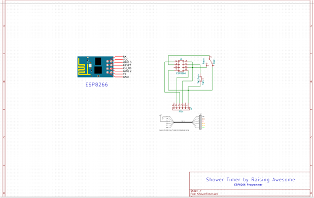

Step 1:  Build a flash device (programmer) for the ESP8266
Our model of the ESP8266 did not have built in programming hardware.  To program it we need an FTDI cable.  Also, when you flash the program to the ESP8266, you have to pull GPIO0 to ground.  To aid in this, we designed a programming circuit using the software KiCAD.  You can view a step-by-step tutorial here:
Here is the schematic for our ESP8266 programmer:
Step 2:  Build the ESP8266 Programmer Board
Having made the board in KiCAD, we could have sent it off to a fab shop such as OSHPARK.com.  However, we were eager to get the project going, so we did it by hand.

Step 5:  We then needed a circuit board to mount the ESP8266, the power connection, and the temperature probe.  This was done just like the programmer board in step 2.  Here is our resulting schematic that would be compatible to a 9V or 5V wall wart.
