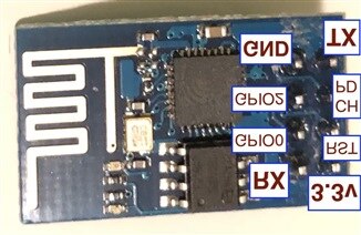

Here is a picture of my ESP-01. I've labelled the pins for future reference.

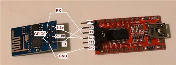

The trickiest part of programming the ESP-01 are the physical connections required to hook it up to the Arduino IDE. And even though I saw several examples online, those specific examples didn't seem to work for me.
I ultimately did find some useful diagrams and instructions out there, and with some trial and error and some extra figuring, I finally found a way to connect and program my ESP-01, using a USB-Serial adapter set to 3.3v, and a mess of wires.
The connections I used to program the ESP-01 are as follows:
USB.Serial Adapter  -  ESP-01
RX - TX
VCC - CH-PD
(ESP-01 RST not connected)
VCC - +3.3v
GND - GND
(ESP-01 GPIO2 not connected)
GND - GPIO0  (sets programming mode)
TX-RX
After flashing, I added the LED to GPIO2. Apparently it can confuse things if it's on while flashing the update.
Here is a marked up picture to show the connections I used, partly for my own reference later on, but also I hope it will be helpful to anyone reading this post.

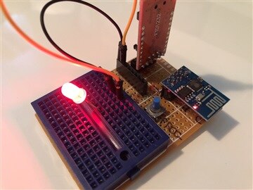

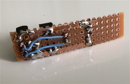

The wiring got a bit complicated, so I decided to solder up the connections onto a perf board to make it easier to disconnect and reconnect it multiple times to facilitate testing.
However, for the first iteration I got things completely backwards - basically I assembled it into mirror image.

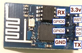

One of the reasons I found it a bit hard to keep it all straight in my mind is that the pins on the ESP-01 are on the bottom of the board, and most online example pictures only had the pins marked looking down at the top of the board.
It helped me a little bit to just take a picture of the ESP-01 with marked connections, and then mirror it in software, and work from there, so it matched the underside of the board. I'm not sure if anyone else would find this helpful, or if my brain just works in strange ways sometimes!
Thankfully the second iteration of the perf-board programmer worked perfectly. I also added a switch on the gpio0-gnd connection, to put the board into programming mode at startup, while still allowing it to start into run mode for testing. That works very well, but I really should have added a reset switch as well, as power cycling for each try is a pain.

Blink, Or it Doesn't Count
So now that I finally had the ESP-01 connected up to my Arduino IDE, I was able to make it blink!
As the ESP-01 is very minimal, I had to add my own LED. This board is also very limited for IO, and the only really available GPIO is pin 2. Other pins are useable too, but it can take a fair bit more effort to get them working. This is fine for the purpose I have in mind, but anything requiring more GPIO will benefit from other (and still very low priced) similar ESP8266 board that already have the extra pins connected out.

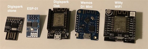

For those projects requiring extra IO, check out the Witty or WeMos (at about $4 or $5), the Sonoff (about $7), or Adafruit has a Huzzah for a little bit more. I've since ordered one of each of those to give them a try as well. So far I have received the Witty and the Wemos and they are worth the extra $2 just for the plug-and-play programmability and the fact that the 3.3v regulation is handled on the board so that it can be powered simply with a USB phone charger. I was a little disappointed when I later received my Huzzah, as it doesn't have that handy micro-USB power/programming connection.
Here is a picture that compares the sizes. I added a Digispark clone for comparison. The Huzzah arrived later, and is about the same size as the Oak.

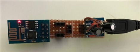

Standalone Operation
To actually use the ESP-01 in the field as a remote sensor, I needed to figure out a way to power it up independently. And it would of course need some sort of project case to protect it from rain.
As the ESP-01 runs on 3.3v, I couldn't just use a handy-dandy USB charger like so many other dev boards these days use. So I had to do a little bit of circuit building and soldering. Just enough to keep my skills from getting too rusty and dusty.

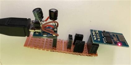

The cool thing is I still had a handful of little micro-USB breakout boards, and I had some AMS1117 3.3v voltage regulators handy. I don't even recall why I bought any of those, but I must have had a good reason for that and it sure came in handy for this project! And by "it" I mean my hoarding tendencies image
It actually turned out quite well, and tiny, although it also wasn't without some trial and error and effort. You won't believe how long it took me to figure out that what should have been one of the easiest solder connections was not properly connected. I think it was the VCC one from the regulator out. I blamed everything else before I figured that out! Sigh.
I then decided it would make sense to build a new little breakout board to allow me to easily connect a few things, including the power, to the ESP-01.
This worked out quite well, and the connections are actually quite basic. The ESP-01 plugs into one side, the 3.3v USB power adapter plugs into the other side, and the headers in the middle provide power and gnd (top and bottom) and access to GPIO2 and GPIO0 (middle).
To help make the connections easier I tried using copper tape in a pcb-style way. This helped a little bit for connecting VCC and GND, but I did still need a few wires to bring it all together.

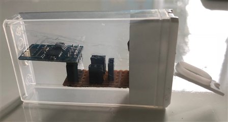

Keeping Things Dry

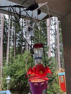

The next step is to put the sensor where I want to take the measurements. So I need to make sure it stays safe and dry.
I wasn't super happy with the look of my breakout board, even though it worked well enough, so I decided it was time to hide it inside of some case that would also keep things safe from rain.
As it turns out, I found a tic-tac case that fit the whole setup perfectly. It's clear though, so this also meant embracing the ruggedness of my messy perf board. On the bright side though, it does show off the nerdy side of the sensor and gives visibility of the little blinky lights (the ESP-01 does have power and tx/rx LEDs, very pretty at night). And, as I later learned, it was nice to see through the case to notice loose connections later, heh.

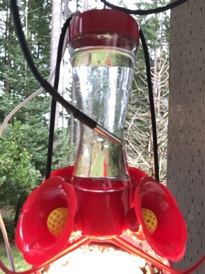

Well, not completely exactly what I came for - I originally wanted to keep an eye on my pond water level, but two things made me go a different route: 1, it's winter and the rain keeps the pond topped up continuously; and 2, I have a temperature sensor already hooked up and giving nice variable data for testing.

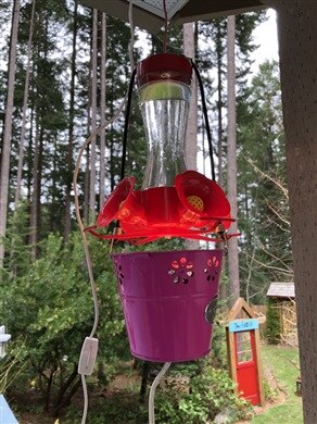

So another application came to mind: my hummingbird feeder!
We have hummingbirds that overwinter here, so they depend on the feeders being available through the winter. The problem is that when the weather gets really cold the feeders can freeze up.
One solution locals often use is to hang a light bulb underneath it. I started out with some very big and ugly tin cans with highish wattage light bulbs under them, but refined it to use a smaller neater setup later, with a smaller lightbulb like the ones used in salt lamps.
I wanted to see how well this smaller light method works to keep my hummingbird feeder from freezing.
I already had an extension cord close to the hummingbird feeder for that lightbulb, so I simply plugged a small cube-style phone charger in, and plugged in my standalone ESP-01.
I then placed the temperature sensor up against the glass, and covered it with a little bit of insulation, all held in place with an elastic band. The reason for the insulation is that I want the water/glass temperature and not the outside temperature.

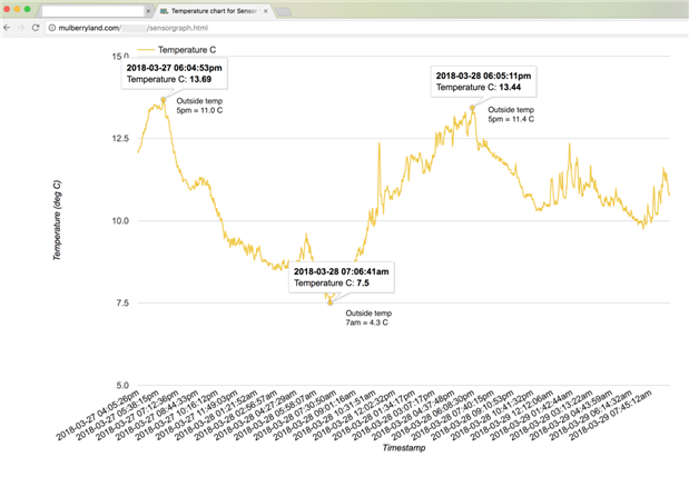

This worked wonderfully!
Check out the resulting graph. I added notes to indicate what the outdoor temperature was (based on Environment Canada data).
The good news is that the light bulb does keep the feeder about 3 degrees above the outside temperature, which is usually enough to keep the feeder from freezing. This was for a 15 watt light bulb, so I could always upgrade to a 25 watt bulb if needed, and maybe insulate the bottle when things get really cold.
