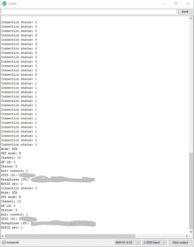

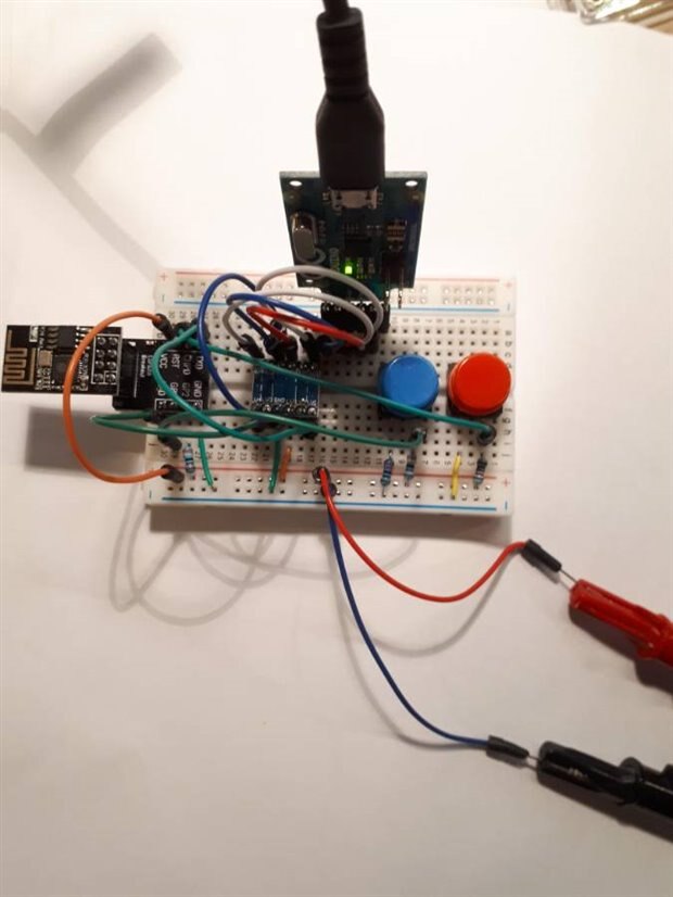

    Status update:
    I have finally gotten my ESP-01 to connect to an access point (AP) - even one that is hidden! There were a LOT of things that need to be learned and corrected along the way for me, and i will try to document as much as i can here.
    It appears that uploading sketches to the device you loose the ability to communicate with it with AT commands. The first thing it appears that should be done with these devices is to make a connection to an AP and possibly update the firmware. I do not understand how this works, but i have read many places indications that this could be an issue.
    Now for the things that i believe that i understand to some degree:

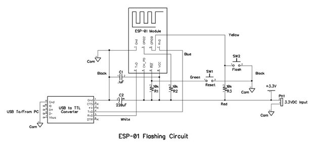

    Here is what i would call a generic diagram for an ESP-01 flashing circuit:
    Notes about the flashing circuit:
    • It is VERY important to use a 3.3V power supply capable of supplying enough current. I do not know how much current is recommended, but i have read a number of places that neither the 3.3V output from an Arduino nor the 3.3V output from the MB102 breadboard power supply module are reliable for this purpose - so be warned! (I used a lab bench power supply capable of delivering 3A - overkill, i am sure, but there were so many problems to be overcome that i wanted to be 100% sure that this was not the source of my problems).
    • I have also observed that a number of people have reported having problems using 10k resistors where indicated in the diagram. Their problems appeared to be resolved by using 3.3k resistors instead. (I did not have 3.3k resistors, so i used the 3.9k resistors that were available to me.)
    • I did not use capacitors C1 and C2.
    • The USB to TTL converter in the diagram is assumed to be using 3.3V levels on the ESP-01 side. I used an Arduino USB 2 Serial which uses 5V levels with a 3.3V to 5V bi-directonal level shifter circuit as my USB to TTL Converter.

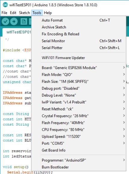

    • I used the Arduino IDE to upload sketches
    • To upload sketches successfully i had to press and hold the Reset switch, then press and hold the Flash switch, then release the Reset switch, but keep holding the Flash switch depressed until the sketch was done uploading. If problems occurred it was usually sufficient to turn off power to the ESP-01, disconnect the USB cable from the pc, close the Arduino IDE (and Serial window), and reconnect and restart the IDE.
    • Here is a picture of the Arduino settings that i found to work for me:
              NOTE:
    1. My ESP-01 has 1MB (black pcb, blue pcb usually => 512KB)
    2. Crystal Frequency choice WILL affect which "baud" setting you will have to use in order to be able to read output to Serial - and will probably prevent the unit from finding and connecting to access points!!!!
    • If you use an Arduino Uno you will have to connect the Rx from the ESP-01 to the Rx of the UNO (and Tx to Tx as well).

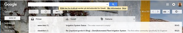

    And here is the code i uploaded to the ESP-01 to test everything:
    #include
    const char* MY_SSID = "*********"; // use your SSID here
    const char* PASSWORD = "**********"; // use your password here
    IPAddress staticIP(192, 168, 1, 32); // static ip address for the ESP-01
    IPAddress gateway(192, 168, 1, 1);
    IPAddress subnet(255, 255, 255, 0);
    const String HOST = "192.168.1.30"; // static ip address of my raspi server
    const int HTTP_PORT = 80;
    const String URL = "/fillReservoir.php"; // my script to send email informing reservoir empty
    const int RESERVOIR = 0; // use GP0 as input to signal ESP-01 reservoir empty

    Serial output:
    E-mail received:
    And this is how the breadboard looks:
    Hooray! Congrats! Excellent news image
    My flashing circuit is pretty much the same as yours, except I left GPIO2 disconnected and I don't have reset hooked up (I need to hook that up... major pain the way it is!).
    I have a 3.3v USB-Serial adapter so I just use the power supply from it as VCC. Seems to work well.
    >I did not use the capacitors in the circuit above (my circuit was equivalent to shorting out them).
    I think those are supposed to make it more stable, but I left them out too. Seems to be fine without it. Did you mean you left those disconnected rather than shorted? (otherwise gnd-vcc would not be happy-making)

    You are absolutely right regarding the capacitors Nico, i left them out. I am so tired now that i am not thinking properly. It is past midnight now in Eiksmarka and i have not been sleeping much lately. I will correct that right now.
