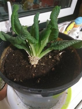

I have a plant in my room and sometimes I can't look after it because I am away. I don't want to implement automated watering system because I want to look after the plant that is the whole point. It is a hobby I enjoy and I want to have a bond with it. It is important to water it properly hence it can die without water and also with excess water. Therefore, I will build a watering system which will somehow show the plants status and water it when I am absent. If I have enough time, it can even send me photos or tweets image
These are her photo more than a month ago and now but unfortunately, she is not very healthy now image Flowers are dried before they blossom but leaves are still green. Therefore, there is a hope that it will blossom in the next season. Until that, I want to make sure it is watered properly.

    she is not very healthy now Flowers are dried before they blossom but leaves are still green. I'm not a gardener, but the leaves appear to also be showing signs of dehydration despite the green colour…

    I didn't know the pinching off dead flower will prolong but interestingly I was doing that intuitively.  I know it will stop flowering at some point but the problem was I can see dried buds which shows me something wrong. I used a fertiliser and I think she doesn't like it and that causes some problem too. I gave up using fertiliser for now.
    Currently, new leaves are coming image  I take it is a good sign and maybe I can get flowers next spring.
