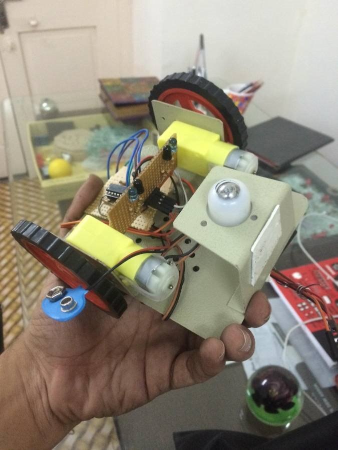

FORMING A CHASSIS
After connecting the motor driver and motors, we need to put everything together along with a chassis, wheels and our sensor board. I have made a simple chassis, but you can create something more elaborate and used different parts according to preference. The sky is the limit. Add batteries and we are good. WRITE THE PROGRAM
We will continue using touch develop to make the program and i order to make the decision to turn right or left or move straight, we will add an IF-THEN-ELSE ladder within the loop we created the last time. The program can be downloaded as a file using the link provided at the bottom of this page. Compile the code and upload the hex file to the BBC Micro:bit. CREATE A TRACK AND TEST
In order to follow a line, we need a line for which we use some black water colours and a white paper sheet. Draw a simple circle initially to test out the functionality. Make sure that the line is not too thick else the sensor will have problems detecting turns and will get stuck easily. We just need the line to thick enough that it is detected by each of the sensors individually. Test her out.

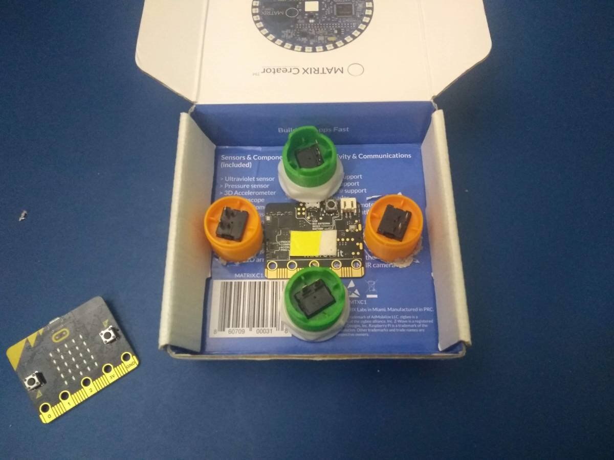

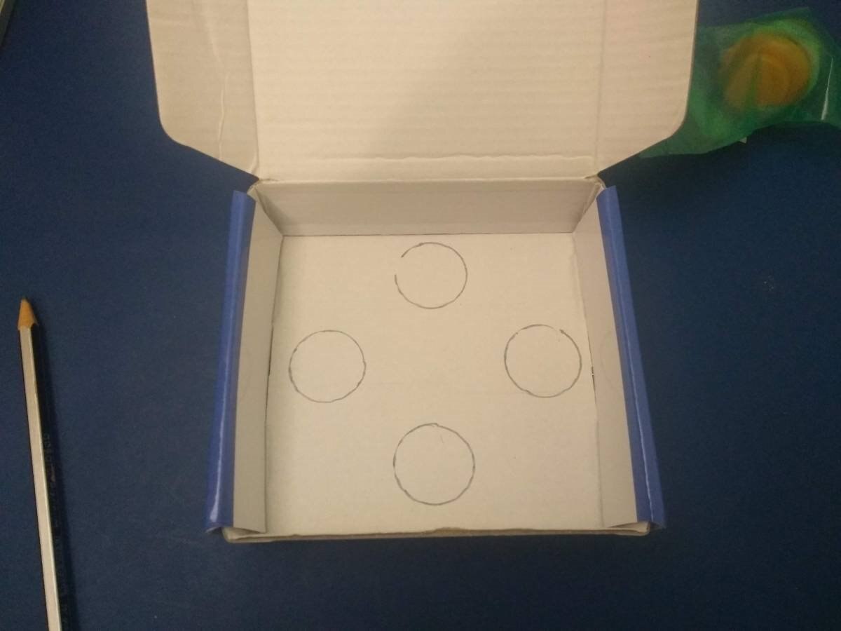

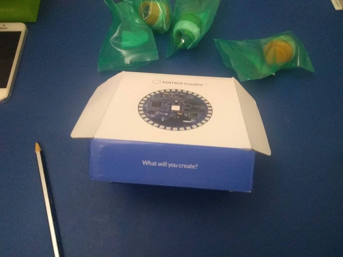

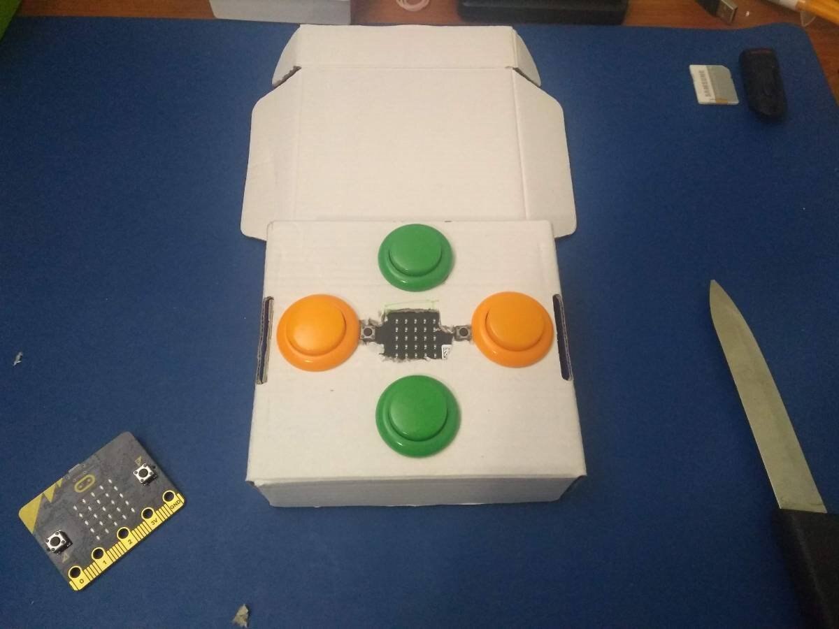

Creating a Remote Controlled BBC Microbit Robot
I had a Devastator Robot Chassis at hand and decided to give my kid something to play with. The Idea is to have one BBC Microbit as the remote and the other receive command to control the motor driver similar to the one given above.
Instead of the buttons, I use the accelerometer to get the orientation of the microbit and then use that to control the robot. Here is a demo.
This is not my best work but it was not meant to be. In a world with 3D printers and laser cutters, creativity SHOULD not be limited by access to these tools. My  prototype is basic but is operational. I did a small remote controller using a cardboard box.
{gallery} Cardboard Remote
