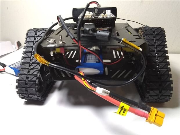

The BeagleBone Devastator Robot
Parts List

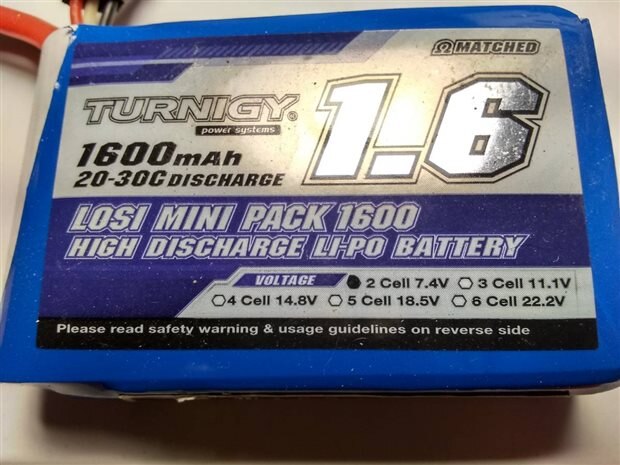

Turnigy 1600mAh 2S 20C LiPo Battery
https://hobbyking.com/en_us/turnigy-1600mah-2s-20c-losi-mini-sct-pack-part-losb1212.html
The " 2-wire JST-ZH (1.5mm pitch) " connectors needed for the motors were purchased from a seller on Amazon.
Logitech Webcam
https://www.amazon.com/Logitech-Widescreen-Calling-Recording-Desktop/dp/B006JH8T3S
DF Robot Devastator Tank Mobile Platform
https://www.amazon.com/DFROBOT-Devastator-Tank-Mobile-Platform/dp/B014L1CF1K?ref_=bl_dp_s_web_5611171011

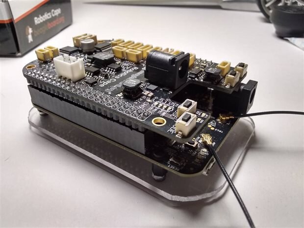

BeagleBone Robotics Cape Specs
  • 9-Axis IMU: Invensense MPU-9250
  • Barometer: Bosch BMP280
  • 4 x H-Bridge DC motor controllers
  • 8-Channel Servo/ESC output
  • 5V 2A switching regulator for robust power supply (8V -18V input voltage)
  • 6V 4A regulated power supply to protect servos
  • Charges a 2-cell LiPo battery
  • 4 Quadrature encoder inputs
  • GPS input with EM-406/EM-506 style UART connector
  • Headers for I2C, UART, SPI, ADC, PWM, GPIO connectivity
  • Supports DSM2 and DSMX satellite radios
https://beagleboard.org/capes
https://github.com/beagleboard/capes/tree/master/beaglebone/Robotics
https://github.com/StrawsonDesign/Robotics_Cape_Documentation

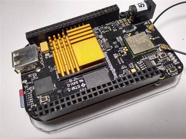

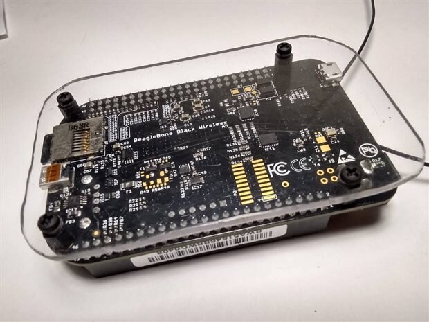

https://beagleboard.org/black-wireless

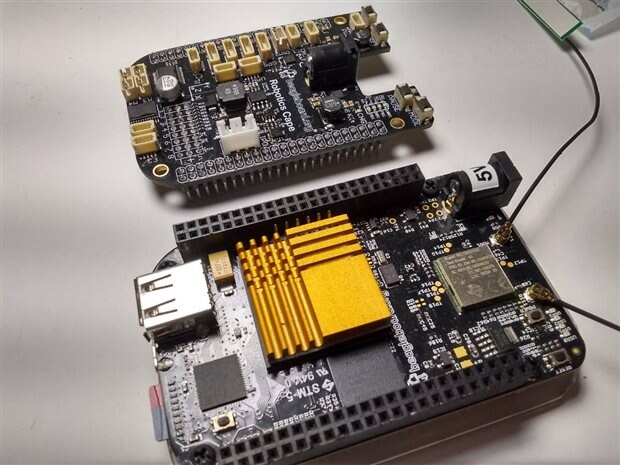

Custom Aluminum Heatsink is not included.
The BeagleBone Black Wireless has been mounted on a acrylic base with nylon stand and screws.
I'm using this Turnigy 2S 1600mAh 30C LiPo Battery Pack. Any 2S lipo battery pack should work.

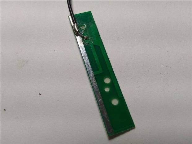

I've swapped the factory installed WiFi Antennas on the BBB W for the following
2.4GHz Mini Flexible WiFi Antenna with uFL Connector
https://www.adafruit.com/product/2308

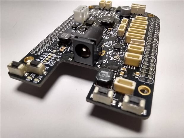

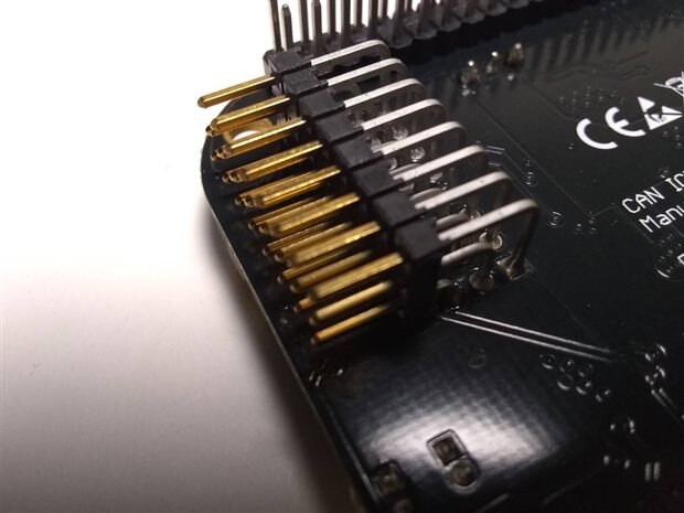

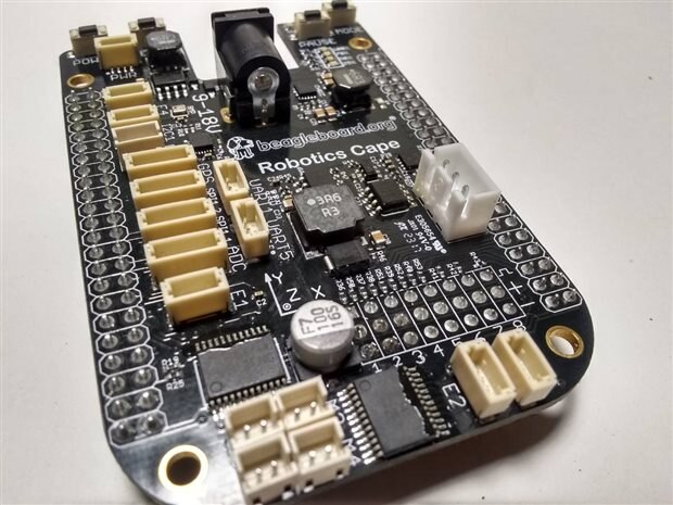

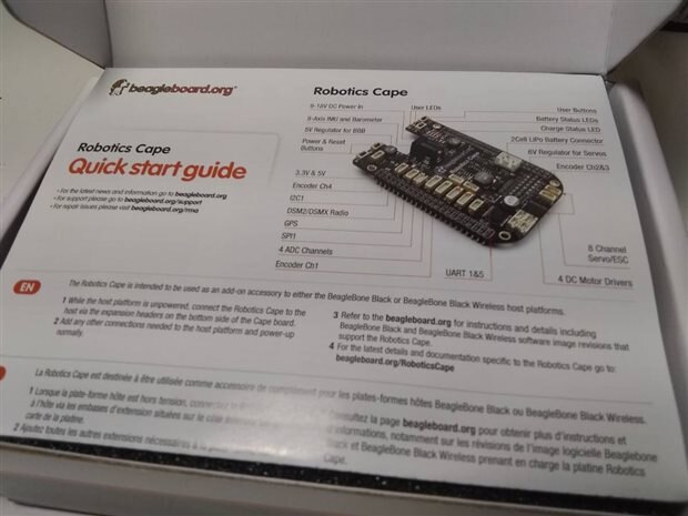

Unboxing the Robotics Cape
Quick Start Guide

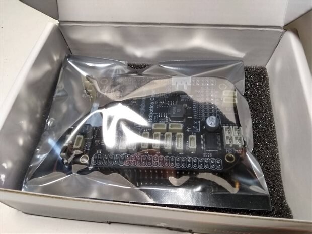

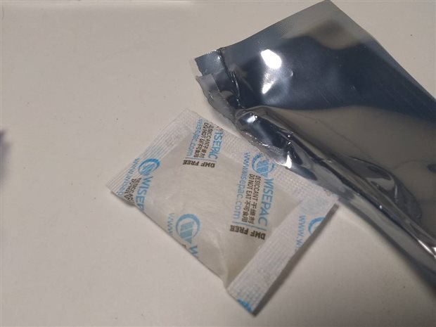

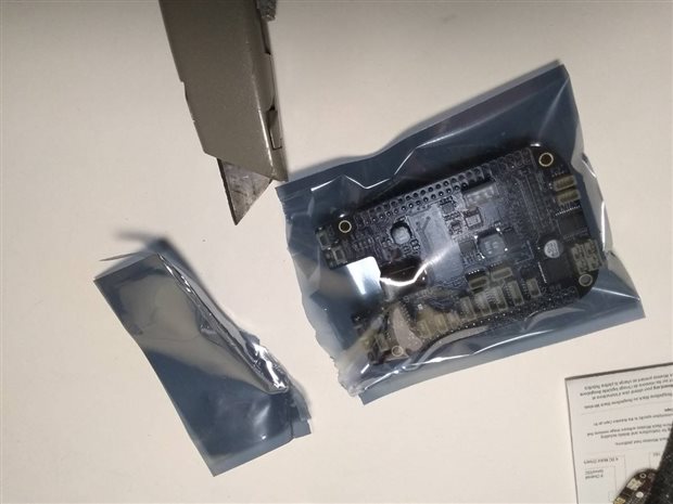

The Robotics Cape comes factory sealed in anti static bag.
I hoped there would be a JST Cable Bundle in here. *sigh image
Mr. Scissors has gone missing and Mr. Generic Boxcutter has lost his edge but we have managed to safely extract the Cape.
Comes with free desiccant pack. These little packs are great for absorbing excess moisture.
12V DC Barrel Jack for supplying power to the lipo charge circuit.

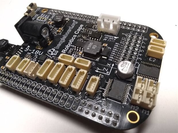

There is much to take in when viewing this cape so I will mainly focus on the connections that will be used.
The M1 and M2 2-wire JST-ZH (1.5mm pitch) motor drive connections located bottom right.
LiPo Battery Connetion located top center of photo.
8 x Servo Power Rail

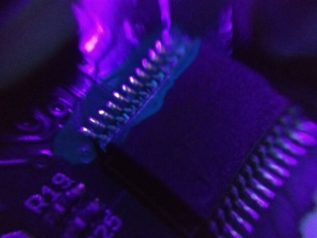

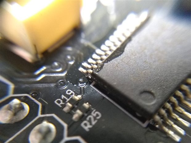

Conformal coating close-up
Florescence of Conformal Coating is revealed when exposed to UV light.

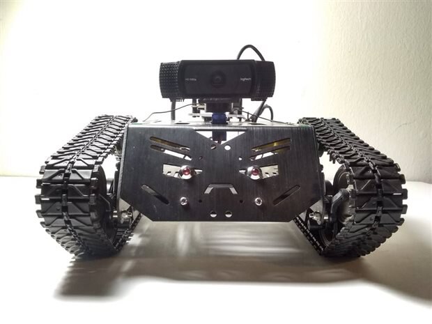

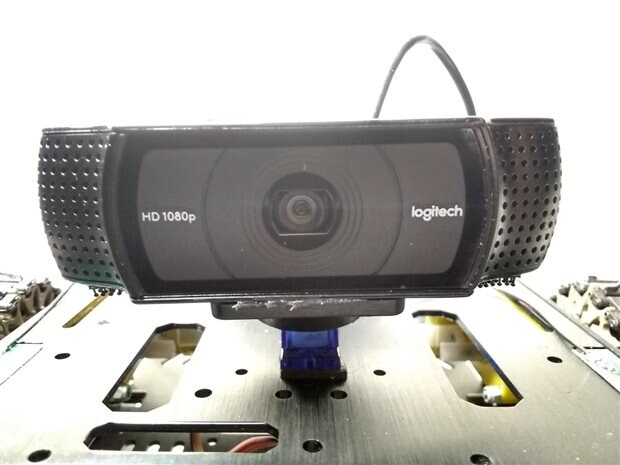

This is the Logitech HD Pro Webcam C920.  It is compatable with all BeagleBoard Computers and there are extensive resources and support for using this camera with the BeagleBone Debian Linux OS Images. I have removed the factory mount from the webcam and attached the cam to a microservo.
https://github.com/RobertCNelson/boot-scripts/tree/master/tools/software/mjpg-streamer
I am currently running this mjpg-streamer script.
The live stream has been successfully viewed with the Chrome Browser and VLC Media Player on Windows 10 and VLC for Android.
Further information on using the C920 Webcam with the BeagleBone

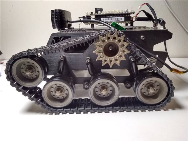

The Devastator Robotics Platform from DF Robot
This chassis kit was fairly easy to assemble. In order to decrease the amount of slack in the drive tracks, it was necessary to carefully remove one link from each side.
Video stream from the Logitech camera connected to the BeagleBone Black Wireless. Viewing stream on Windows 10 Laptop with Chrome Browser.
https://github.com/RobertCNelson/boot-scripts/tree/master/tools/software/mjpg-streamer.

    There is a HAT for the Pi Zero that is named Redbear IoT. It has a wifi chip similar to the chip on the Pi 3 and has the same antenna connection. It is a uFL antenna connection but it might have another name. I agree and would like to see Raspberry Pi consider an external antenna solution in the future.
    The antenna that were selected provide better signal gain. I might eventually have to purchase larger antennas as some loss of signal strength in certain areas of the home have been noticed.
