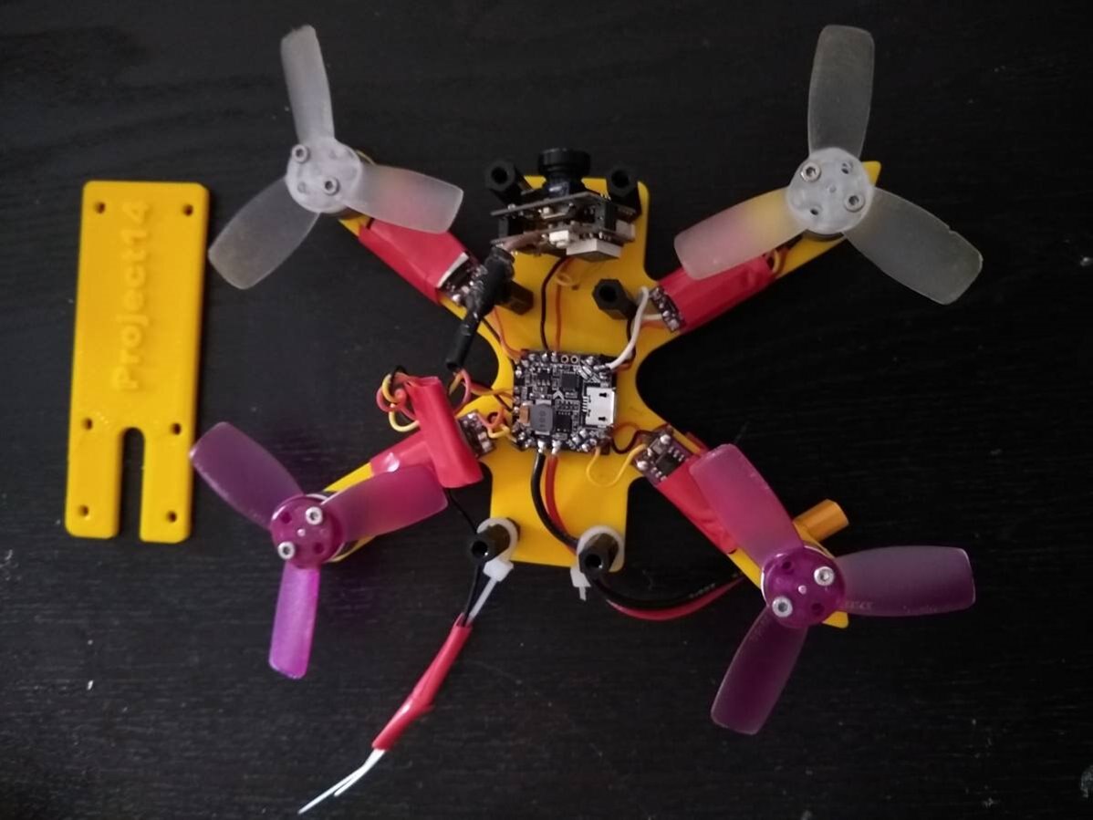

I have been part of RC hobby for many years, flying RC planes to start with, and now mostly flying racing FPV (first person view) quadcopter. So, when I saw the "Month of Robots" theme, and looked at my parts bin, I found an old broken quadcopter, with one of the ESCs (electronic speed controllers) fried, a burnt out flight controller and a broken frame, which meant I had to design a 3D printed frame. For this build I am using the STM32F303 based flight Controller, also called the Emax F3 Femto in RC lingo.
Here are the steps to follow to complete the build

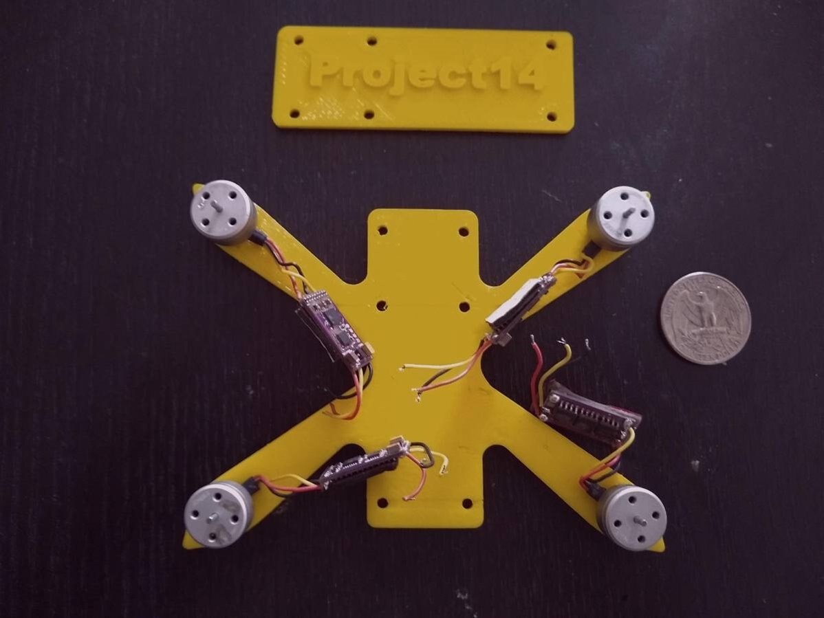

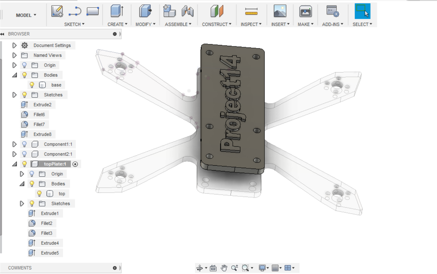

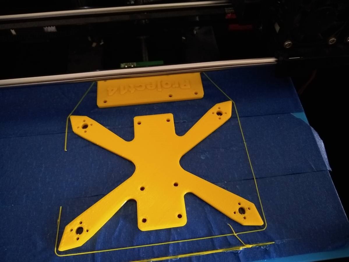

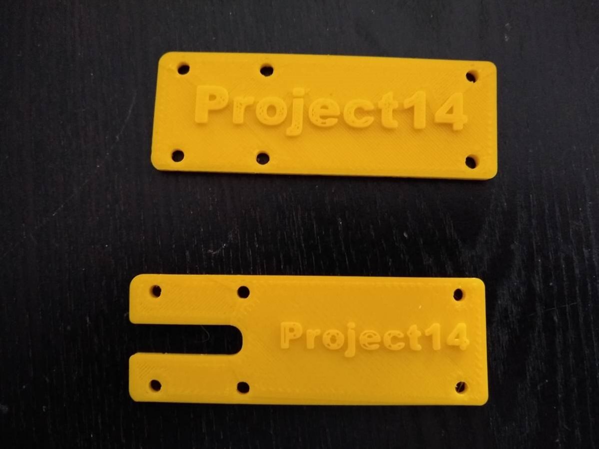

3D print the Frame:
For the frame I used Autodesk Fusion 360  to design it. The frame design is inspired by all the Alien frames out there. The old frame was a true X, which means after mounting the flight controller on this frame I have put a new PID(proportional integral derivative) tune on the quadcopter, which you can find in the dump file and the screen shots below.
For 3D printing, I used eSUN PLA + 1.75 mm filament. A suggestion here is to use atleast 60% infill with a hexagonal infill pattern to give the frame required strength to withstand crashes..
For the top, there are two versions , one for line of sight flight and the other one to install an FPV camera (first person view)

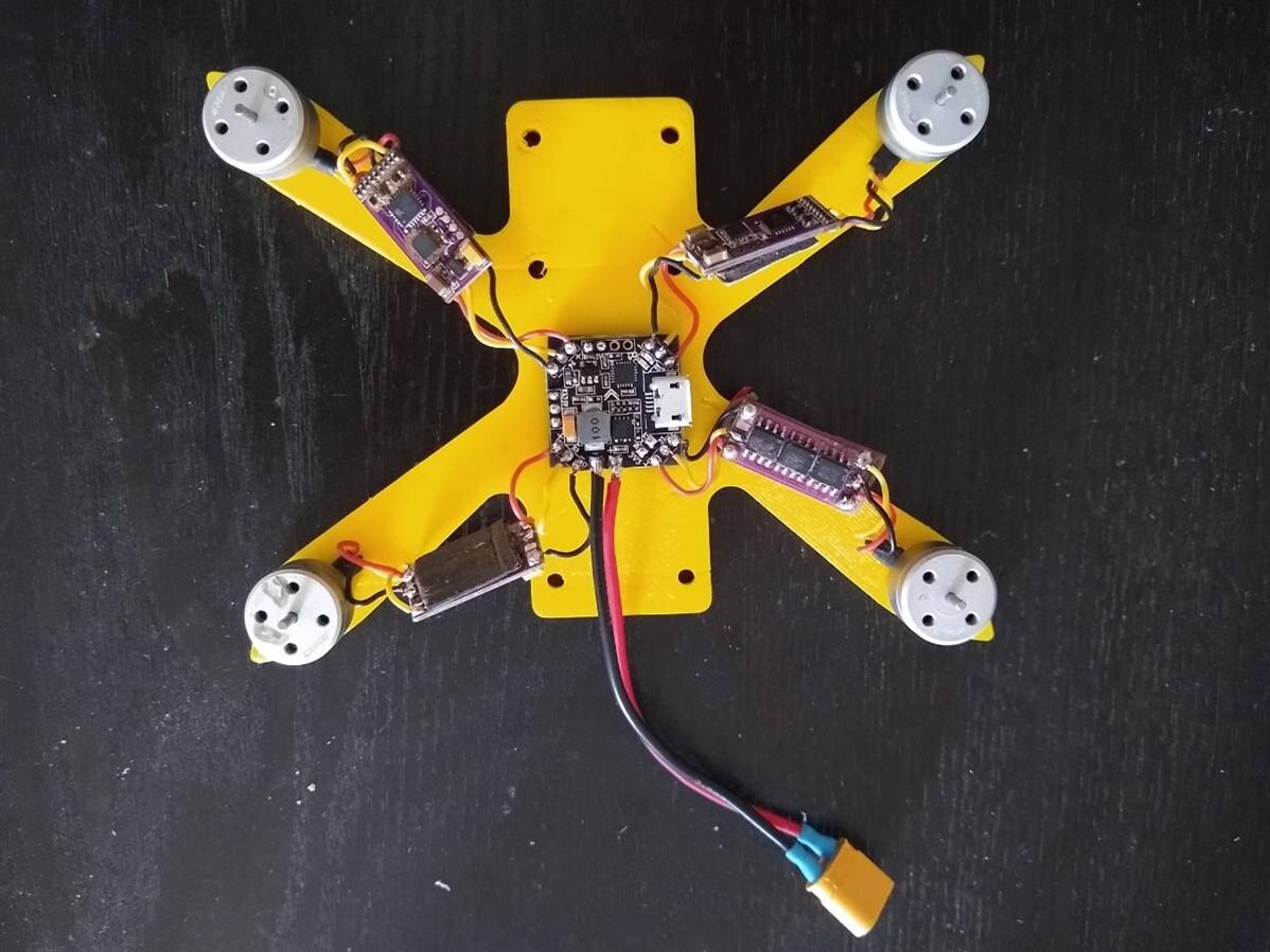

Solder the ESCs to the Motors
For the motors, I am using 1104 5250kv Brushless Motor, and 6A BLHeli 2S Plug-In ESCs, these do not come soldered to each other as you see in the picture below, you will have to solder the motor wires to one end of the ESC and the other end to connect to the flight controller. Don’t worry about the motor direction for now , as we can change the motor direction in a software called BLHeli – Configurator , more details below

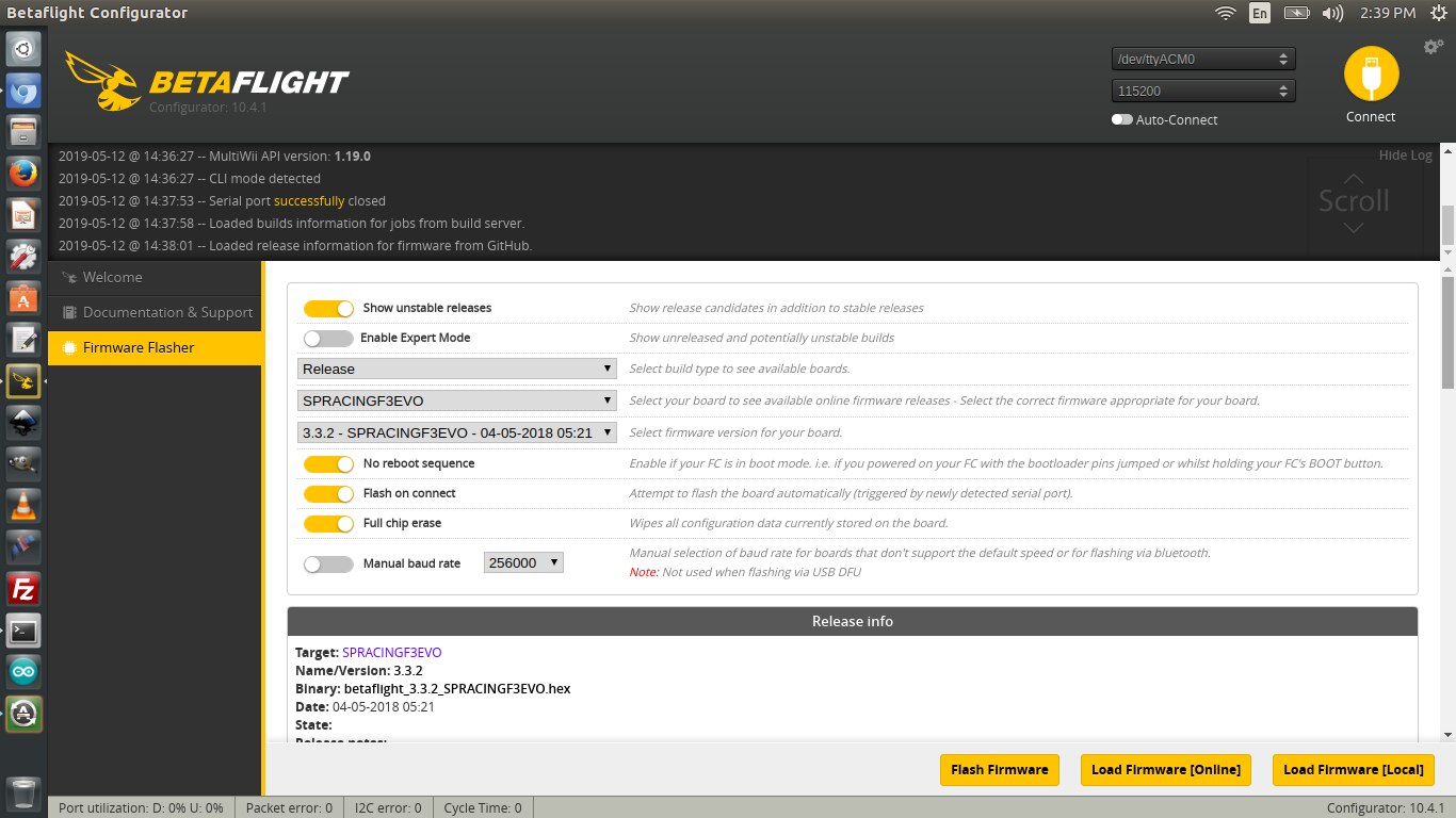

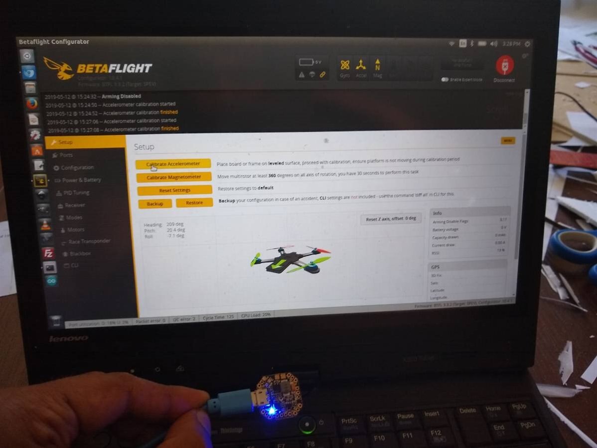

Flashing the Flight Controller using Betaflight
Before you start with soldering the ESC to the flight controller it is a good idea to check if you have Betaflight/Cleanflight  is flashed on your board, the  STM32F303 based flight Controller comes with an old version of Cleanflight, which means we need to flash a newer version of Betaflight, in my case I am using 3.3.2, the HEX file is attached below. So once you install Betaflight using the Chrome app extension, you can go to the Firmware flasher section , solder/short the boot pads on the flight controller which put the board in DFU mode and hit the Flash firmware button as you see in the screenshot below.
What is Betaflight? - Betaflight - Configurator  is a crossplatform configuration tool for Betaflight flight control system which allows you to configure your aircraft via a GUI. For more info check out - https://github.com/betaflight/betaflight-configurator
Once you have successfully flashed the board, reconnect the board and you should see quadcopter move, as you move your board, as you see in the picture below.

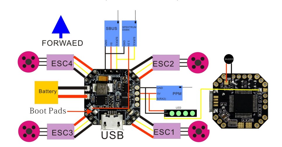

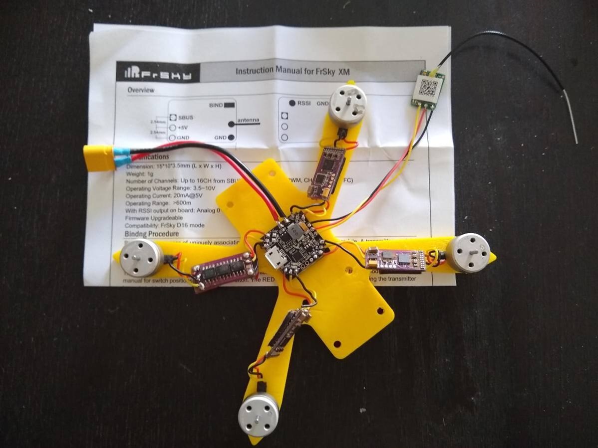

Connecting the  ESCs to the Flight controller
Solder ESC to the flight controller, and before you solder make a note of +ve and –ve on the board, a good idea if you don’t see the marking on the board is to do a continuity test using the battery pads to figure out which pads on the board are +ve and –ve.
Also solder a an XT30 male connector to the power pad, note depending on where you buy the flight controller it should come with a red JST RCY male connector, but I would not use it because after some use of connector, you can plug the battery in the opposite direction unknowingly and short your flight controller, I did this a couple of times and have now moved all my RC things to the XT30 connectors..
Here it the pin out diagram for the connections
Image from the Flight Controller Manual- Emax F3 femto based on STM32F303

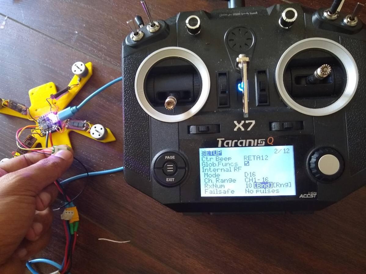

Solder a RC receiver
In my case for radio control I am using FrSky, which mean I had to use a FrSky XM SBUS micro receiver, thi is an ultra-light receiver with 16 channels, and as the controller I am using a Taranis qx7, the yellow wire going to the FC here is the SBUS wire, here are some features of the receiver
  • Number of Channels: Up to 16CH from SBUS(CH1~CH15 for PWM, CH16 RSSI for FC
  • Operating Voltage Range:3.5~10V
  • Operating Current:20mA@5V
  • Operating Range:>600m
Once done bind the receiver to the transmitter aka the radio, all radio’s has different steps to bind and setup receiver. For Frsky you have a bind option in the transmitter menu, as you see in the picture below..

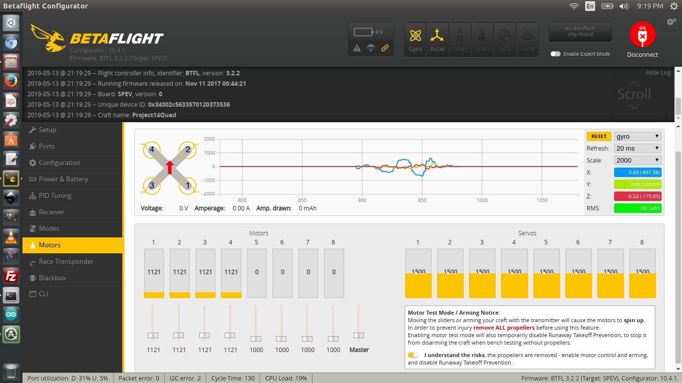

Check the Motor direction
Using Betaflight go to the motor pad and turn up each motor to check if the directions of rotation.

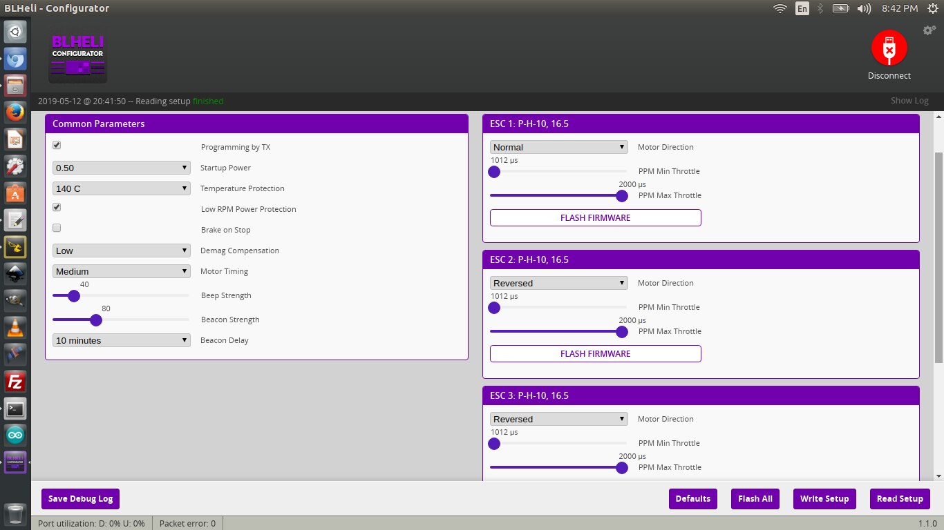

If the direction of the motors is wrong you will have to either de-solder  two motor wires and swap them to change the direction, of if your soldering iron is already switched off, download and install BLHeli – Configurator which is another chrome app, that reads the setup of your ESC’s and then reverse the direction if required, as you see in the screenshot below.
What is BLHeli – Configurator , chrome cross-platform configuration tool for BLHeli-based electronic speed controllers, for more info check out - https://github.com/blheli-configurator/blheli-configurator

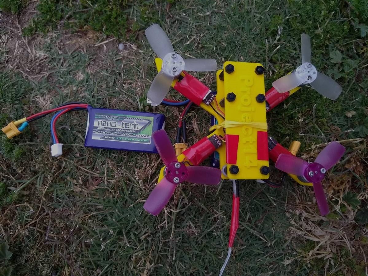

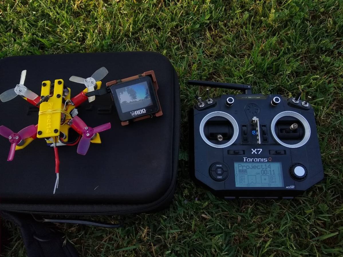

Adding the Top plate
Now using M3 Nylon hardware pack screw the top plate to the base as you see in the picture below, also tape the ESCs to the arms and also add zip ties to secure the receiver antenna.
Also another suggestion is to hot glue parts that you think can vibrate and fall off , like screws/standoffs after your first few flights.. Also to secure the lipo battery to the bottom use double sided velcro and a rubber band..

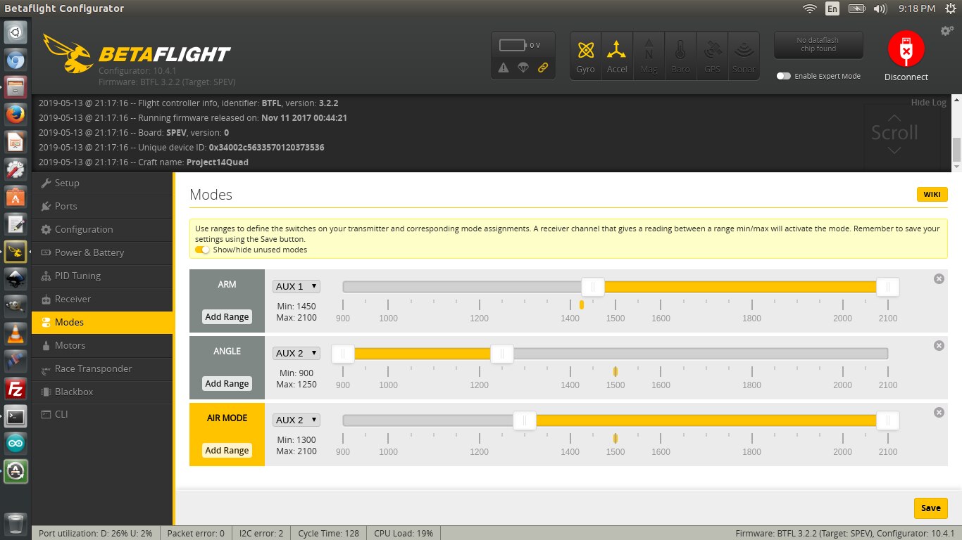

Setting up switches
Now setup the switches which correspond to your radio in Betaflight to Arm the quadcopter , and to fly the quadcopter in various modes like self-stabilization, Acro. In my case, I have AUX1 which corresponds to the left most switch on the radio - Taranis qx7 setup to Arm the quadcopter and AUX2 for stabilization and Air mode. You can also setup a beeper with the quadcopter to warn you when the battery is running low and act lost model finder alarm in case the quadcopter gets stuck in tall grass.

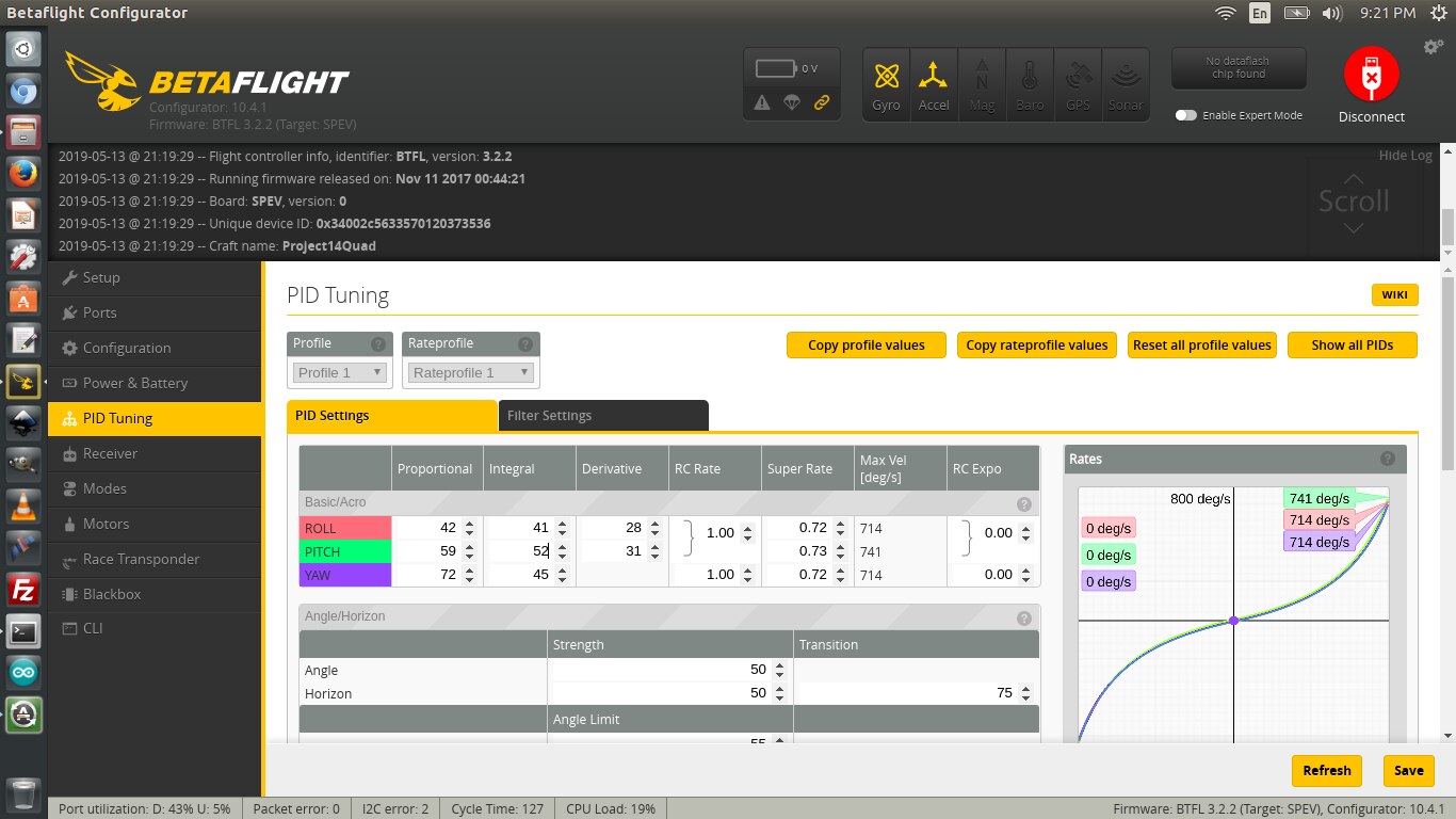

PID tuning
Here is my PID tune from Betaflight, and this is a complex topic to explain, which could be a future blog. And also added a dump from the Betaflight CLI. Note, PIDs vary from person to person, I have set these up for a beginner for this frame design.
Here is the dump file, using the Betaflight CLI.

profile 0
set dterm_lowpass_type = BIQUAD
set dterm_lowpass = 100
set dterm_notch_hz = 260
set dterm_notch_cutoff = 160
set vbat_pid_gain = OFF
set pid_at_min_throttle = ON
set anti_gravity_threshold = 350
set anti_gravity_gain = 1000
set setpoint_relax_ratio = 100
set dterm_setpoint_weight = 0
set acc_limit_yaw = 100
set acc_limit = 0
set crash_dthreshold = 50
set crash_gthreshold = 400
set crash_setpoint_threshold = 350
set crash_time = 500
set crash_delay = 0
set crash_recovery_angle = 10
set crash_recovery_rate = 100
set crash_limit_yaw = 200
set crash_recovery = OFF
set iterm_windup = 50
set iterm_limit = 150
set pidsum_limit = 500
set pidsum_limit_yaw = 400
set yaw_lowpass = 0
set p_pitch = 59
set i_pitch = 52
set d_pitch = 31
set p_roll = 42
set i_roll = 41
set d_roll = 28
set p_yaw = 72
set i_yaw = 45
set d_yaw = 20
set p_alt = 50
set i_alt = 0
set d_alt = 0
set p_level = 50
set i_level = 50
set d_level = 75
set p_vel = 55
set i_vel = 55
set d_vel = 75
set level_limit = 55
set horizon_tilt_effect = 75
set horizon_tilt_expert_mode = OFF
rateprofile 0
set rc_rate = 100
set rc_rate_yaw = 100
set rc_expo = 0
set rc_expo_yaw = 0
set thr_mid = 50
set thr_expo = 0
set roll_srate = 72
set pitch_srate = 73
set yaw_srate = 72
set tpa_rate = 10
set tpa_breakpoint = 1650

betaflight_3.2.2_SPRACINGF3EVO_hex.txt.zip
