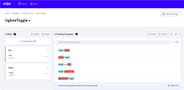

Finally, it's all wrapped up with Snips. We made a simple snips assistant with the following intents and training examples, and put all the code together in app.js. This way we could ask Lil Luxo to pick up the Zigbee light and shine it, put it down, and also control the Zigbee light on its own.
For a more detailed outline of how to create a Snips assistant, check out our Arm DevDay workshop from January 2019 here.
The Snips Assistant and App.
The robotState intent inside the RobotControl app.
The zigbeeToggle intent inside RobotControl app.
The custom toggle slot.
The custom light slot.
