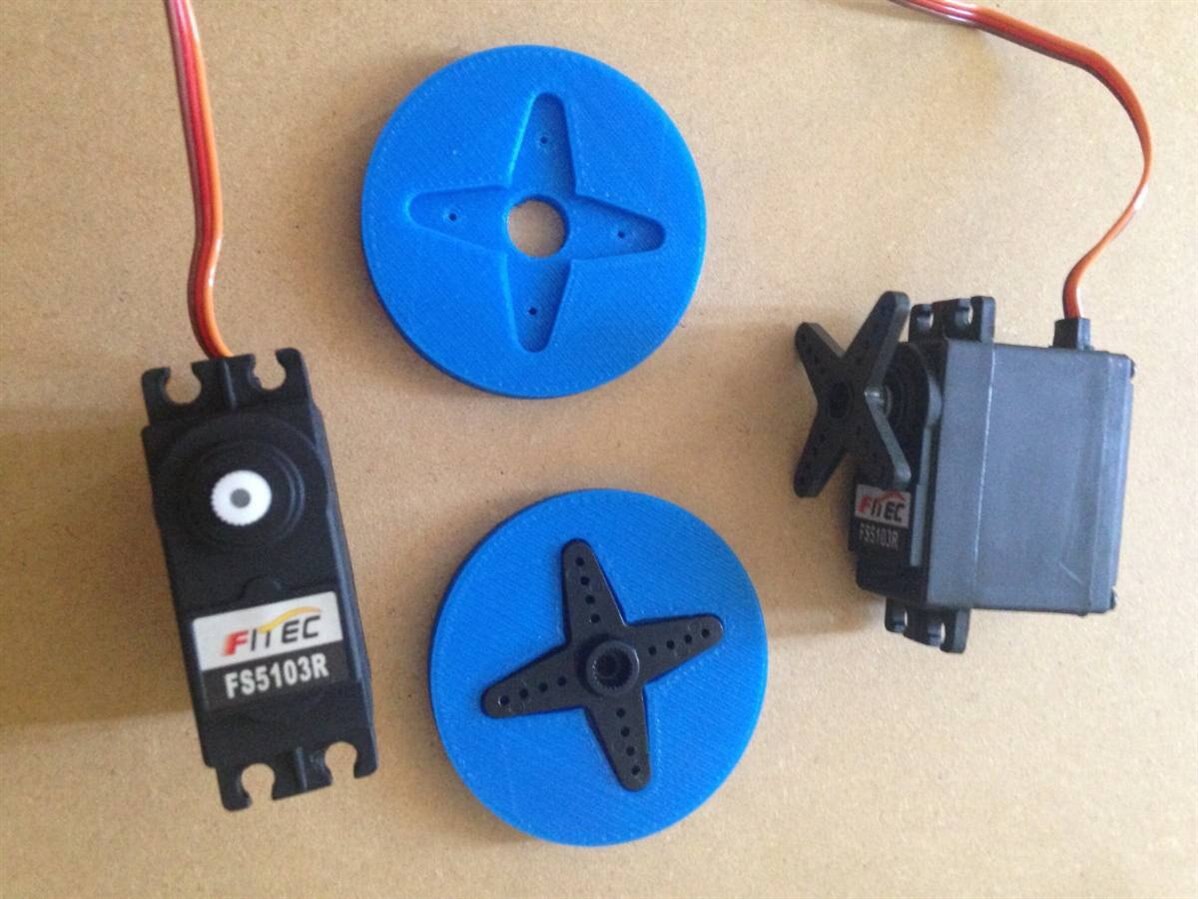

For the past couple of months I have been working on a servo mechanism for my design challenge project called the Bluetooth Maze which you can check out at - Bluetooth Maze - Final Build . Putting the mechanism together was the most difficult part of the challenge which, I least expected. So, when I saw the Mover and Shaker theme for the month, I knew I had to post a project, but this time around my plan is to use continuous rotation servos and I am calling the robot a– Continuous Servo Bot .

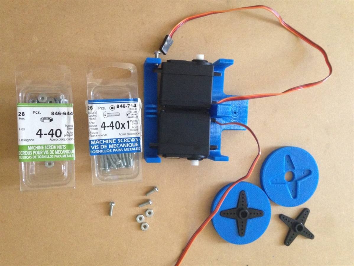

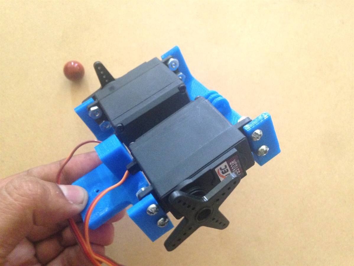

As part of the build, my idea is to create 3D printed parts to hold the continuous servo as you see in the picture below, and then have an half sized breadboard placed on top.

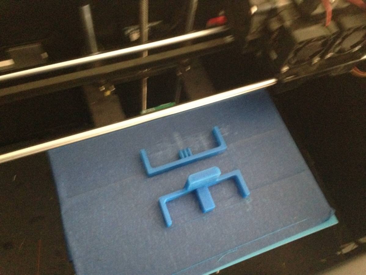

As part of the 3D printed parts which are printed in Blue PLA 1.75 mm filament , the back part (continuous_servo_back.stl) had a circular holder to hold a marble, which will act as the 3rd leg/wheel of the bot. In addition, front 3D part (continuous_servo_front.stl) has a Gopro type holder mount to hold sensors like the ultrasonic sensor or a Pi Camera.  And the two wheels are held together with 4 finger servo arm.
{gallery} 3D printed parts
3D printing Servo holders
Wheels for the continuous Servo
use 4x40 nuts and screws to hold the servos to the 3D printed arm.

    Looking good. The weight distribution is key so try and get the majority of the weight on the wheels rather than the skid as the marble can dig in on some surfaces. If you go too far the other way and…
  • 14rhb
    14rhb over 8 years ago +3
    Hi Carmelito, Well designed parts and a really good print quality there I look forward to reading about your progress. Rod
    genebren over 8 years ago +2
    That is a great start on your robot. The 3D part look well designed and solid. I like how well integrated all the parts look (direct coupled wheels and uni-body construction). Gene
