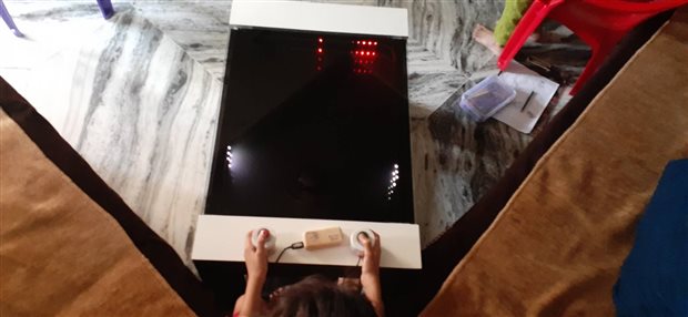

I made 3D illusion table few years back,
During This lockdown period my kids getting board so I decided to make Pong Game.
So I re-program Arduino to make 1D Pong game.
I tried to understand code of Greatscott! & Other bloggers but Finally decided to write code from scratch.
    As I am not professional programmer I spent Almost 3 days & finally get success.
Although my kids not fully satisfied with it but I am satisfied with it.
Hardware:-
1 >Arduino Promini
2 >WS2811 Addressable Led Strip 2 MTR.(60 Led/MTR, 5VDC rated)
3 >USB cable for power up project.
4 >Power bank 5VDC, 3000 Mah.

    This was a graduation project in many colleges more than 10years ago. Instead they use 10 mm leads without retaining the ranking. I had a thinted glass on the leds such that only working leads can be seen…
