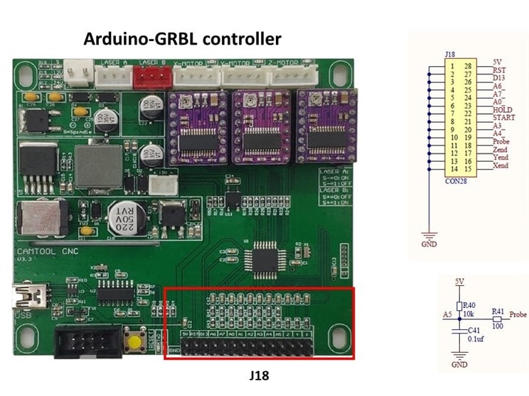

I'm jumping ahead a little to make sure I can add the required focusing functionality to the LaserGRBL program.  I'm used to the method that 3D printers use to home their axes which is to move into the limit switches.  After reading through the GRBL documentation I realized that moving into the hard limit switches actually causes an alarm condition which requires a reset.  Since GRBL 0.9, a "probe" function has been added that is commonly used to set the Z-axis position, so I'm going to use that input rather the Zend input to signal that I've reached the focus position.
Here is a picture of the top of my controller board with the interface connector highlighted and the schematic that shows the Probe input.
I'll need to wire a digital output from the MicroView to the Probe input and program that output to switch high when the VL6180X measured distance is 39 mm.

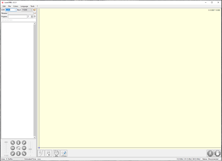

Then I'll need to create a custom button within LaserGRBL to execute the alignment code.  It turns out creating the custom button is straightforward.  You right click in the button bar at the bottom and it brings up a dialog to create/edit the custom button.
Here is a screenshot of the LaserGRBL Control Panel:
You can see the custom "Z Focus" button that I created at the left.

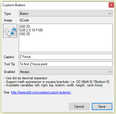

And here is the custom button edit panel:
The gcode for testing is very simple.
G92 Z0 sets the current Z position to 0
G38.2 Z-10 F100 is the probe command that moves Z down -10 mm at a speed of 100 mm/min.  The travel will stop when the "Probe" input is pulled low or Z-10 is reached - whichever comes first.  An alarm will occur if the "Probe" input does not switch before the endpoint is reached.
G92 Z0 sets the new position to be Z0
The procedure will be to set the laser head so that the distance measurement is >= 45 mm and then hit the Z Focus button.  The Z position should now be aligned when the head stops.

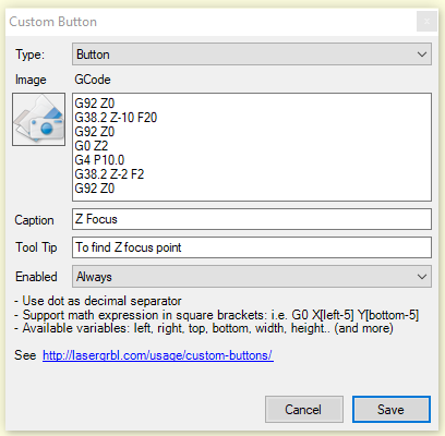

Testing
I updated the MicroView program and mounted the assembly on the laser head.  I am using the A0 pin as my "probe" signal so I wired that to the Probe input of the GRBL controller.
The first couple of tries failed with no probe detection so I thought that I had mis-wired the probe signal, but it turned out that I had set the feed rate so that it was too fast for the response time of the probe detection in the GRBL program.  The setting that I was using was 100 mm/min.  I saw that for mechanical probes examples they were using 10 mm/min but I thought that was because they were worried about over travel into a hard surface.  I played with the speed a bit and determined that 20 mm/min worked reliably but because of the heavy averaging that I would overshoot the 39 mm target.  I decided to do the initial align at 20 mm/min and then back off 2 mm and realign at at 2 mm/min.
Here is the updated button program:
