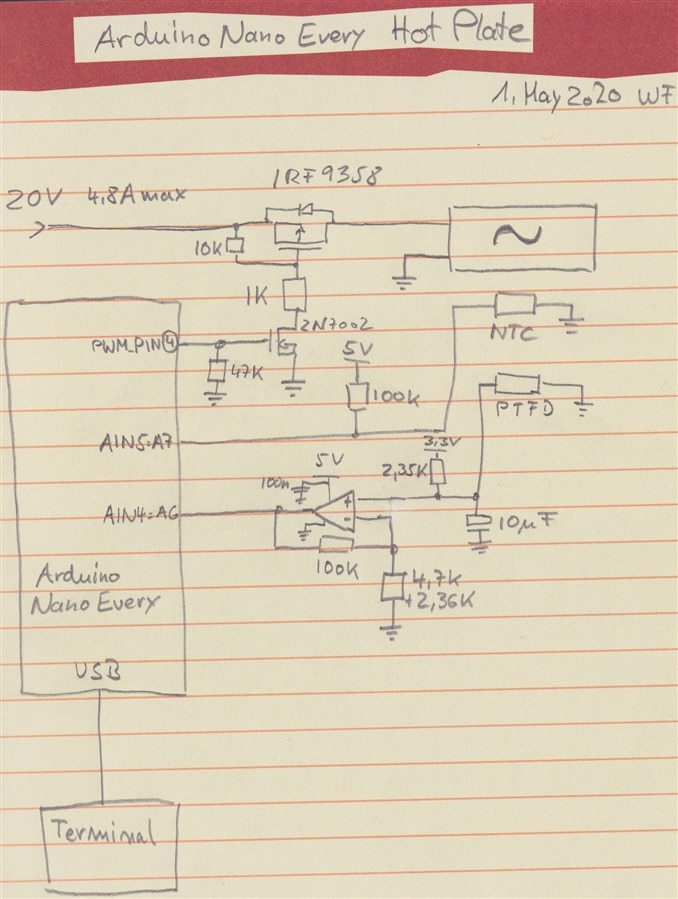

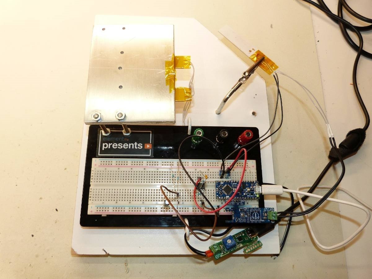

Full Circuit
All ingredients sprinkled over the breadboard, resulted in the following circuit.
The NTC is set up in the lower end of a resistive voltage divider. With the temperature up to 260°C, this gives a large enough voltage swing to feed directly into the ADC of the Arduino.
The PTFD needs a high resistor relative to its own resistance to limit the current to <1.4mA. With a resistance change of only 38.5Ohm/100°C the voltage swing is only ~100mV for 260°C. The added opamp in non-inverting configuration has a gain of 15.2, which brings the maximum voltage to 4.6V at 260°C. This is enough to have good resolution with the ADC.
The power switching circuit is a basic high-side P-FET (IRF9358). This is a dual FET, so I took both in parallel to reduce the total Rds_on and reduce the wasted power dissipation. A simple 2N7002 N-FET acts as the gate driver.
Let me know in the comments if you have any questions. I should go to the dark side and install Fritzing for proper Arduino documentation.
The Build
{gallery} The Build

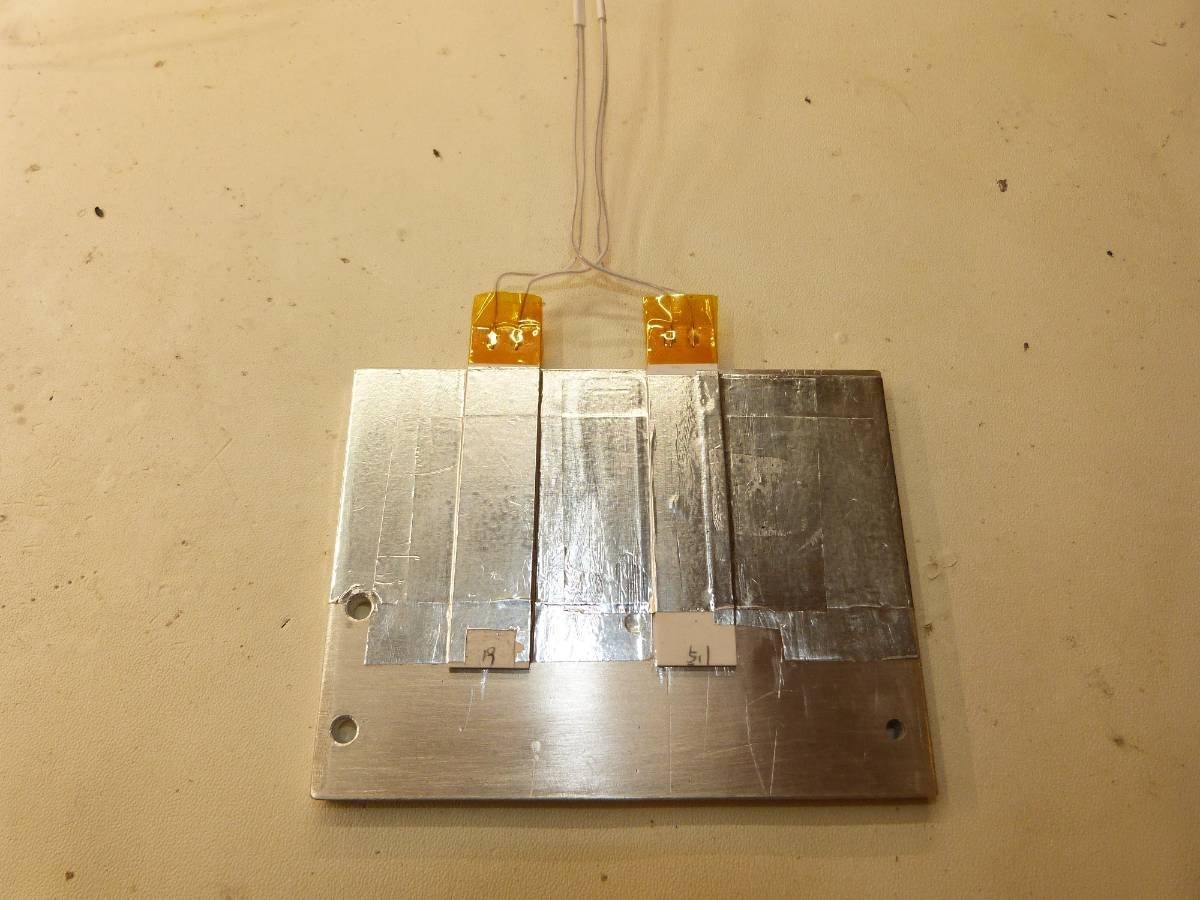

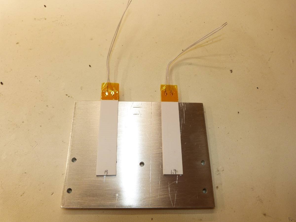

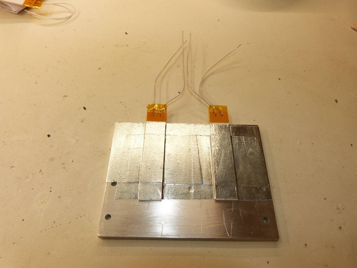

Build Step 1: I built up the large hot plate with 2x 2 Ohm (1.9 Ohm to be precise) heater elements in series, mounted on the bottom of an aluminium plate. This is where the next issue started, but it is hard to tell by just looking at the picture. Later more...
Build Step 2: The heaters are fixed to the plate with duct-tape, real duct-tape made out of aluminium foil with a sticky side. I was concerned that the glue would give way when heated, but so far it is holding together wonderful.

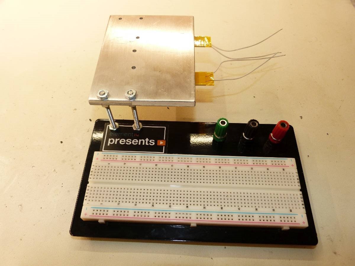

Build Step 3: The plate got mounted to the protoboard, nicely showcasing the element14 sticker. The 2 screws provide enough heat isolation, that the base of the protoboard does not get more than a little warm.

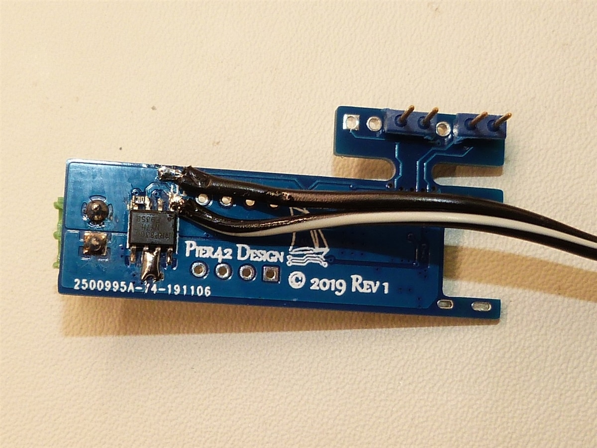

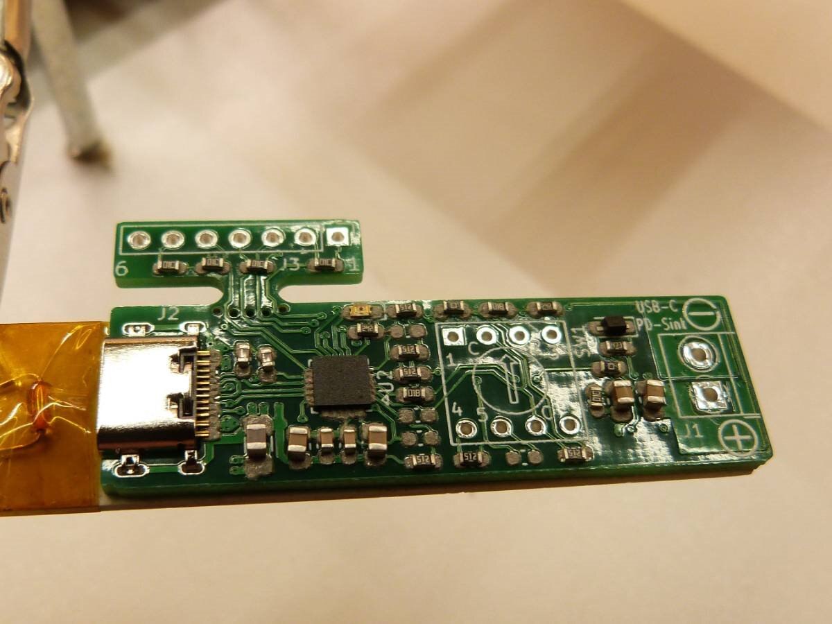

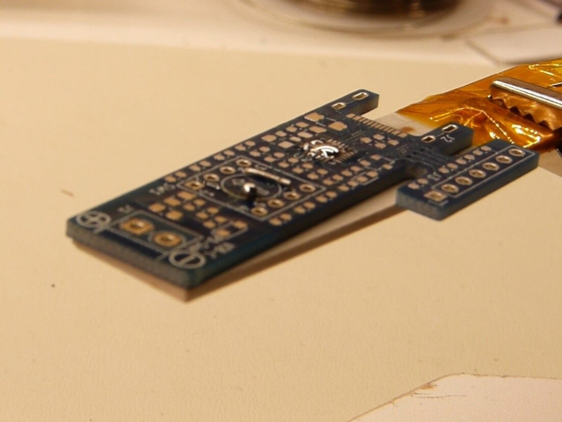

Build Step 4: For the FET to switch the power, I used an old version of the USB-C PC board with only the FET+ support components.
Build Step 5: The plate was supposed to draw 5A from my 20V USB-C PD power supply and was wondering why it did not heat up as fast as expected. It turned out that one of the elements was 19 Ohm instead of 1.9 Ohm image as I thought was written on it (totally omitting the missing comma). As luck will have it, the 19 Ohm heater in parallel with a 5.1 Ohm heater element is almost exactly 4 Ohm again. So my test could continue almost as planned. I just moved the 5.1 Ohm element closer to the center as it accounts for 80% of the heating power.
Build Step 6: Everything, including the Arduino Nano Every, mounted on a piece of laminated particle board with 2 hooks holding down the protoboard with the big hot plate to avoid tipping over and burn holes in my antistactic mat. It would still burn the laminate, but that would be just smelly and not an ugly mess. This is the first full setup with the small heater connected (top right) that is used for the initial temperature profile tests. One can even see the stain dots on the heater, where I put some small solder pieces to see them melt. Which they did. imageimage 20V 4.8A power is supplied by the green USB-C PD board. The circuit to the left of the Arduino is the opamp and the PTFD heater, which is patiently waiting for its testing.

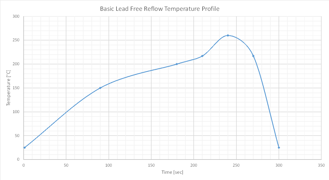

I was debating to use the PID library, but decided to roll my own code. And to make life easier, I am going to ignore the letters P and I and only use the derivative term of the temperature measurement, in the form of the rate of temperature change, for my control loop. Time passes and I learnt that I cannot ignore the letter P for the proportional term. The change in temperature could be perfect, but with an unknown offset, the system could do whatever it wants to.

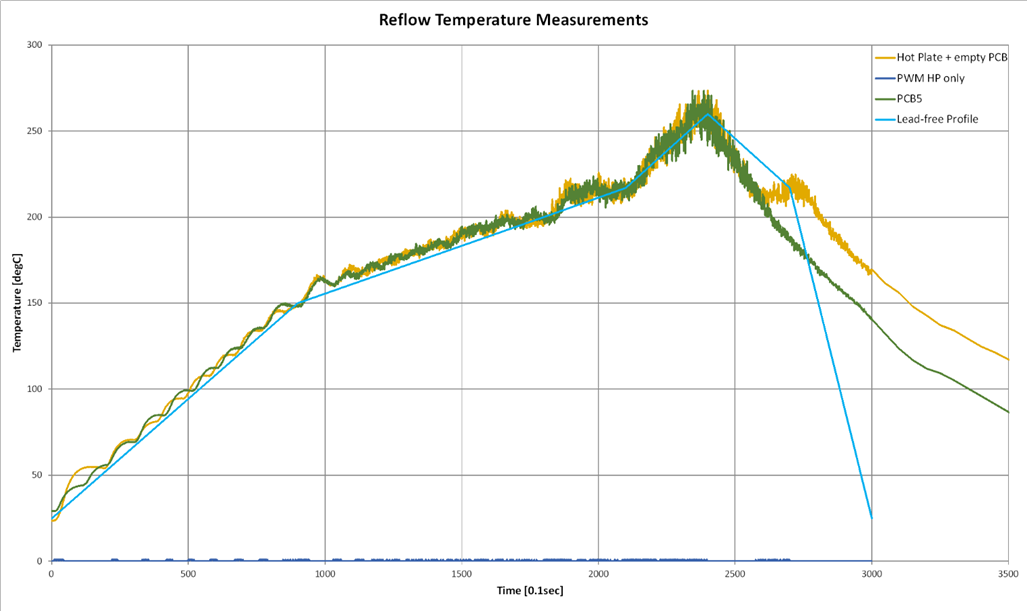

The main loop is comparing the measured temperature rise against the set temperature rise defined in the temperature profile. Heating is turned on or off accordingly. Heating happens through a basic PWM signal with a limit to the maximum on-time. This is a safety feature, as a 100% heat cycle might break the MCH element without an additional sink for the heat. To avoid overshot the PWM signal is further limited when the measured temperature is reaching the next fix point in the profile.
Temperature measurement is done in 2 steps. The ADC measures the voltage of the resistor divider consisting of a fixed resistor and the temperature element and the resistance of the element is calculated. Then the temperature is calculated through approximation formulas for the different thermal elements.
Formulas for the NTC:
Resistor divider with the NTC on the high side connected to the 5V rail:
Approximation formula for the NTC element:  T=(T0×β)/(β+T0×lnβ/R0) −273.15°C
Formulas for the PTFD:
Resistor divider with the PTFD on the low side, including a 15.1643x non-inverting opamp to fit the signal better into the dynamic range of the ADC:
Approximation formula for the PTFD element:  T=2.5974×R−259.74
Some telemetry data is printed to the serial port and the PWM state is mirrored at the on-board LED for visual feedback.

const double profile_time[]        = { 1, 90, 180, 210, 240, 270, 300};    // seconds into the profile
//const double profile_time[]        = {  1, 9, 18, 21, 24, 27, 30};    // TEST seconds into the profile
//const double profile_temp[]    =  { 25, 50, 60, 60, 80, 40,  25}; // TEST temperature at time point
const double profile_temp[]    =  { 25, 150, 200, 217, 260, 217,  25}; // temperature at time point

Temperature Profile
I am using a basic lead free temperature profile as shown in the graph.
And here are temperature measurements of 2 different process runs with lots of interesting things to note.
First is the yellow trace, which was a bare PCB to test if the hot plate is able to reach max temperature with a PCB as a heat mass.
The measurements get more jittery at higher temp, which is because the NTC curve gets flatter (what a bad pun) at higher temperatures. Beyond 300 sec are less measurements, so it looks cleaner too.
At the time axis, the thicker line indicates a PWM on cycle, so the heater is heating. At the start, the temperature rise is very steep, so we are seeing a big overshoot in temperature.
During the cooling cycle, the temperature is dropping fast initially and when it was too far away from the desired temperature, it started heating again for a significant period. This is leading to a 20° higher temperature during the rest of the cooldown compared to the green trace without heat during cooldown. The cooldown is convection only with a nice exponential drop.
For the green trace, which was a real PCB+components solder cycle, I reduced the limit above the profile temperature and did not allow heating during cooldown.
The temperature is close enough to the profile, that I would call the regulation algorithm a success.
Cooking a board
As it turned out, the 95W power is not enough to heat the big aluminium plate quick enough to match the profile. So I did all tests and board soldering on a single small heater element. Luckily my test PCB is small enough to fit almost nicely on the small heater.
An out-of-focus picture with a leaded solder piece and lead-free paste already melted and the lead-free piece not yet melted
A good board, that is prepared with solder paste through the stencil and all components pick&placed.
And a video showing the soldering process from about 200°C to 260°C and cooling back down below 150°C. As you can see the extension with the 6-pin through hole header and the 4 resistors does not fit on the heating element and the resistors do not get soldered in the process. This is a 4X time-lapse.
Another video with a 2nd board, that has too much solder paste and you can see some bridges forming. they get resolved later through re-work with plenty of flux and a pencil-tip soldering iron. I wanted to have a shot from a higher angle, but did not have a good stand, people with motion-sickness should not watch this one. My apology.
