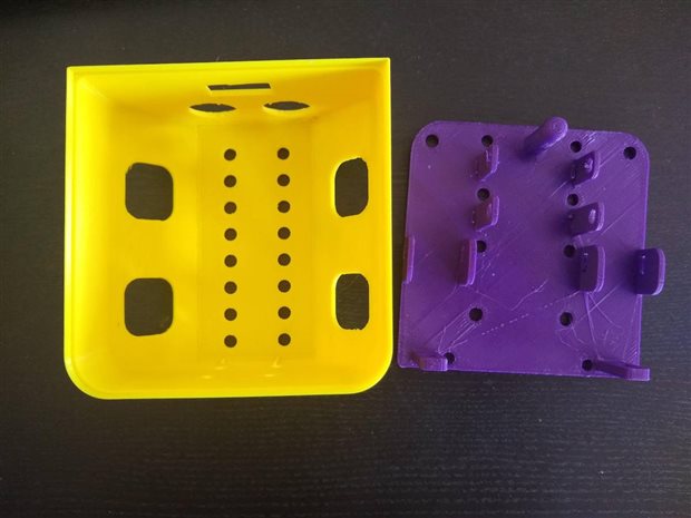

3D printing
Here is a picture of the 3D printed parts which are designed in Fusion 360. You can use PLA or ABS, and you will not require any support material while 3D printing. STLs files for the 3D printed parts attached below. Basically there are two parts, the bottom to hold the battery and the breadboard, and the yellow top cover to hold the ultrasonic sensor.

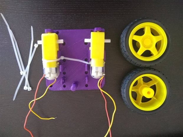

The motors are added to the bottom 3D printed parts using zip ties, which are much simpler to find compared to the exact screws and nuts..

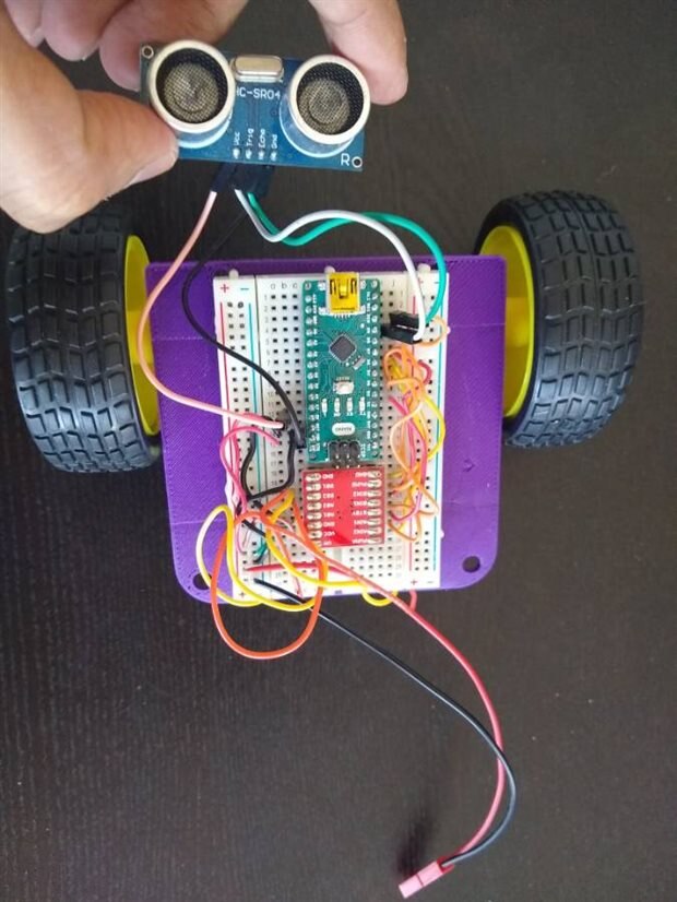

Circuit
Here are the circuit connections using the Sparkfun motor driver(TB6612FNG) and Arduino Nano.
  • PWMA on the motor driver connected to pin# 5
  • AIN1 to pin# 4
  • AIN2 to pin# 2
  • PWMB to pin# 6
  • BIN1 to pin# 7
  • BIN2 to pin# 8
  • STBY to pin# 3
And for the ultrasonic sensor(HC-SR04) connected to
  • Trigger Pin  to Arduino pin# 9
  • Echo Pin to Arduino pin # 10

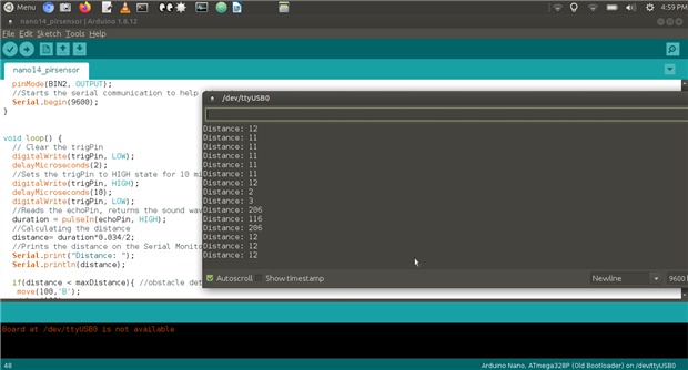

Upload the Code using Arduino IDE
Upload the code below using the Arduino IDE, and if you want to test the motors individually , un-comment section below that says - "//uncomment this section", and comment the if and else loop above it.

  //Prints the distance on the Serial Monitor- use this to modify the maxDistance above
  Serial.print("Distance: ");
  Serial.println(distance);

And, if you want to run a test using the ultrasonic sensor and the motors to set the maxDistance parameter use the serial monitor as shown below.

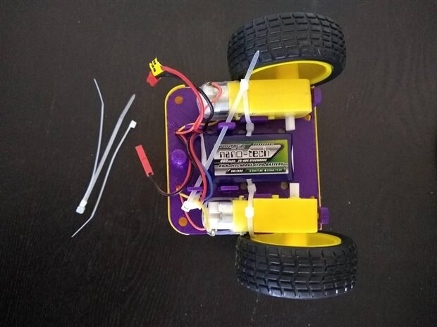

Add a 2 cell lipo battery to the bottom of the 3D printed part with zip ties as you see in the picture below. In my case I am using Turnigy nano-tech 460mah 2S , but a regular 9V battery will also fit the 3D printed part.

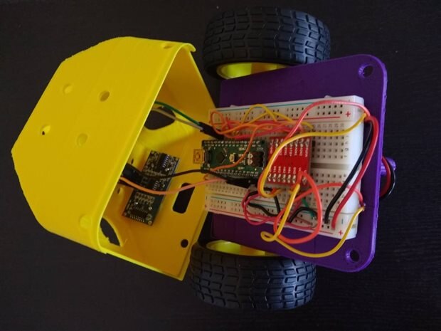

Add the ultrasonic sensor to the top 3D printed part as shown in the picture below, and you can also use zip ties in the front and back to semi permanently add the top to the bottom STL.

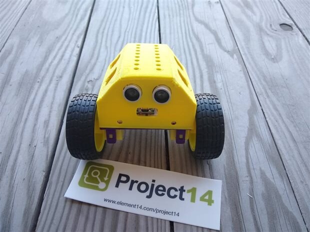

Here is a quick video demo
