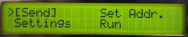

Here is the initial splash screen. Upon startup/reset, the program displays this image for 3 seconds (Nice little plug for element14 NanoRama).  When time expires, the screen reverts to the main menu level.
This is the Main menu.  The '>' symbol is the menuing cursor and shows the active item.  The joystick Up/Down and Left/Right controls are used to move the cursors between the menu items.  The first menu item (at the '>' cursor) is a Select Box.  It contains a list of valid selections for the given field (in this case there are only two valid selections, Send and Recv).
Pressing the Joystick button (pressing down on the Joystick control), changes the cursor to the show the Scroll cursor (custom character created with 'lcd.createChar()' function).  In this mode, the Up/Down controls are used to step through the available selections.  Pressing the Joystick button again save the selection and ends the edit mode, returning back to the normal cursor ('>').
Using either the Joystick Up or Down action results in the Select Box showing the next available item.  Here the only other item in this field is displayed (Recv).  Further Up or Down actions would toggle between Send and Recv.  Pressing the Joystick button will revert the cursor back to menu item select cursor '>'.

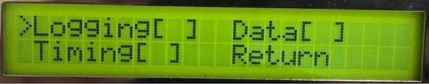

Having selected Recv and then moving the cursor to 'Settings' and pressing the Joystick button, displays the Receive edit menu.  This menu contains three checkbox edit fields that are used to select/deselect options during a receive run.  The options include: Logging receive data to the serial memory, showing the receive data on the run menu as it is received and showing the timing measurements of the Mark/Post Mark pulse widths.
Pressing the Joystick button cause the current checkbox field to toggle between checked and uncheck.  The Up/down and Left/right joystick movements cause the select cursor to move between the edit/menu fields.

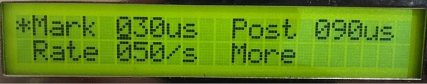

Having returned to the main menu and selected Send, and moving the cursor to 'Settings' and pressing the Joystick button, displays the Send edit menu.  This menu contains three number edit boxes and a menu item to advance to the second page of the Send settings.  These three variables control the DMX framing pulse (Mark and Post Mark) and the frame rate that will be used to sending out DMX data packets.
Pressing the Joystick button changes the cursor to the show the number edit cursor In this mode, the Up/Down controls are used to increase (Up) or decrease (Down) the selected digit in the number field (shown by underscore cursor).  The Left/Right controls are used to move between the digits.  The edit values are limited by Min/Max settings, such only valid entries are shown. Pressing the Joystick button again save the selection and ends the edit mode, returning back to the normal cursor ('>').
Here is an example of having moved the joystick up while the most significant digit is selected, the digit is incremented by 1 and the value is increamented by 100.
Having moved the joystick to the right and then down, the center digit has been selected and decremented (value decreased by 10).
Notes: The joystick movements are debounced and latched, such that a release (joystick return to center position and/or pushbutton release) is needed prior to the next menu action.  This prevents movements/changes from occurring extremely fast.
