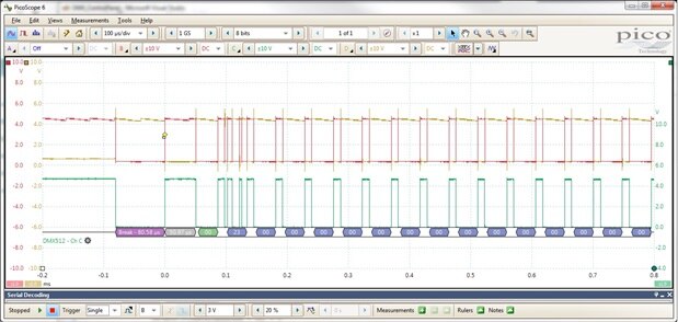

With the code ported (and heavily modified), I was able to send and receive data.  Here are some scope captures of my DMX data streams.

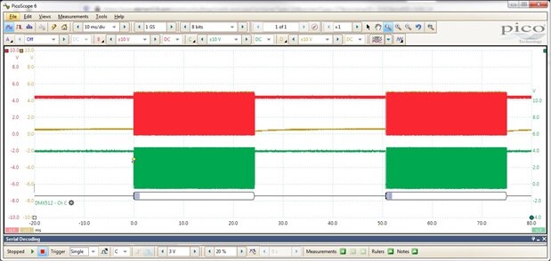

The Red and Yellow traces are the differential outputs of the RS-485 driver.  The Green trace is the generated DMX signal that is pasted to differential driver.  At this level of detail, we can see the repeat rate of the DMX signal.  It appears to be a little of specification, as it was intended to by repeating at a 50 mSec rate (currently 50.7 mSec).  I will need to double check my timing, which is determined by using Timer2.
The Red and Yellow traces are the differential outputs of the RS-485 driver.  The Green trace is the generated DMX signal that is sent to differential driver.  Looking at the DMX decoding (below the Green trace), the Break pulse (also referred to as Mark) is 80.58 uSec and the Post Mark is 50.97 uSec (set via the menu system to 80 and 50 uSec respectively).  The first frame following the Mark sequence is a zero, this is the start code.  The second frame, seen here as 23 is being used as a frame counter, which is being incremented with each generated message.  All other of the remaining frames (or slots) are set to zero.  As I continue to code this product, I want to have the ability to select different frames and set the values either using the joystick, or from a script file stored on an external EEPROM memory.

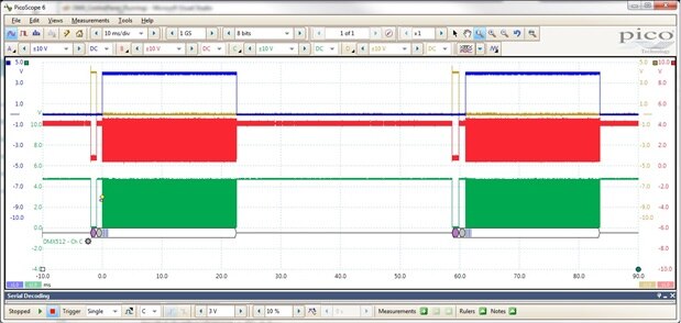

The Red trace is one half of the differential outputs of the RS-485 driver.  The Green trace is the received DMX signal that is received from differential receiver.  At this level of detail, we can see the repeat rate of the DMX signal.  In this case the DMX signal is being generated by a PC using a crude DMX decoder.  The Mark and Post Mark sequences are generated  directly from the PC, where uSec timing is not possible, therefore the Mark and Post Mark pulses are about 1 mSec in duration.  The Yellow trace is a debug pulse being generated by code on the Aurduino, showing the Mark detection.  The Blue trace is another debug pulse, showing the 512 bytes of data in the DMX data stream.

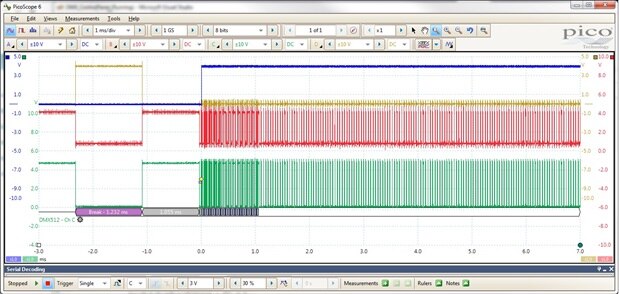

With the same channel assignments as above, I have zoomed into the Mark/Post Mark portion of the waveform, showing the abnormally wide Mark/Post Mark pulses. In this capture the Mark pulse is 1.232 mSec and the Post Mark is 1.055 mSec.  These pulses are way outside the DMX specification, where a typical Mark is 80 uSec, but still being detected by the Arduino Nano.

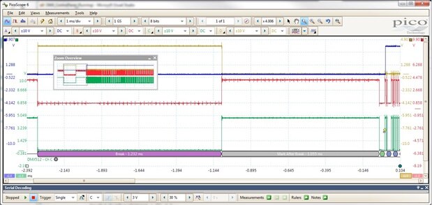

Using the Zoom feature of the PicoScope software, we can see the beginning of the DMX serial stream.  After receiving the first serial byte (i.e. the start code, which is equal to 0), the blue trace can be seen going high, signifying the serial data portion of the DMX data stream.  The remaining frames are actual DMX data, being sent from my control panel software to command a decoder hosting 12 servos and 3 LED channels.
