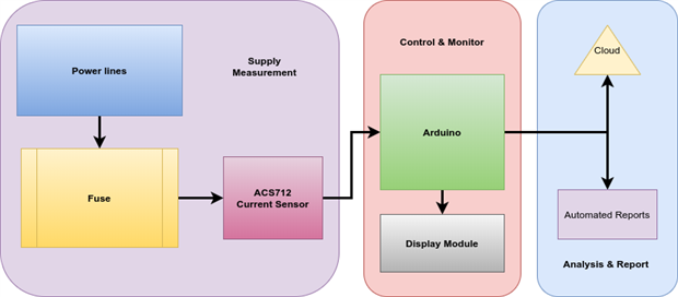

A smart energy monitoring system that will ease the inspection, monitoring, analysis, and fare calculation of energy
First of all, Happy Birthday Project14 and Arduino
In Kerala (India), the energy consumption is monitored and calculated by frequent field visits by technicians from the electricity/energy department for the calculation of energy fare which is a time-consuming task as there will be thousands of houses in the area. There is no provision to check or analyse the individual energy consumption of houses in a period of time nor to create a report of energy flow in a certain area. This is not just the case of Kerala, but throughout many places in the world.
This project involves the development of a smart energy monitoring system that will ease the inspection, monitoring, analysis, and fare calculation of energy. The system will additionally allow generating user specific or area specific charts and reports to analyse the energy consumption and energy flow. The system module which will be given a unique user code to identify the particular housing unit where the energy consumption has to be measured. The power consumption will be monitored with the help of a current sensor interfaced to an Arduino board using Analog connection. The energy consumption data and the unique user code of the user can be uploaded to a dedicated cloud service at real-time. The data from the cloud will be accessed and analysed by the energy department to calculate individual energy consumption, generate individual and collective energy charts, generate energy reports and for detailed energy inspection. An LCD display module can be integrated into the system to display real-time energy measurement values. The system will work independently if a portable power source such as dry cell battery or Li-Po battery is attached.

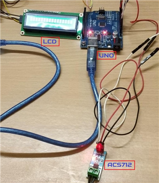

The components that are used in the project are:
  • MKR Zero / Arduino Uno
  • ACS712 Current sensor
  • LCD Module [I2C version preferred]

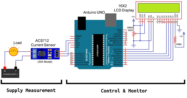

The hardware connection diagram for prototype is as follows:

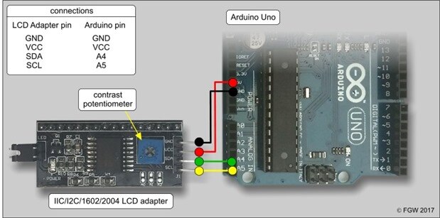

Use the below connection if you prefer an I2C LCD module.

Power from the AC mains is drawn and passed through a the current sensor which is integrated into the household circuit. The AC current passing through the load is sensed by the current sensor module (ACS712) and the output data from the sensor is fed to the analog pin (A0) of the Arduino UNO. Once the analog input is received by Arduino, the measurement of power/energy is inside the Arduino sketch. The calculated power and energy is then displayed on the LCD display module.

The below figure depicts the prototype under testing.
