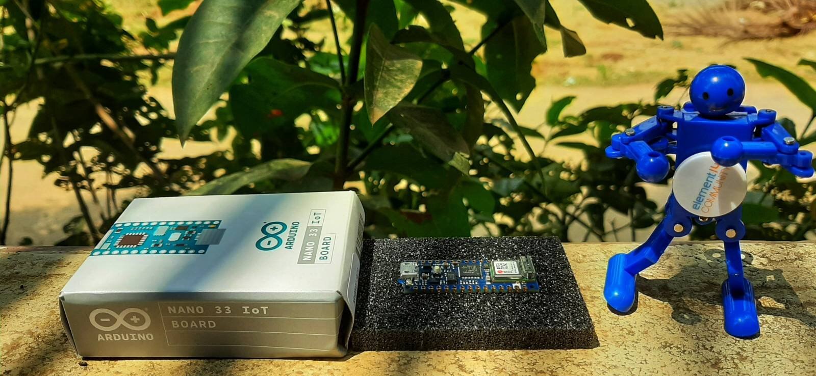

     When I wanted to build a project for the NanoRama Project14 contest, FlappyRama wasn't my initial idea to build upon. But with unprecedented turn of events, I ended up with FlappyRama a fun little game which everyone can build on their own and have fun.
     Due to lock down in our country, I was confined to my home town away from my workplace, 3D printer and all my electronics. So all I had was an Arduino Nano 33 IoT board and a personal computer with me for doing a project. Adding to the limitation, Arduino Nano 33 IoT has only 6-axis IMU LSM6DS3 and no other sensors like temperature, or humidity to build something like a cool IoT Dashboard.
     I started working on building a gesture detection powered by Azure ML with Arduino Nano 33 IoT, but time was a constraint and it took me longer than I expected. Then this idea popped up, FlappyRama. It is a Flappy Bird like game developed in Processing. Normally Flappy Bird game takes mouse click as an input. So instead of that, I replaced it with Arduino Nano 33 IoT board and its 6-axis IMU. Read more details on the project in the following section.
     Thanks to tariq.ahmad and Element14 Community team for sending me an Arduino and also for the deadline extension till May 18th - click here.
