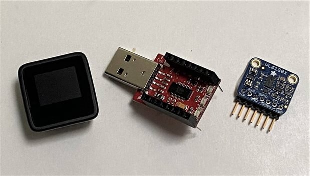

I've been wanting to try setting the focal distance of my laser engraver/cutter using a micro-LIDAR TOF (time-of-flight) sensor.  The NanoRama competition seemed to be suited for such a project.  I wasn't lucky enough to get selected for one of the free Nano boards, so I'm using a Sparkfun MicroView module that I had in my parts bin.  The CNC/Laser controller that I need to interface to is an Arduino based GRBL controller - so Arduinos all around image.

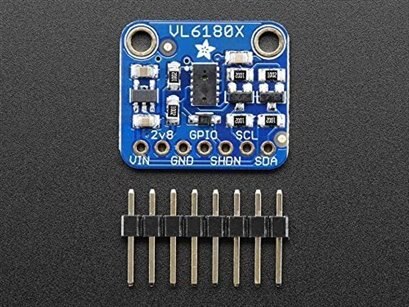

I have a couple of Time of Flight Micro-LIDAR distance sensor breakout boards that I've been playing with - one for the VL53L0X and one for the VL6180X.  The primary difference between the sensors is the measurement range.  The VL53L0X is optimized for 1 meter and the VL6180X is optimized for 100 mm.  Both are interfaced using I2C and both have a minimum resolution of 1 mm.  The focal length of my current laser setup is about 40 mm so I'm going to use the VL6180X for this application.  I'd like to get sub mm focusing accuracy and I've seen a project that is using averaging to get sub mm resolution and accuracy around +/- 0.2 mm.  From empirical experiments I could probably tolerate +/- 1 mm focus error on my laser.
Adafruit VL6180X Breakout
I am going to use the Adafruit VL6180X breakout board: adafruit-vl6180x-time-of-flight-micro-lidar-distance-sensor-breakout.  There are two versions of this board.  The latest one has STEMMA QT connectors but I am using the original one without the connectors.  The sensor itself uses 2.8V so there is an onboard voltage regulator.  That makes this board usable with either 3.3V or 5V microcontrollers.  The I2C lines are pulled up to whatever voltage is on VIN.  That makes it easy to interface to any flavor of Arduino.  The VL6180X also has an ambient light sensor but I haven't thought about using that.
Sparkfun MicroView Module
The MicroView is a small (1"x1") Arduino compatible module with a 64x48 pixel OLED display: Sparkfun Microview - OLED Arduino Module.  The module only has 16 pins so there are only 6 digital and 6 analog pins available but I'll only need 2 for I2C and one to communicate focal point to the GRBL controller.  The module does not have a USB programming interface so you either have to use an FTDI USB interface or I have the USB programmer that was designed for it: Sparkfun Microview - USB Programmer.  I'll be using the Arduino IDE to do the programming.
Here are the MicroView, USB Programmer and VL6180X (with right angle header) parts that I'm using.

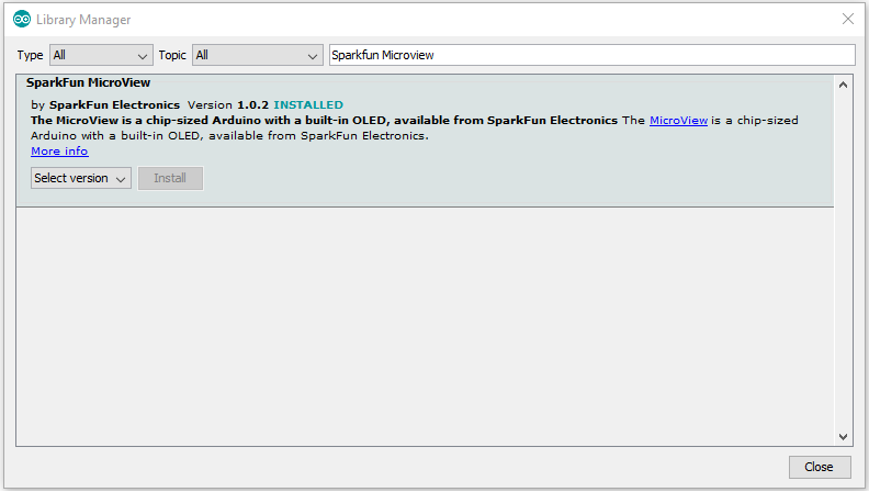

The MicroView firmware programming settings are the same as the Arduino Uno so that's used as the board type.  It's been so long since I've done anything significant with an Uno that I'd forgotten how little memory there is available - 32KB of Flash and 2KB of SRAM.  I'll need to be careful not to try to do anything fancy....  Gotten spoiled with the ESPs and the newer Arduinos.
The MicroView library can be installed directly for the Library Manager:

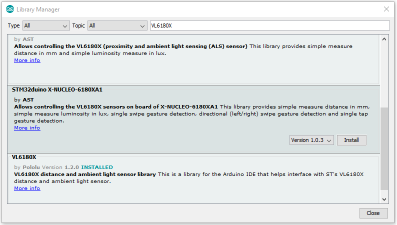

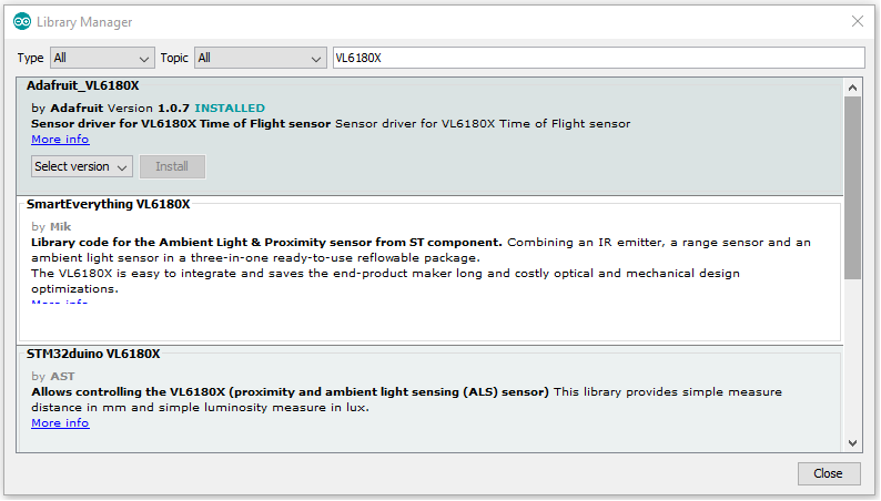

There are muliple VL6180X libraries available.  I've had problems using the Adafruit library with an ESP8266 but I do have that installed.
I also have the Pololu library installed - it has an example program that uses averaging that I'm interested in - and it works with the ESP8266.

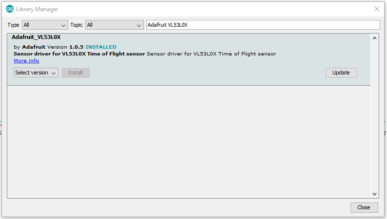

And because I wanted to try it - I installed the Adafruit VL53L0X library.  This one works with the ESP8266 also.
