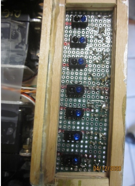

I had several old homemade robots that were out of date and needing maintenance.
Thanks to NanoRama, the old robots have a new Arduino Nano brain and renewed life.
The Arduino Nano has analog IO which can be used to read the voltage across a IR phototransistor to determine how much IR is reflected off a white sheet of paper.
The white paper is a good reflector, black is a poor reflector of IR light.
That is how line following works in a nutshell.
Reading the phototransistor voltage analog allows the software to determine hysteresis and filtering of the detection signal, and also use a PID if wanting to ride on the edge of a black line.
The Star Trek style nacelle IO card was originally built for a Parallax BoEbot. This card has a bunch of LEDS, which the higher power ones use opto couplers or SSRs to drive them. This card also has an IR receiver wired.
When using the Arduino Nano provided by this contest, the new bootloader in the Arduino IDE needs selected.
Without further adieu, here are photos, diagrams and code for the project.
In my operation description, item 4 says select IR remote control or line follow per HW switch. That was simplified, just press ON on the remote controller to activate IR remote control mode.
Please reply to me if interested in the detailed schematics.

    The analog input version of the homebrew TCTR5000 line follower board has hysterysis in the code: // this converts the analog value to a bit value with hysterysis and stores that result in another array…

    The "digital" version of the homebrew TCTR5000 line follower board has hardware hysterysis inherent to the multiplexer IC.
    Looking closely at the TCTR5000 line follower card, it is mounted on top of a balsa wood "box".  The box was dimensioned so the IR sensor is near the optimium distance for reception, then shims of known dimensions are added to the bottom edge to measure effect of distance.
    Nothing was done with precision equipment.  There are so many other uncontrollable variables, getting close is good enough for a demonstration robot.

    Hi Dubbie - The IR detectors are  TCRT5000s.
    Spec sheet:   https://components101.com/sites/default/files/component_datasheet/TCRT5000%20Datasheet.pdf
    I believe the original application of these were in copy machines.
    These phototransistors are myopic - their optimium range is 2mm from a surface. I did a Design of Experiment myself, to find sweet spots.
    I've built the line detection cards a couple different ways. One pictured is all analog, 8 inputs .
    I built a second digital version that also has a multiplexer, which does the hysterysis and A/D conversion. The multiplexer one allows to add multiple 8 input cards, and only adds one more DI point for each card.
    Altho I'm proud of my line follower card designs, since everyone usually just buys their line following sensors, but my design arent high performing.
    No matter how much physical shielding is used, bright sunlight can get in them, and swamp out the IR , causing control errors.
    They also have problems with sodium lights, commonly used in gyms.
    The better IR line follow sensor designs use a 40 kHz carrier , like the IR receivers do, to avoid errors from sunlight.
    The Parallax BoEBot line follower sensors do not look for level change directly, the photo transistor shorts a capacitor, and the software decides if the signal is high or low based on charging time ( a discrete low pass filter) of that cap.
