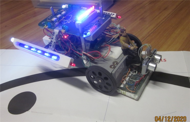

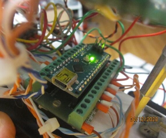

I had several old homemade robots that were out of date and needing maintenance.
Thanks to NanoRama, the old robots have a new Arduino Nano brain and renewed life.

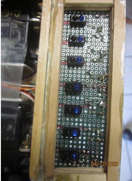

The Arduino Nano has analog IO which can be used to read the voltage across a IR phototransistor to determine how much IR is reflected off a white sheet of paper.
The white paper is a good reflector, black is a poor reflector of IR light.
That is how line following works in a nutshell.
Reading the phototransistor voltage analog allows the software to determine hysteresis and filtering of the detection signal, and also use a PID if wanting to ride on the edge of a black line.

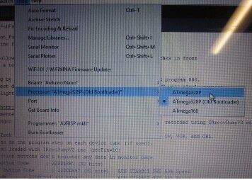

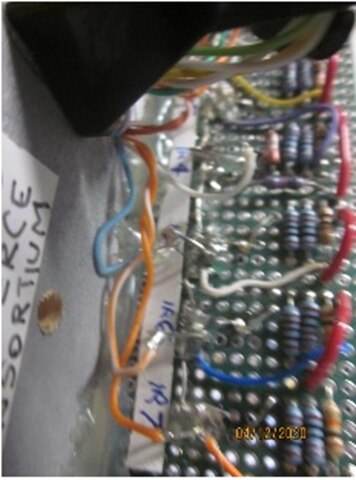

The Star Trek style nacelle IO card was originally built for a Parallax BoEbot. This card has a bunch of LEDS, which the higher power ones use opto couplers or SSRs to drive them. This card also has an IR receiver wired.
When using the Arduino Nano provided by this contest, the new bootloader in the Arduino IDE needs selected.
Without further adieu, here are photos, diagrams and code for the project.

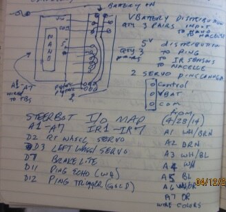

In my operation description, item 4 says select IR remote control or line follow per HW switch. That was simplified, just press ON on the remote controller to activate IR remote control mode.
Please reply to me if interested in the detailed schematics.

  • robogary
    robogary over 6 years ago in reply to ankur608 +4
    Thank you. I would've videoed it at warp speed , but it goes so fast, the camera frame rate sweep misses it. I'm more of a hardware systems guy, coding isnt one of my strong points It tends to be brute…
  • robogary
    robogary over 6 years ago in reply to dubbie +3
    The analog input version of the homebrew TCTR5000 line follower board has hysterysis in the code: // this converts the analog value to a bit value with hysterysis and stores that result in another array…

  • robogary
    Hi Dubbie - This is a D.O.E. table from the IR phototransistor measurements. The experiment is to find the best optimal height of the TCTR5000 sensor "box" above the track , to mount the sensor.
    The best calibration is 3 Popsicle sticks.
    When IR sensor box was mounted to the robot, 3 popscicle sticks were placed underneath it to hold it up. Once mounted I pulled out the popsicle sticks.
    I guess I should enter this in "Cool Tools" for popsicle stick calibration.
