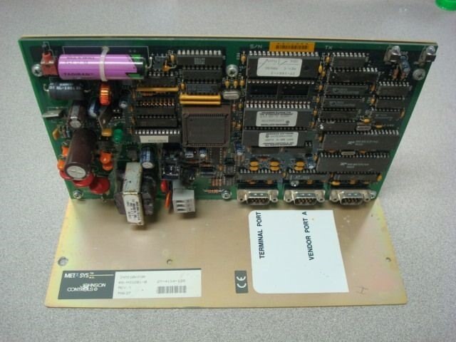

Do you remember the old good piece of hardware like this one?
where the only interface was a serial connection and menus were built using VT100 escape sequences?

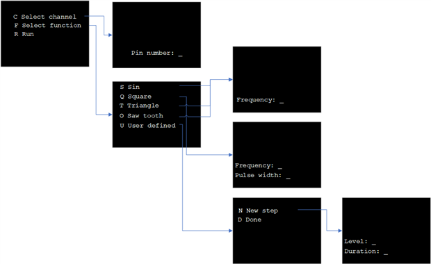

Well, I want to build an interface like that: I will configure the function generator by means of a VT100 terminal interface
Luckily, there is a library that wraps VT100 escape sequences into a set of handy functions. This is the starting point to build a menu-based UI

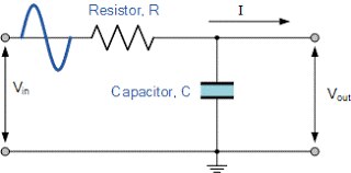

I am going to use a passive filter, because I expect to have loads that takes less than 10mA. So the circuit for the low-pass filter is very simple:
The cut-off frequency is given by the formula
With R = 6,8 kOhm and C = 2.2 uF, the cut-off frequency is 10,64 Hz, which is good

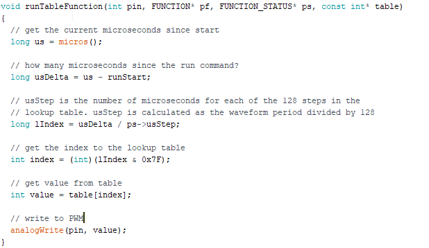

Back to the code, the analog waveforms are generated using lookup tables generated using this site
https://www.daycounter.com/Calculators/
Each table has 128 samples. Every main cycle, I perform the following code
I should evaluate whether to use a linear interpolation between two table’s point to get a better accuracy
For the user-defined functions, we can enter a sequence of high and low and the duration of each step
