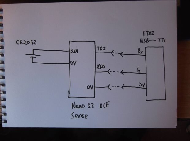

The circuit for the Nano Rocket is simplicity itself, due to the accelerometer sensor being already integrated into the Nano 33 BLE Sense PCB, consisting of just the battery, the Nano sense and the connections to the TTL to USB serial convertor, see circuit diagram below:
I soldered the battery holder directly to the Nano Sense rather than using any form of connectors; first to avoid any intermittent power connections when the rocket was launched or landed and secondly, to minimise the issue of storing wires inside the case. There is an ON/OFF switch on the battery holder (which I have accidentally omitted from the circuit diagram) The connections to the FTDI USB to TTL convertor PCB are made using Dupont plugs with only short wires, again to minimise wire storage inside the case. I have now realised that I should have used Dupont sockets rather than plugs as the pins are free to move about inside the case and could easily cause temporary electrical connections to other parts of the PCB during flight. Hopefully, this will not be a problem.

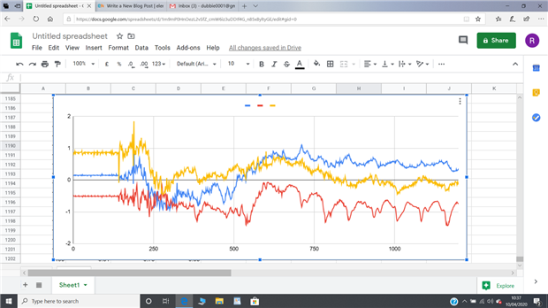

Below is the data captured from my first throw. I'm not entirely sure what it shows so I will have to spend some time thinking about the data and repeating and refining the experimental process. However, my initial thoughts are that the first section where the data is fairly constant is when the rocket was flat on the step as I was getting it started. The next 'jumble' (that's a technical term) is when I was putting the lid on the case and then the lull and 'hump' (more technical terms) are when I drew back my arm and launched the rocket into space. After the hump should be when the rocket hit the ground but the de-acceleration spikes do not seem large enough, plus, ,I'm not sure what the pulsing in the bottom red trace is caused by. The data is for a period of about 13 seconds.
I will have to think about how to process and display the data from the accelerometer (x,y,z) to try and come up with a single measure of acceleration as the rocket is launched, flying and hitting the ground. Anybody any ideas?

    jw0752 over 6 years ago +4
    Hi Dubbie, I liked your experiment. If I understand the physics of your experiment your rocket should be under 1 G as it sits on the table. The acceleration that you give to it as you throw it should show…
  • abrain
    abrain over 6 years ago +3
    Nice one Dubbie! One thing that might be interesting on the accelerometer data is to start off with looking at the magnitude of it all - something like the following in Excel: =SQRT(POW(A1,2)+POW(B1,2…
    dubbie over 6 years ago in reply to abrain +3
    Abrain, I did think about finding the absolute magnitude but I wasn't sure it would mean anything, for example if the rocket was spinning,, but I will have to go and give it a try. I'll al so have to go…
    My suggestion is to start by making it simpler by first throwing it vertically up in the air with minimal trajectory. The data should then display the overarching effect of gravity as well as spin characteristics (depending on how you threw the device). You should measure time of travel separately. Also take multiple samples.
    Then move to throwing it horizontally from a defined height. Here measure distance travelled before landing and time of travel etc.
    Then finally throwing it in a trajectory as you've demonstrated.
    Hopefully then you can start to paint a picture of acceleration in 3D.
