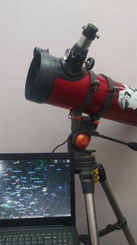

Thanks Element14 and Tariq Ahmad for sending out Nano BLE Sense Board and a bunch of cool stickers.

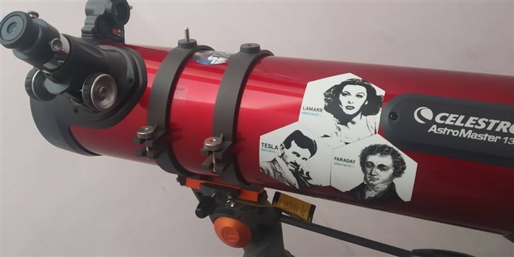

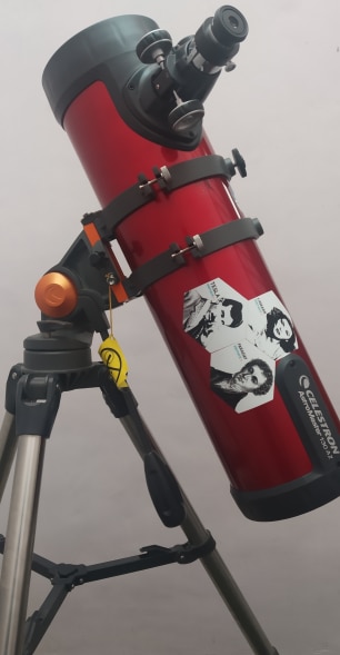

In this project build, I have tried to add a PT(PushTo) support (utilizing the onboard Sensors of BLESense board) for Celestron Astromaster 130AZ, that I prefer for (Star-gazing) pastime. Moreover, the scope... interfaces with Stellarium(OpenSource Planetarium Software) that renders realistic projection of the night-sky in real time. Do check out the web-version.
This project has been deeply inspired from StellarScope

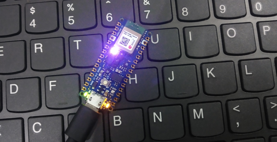

    digitalWrite(22, LOW);  // Reverse-logic; //turns LED ON
    digitalWrite(23, LOW);  // indicate successful connection

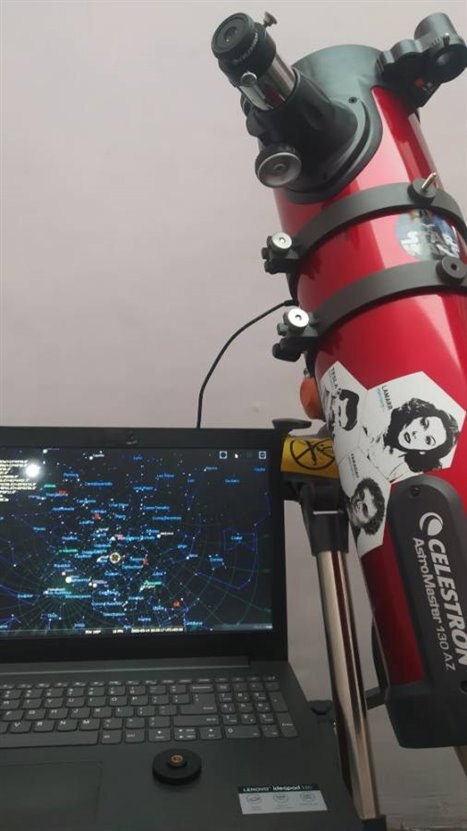

While, minor sensor drifts were observed while getting the raw roll & pitch values. The ideal spot to mount Nano was found to be the ABS rotary block on tri-pod frontend. Hence, slightly avoiding (not completely) the ferrous distortion-effect on Magnetometer readings.

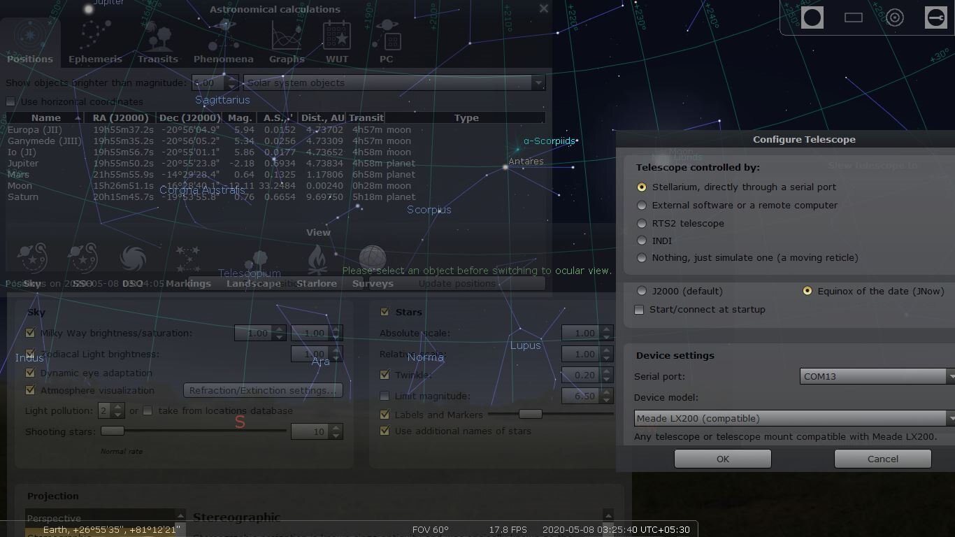

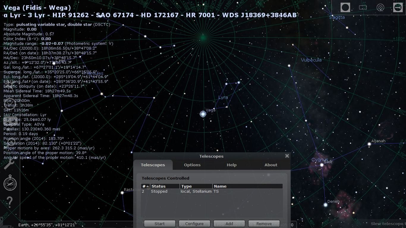

Interfacing with Stellarium:

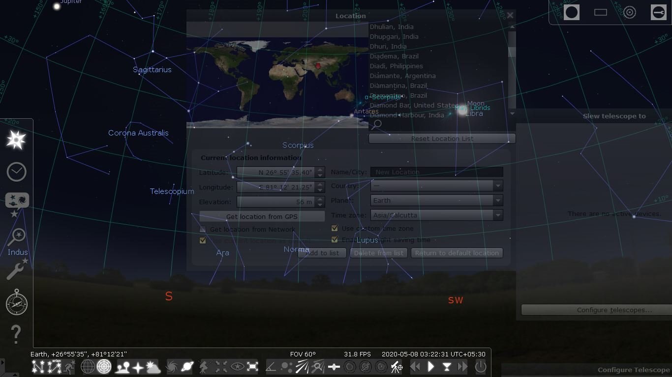

After compiling and uploading the code, get ready to connect your scope to Stellarium through Meade-LX200 Serial Protocol.
Punch in your GPS co-ords. and Elevation(can be obtained from on-board barometer; available on BLESense33), familiarize yourself with available controls and features, hence after create and configure the telescope plugin with the board Serial Port. Click on connect. Wait and searchout your Scope-marker in the Galactic-View ..may the Force be with you(to find little green men).

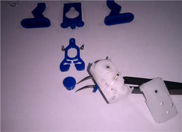

Thanks(again) Tariq and Element14 for also sending out the Element14 Bot(passive automata).
Recently, I picked upon some of the quite interesting blogs posted under 'Restoration&Repair', and a few of them inspired myself for (unwillingly) performing un-official teardown of the Bot. Here is what I found;

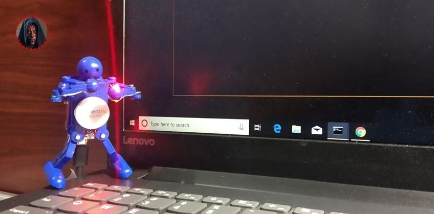

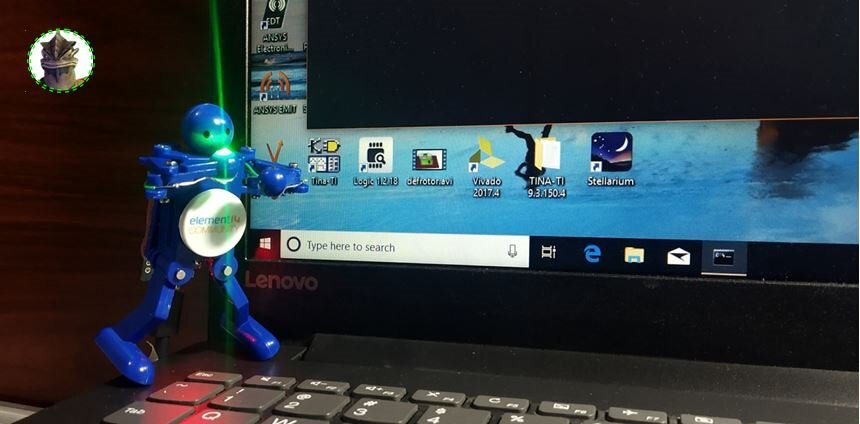

Training to become a BadBot...in three babysteps;
1) Adding an Arduino ProMicro as a (backpack),
2) Wire-in red and green LED and
3) Uploading a rogue(BadUSB) script.
                        Double wielded lightsaber effect [T: PongKrell ; B: DarthMaul]
The below arduino code executes a local batch file (video), or can directly open a specific URL (code), based on HID class. For instance, I have hard-coded the following links for safe execution on (users) default web browser as well has the capability to launch specific links in different browsers.
- Rise of the Jedi [Rey vs Ren] streamed on youtube.
- Project14 homepage.
- Element14 community webpage.
- TheBlackvault.com
(execution in random-order)
Bad Bot(2.0) Code:
#include <Keyboard.h>
void setup()
  pinMode(9, OUTPUT);     // Red_LED::during payload delivery
  pinMode(10, OUTPUT);    // Green_LED::payload deployment
  // Begining the stream
  Keyboard.begin();
  //digitalWrite(9, HIGH);
  //delay(100);
  //digitalWrite(9, LOW);
  //delay(100);
  // Waiting 500ms for init
  delay(500);
  delay(600);
  // Running on Linux
  Keyboard.press(KEY_LEFT_ALT);
  Keyboard.press(KEY_F2);
  Keyboard.releaseAll();
  delay(200);
  // Running on MacOS
  Keyboard.press(KEY_LEFT_GUI);
  Keyboard.press(' ');
  delay(200);
  // Though running on Windows, the input language changes;(Key:Press;;3 times)
  delay(200);
  delay(200);
  Keyboard.press(114);
  delay(200);
  // On another OS, this can result "   r". // Performing Backspace 4 times.
  for(int i = 0; i < 4; i++) {
    typeKey(KEY_DELETE);
  // Get in the URL, I chose Project14.
  Keyboard.print("https://www.element14.com/community/community/project14"); // can be any of the ducky-scripts.
  //Keyboard.print("https://www.element14.com/community/");
  //Keyboard.print("https://www.theblackvault.com/casefiles/");
  //Keyboard.print("https://www.theblackvault.com/");
  //Keyboard.print("Def.bat"); //Pre-payload prep.
  typeKey(KEY_RETURN);
  digitalWrite(10, HIGH);
void typeKey(int key)
  Keyboard.press(key);
  delay(50);
  Keyboard.release(key);
void loop() {}
Official Rubber-Ducky Payloads[Hak5]: https://github.com/hak5darren/USB-Rubber-Ducky/wiki/Payloads
Official WebOpenerCode[URL@atime]:
DELAY 600
REM Linux run dialog
ALT F2
DELAY 200
REM Mac OS run dialog
GUI SPACE
DELAY 200
REM On Windows this changes the input language, so press 3 times
GUI SPACE
DELAY 200
GUI SPACE
DELAY 200
GUI r
DELAY 200
REM On another OS, this could have typed " r". Backspace 4 times.
DELETE
REPEAT 4
REM Type in URL and open page!
STRING http://hak5.com/
ENTER
Infiltration..:
