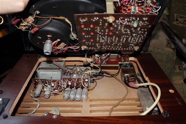

Back in 1984, I bought a very modern vinyl record player, which was at that time very modern and very expensive to work in the USSR.
It was cool at the time.
But time had forgotten about it and i've highlighted a moment I forgot about,  but #COVID-19 freed up days for listening to old music collections.
But this miracle was no longer a part of the USSR ...
It's ability had been virtually reduced, you can see take a look at the electronics that were used at the time:
To begin with, "Soviet" electronics were discarded.
There is a 3-phase motor, an electromagnetic toner double, a vintage 220 V switch and control sensors with old conscious headlights.

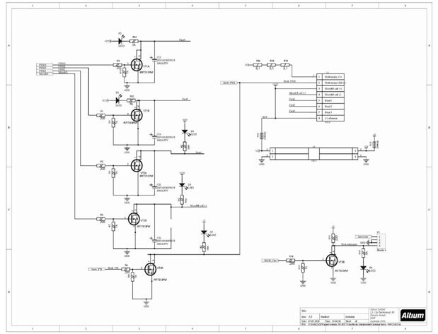

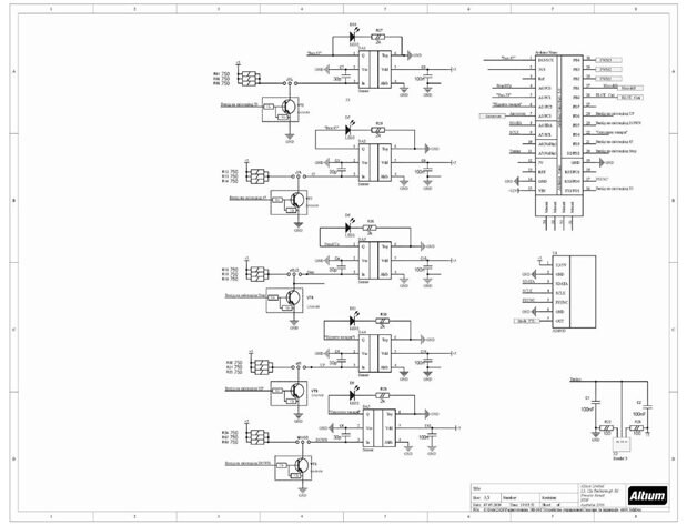

So I designed a special shield operated by ARDUINO NANO.

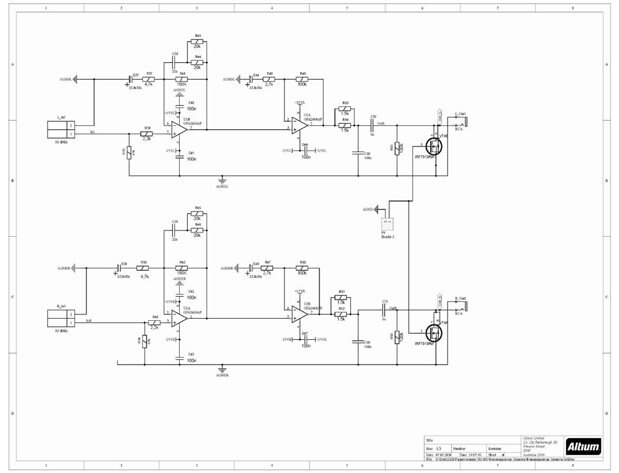

I found a project that helped support the amplifier in: Elliott Sound

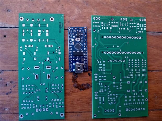

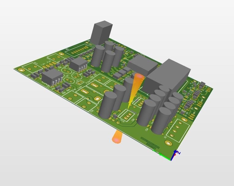

A printed circuit board (size 100x100 mm) was something to be done as well:
Here is the sketch for the Arduino Nano:

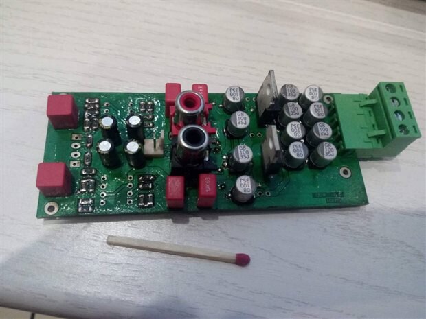

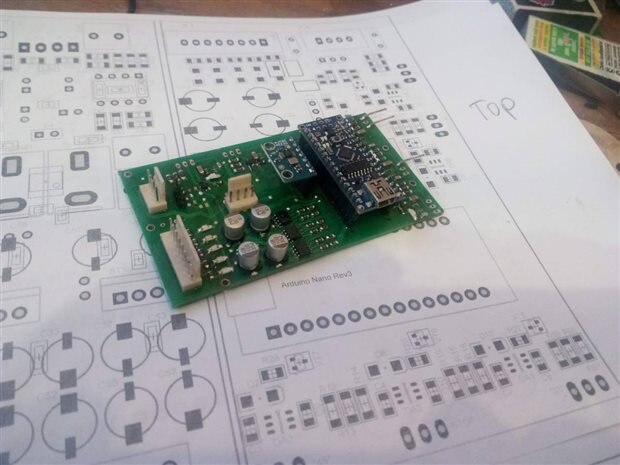

Special PCB's for pre-amplifier (left) and player control  (right). In center ARDUINO Nano Rev3.0.
Partly assembled vinyl record player control shield:
Pre- amplifier without chip`s for testing on-board power stabilizer&filter:
