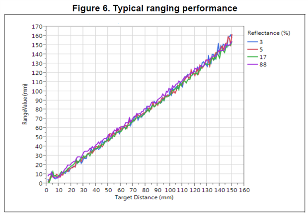

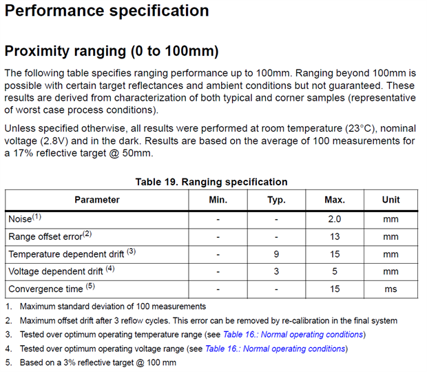

The resolution of the VL6180X is 1 mm and the spec measurement noise is 2.0 mm over 100 measurements.  I'm hoping to be able to get to +/- 0.5 mm repeatability using averaging.
From the spec it looks like it could be challenging:
The optimum operating temperature range is  -10 to 60 C and my environment is probably +/- 2 C so hopefully I won't see that much drift and I'm also hoping that the onboard regulator is better than the 2.8V +/- 100 mV spec.

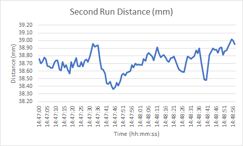

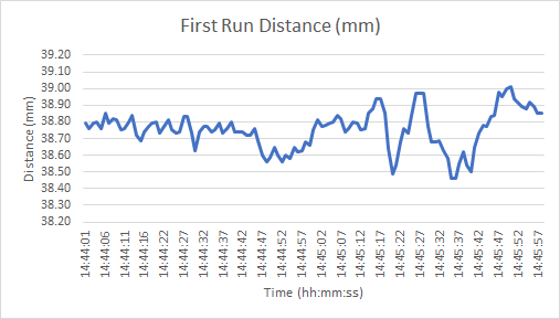

Here is my first quick check.  I used the my calibration block to adjust the laser lens to 39 mm.  Then I did a couple of 2 minute data runs (100 samples each).  I have an approximate offset in the software to get the measured value near 39 mm.
A short video of the MicroView display:
First run                                        Second run
image     image
Plots
The run averages are pretty close.  I suspect that some of the lower frequency, larger excursion noise is due to the fact that I was in close proximity setting up my phone to take the video.  This could be due to ambient light or temperature fluctuations or maybe both.  Now that I've sanity checked the setup I need to spend some time taking a clean set of data.  The initial data does give me hope that I can meet +/- 0.5 mm.  Maybe I need to average the averages image.

    It is interesting to see the average data and it's fluctuating so much, especially over time. It matches the values I have obtained in the past with the VL53L0X that even with significant averaging, the range value still varies more than you would expect, if the errors were purely random. So it is probable that some systematic errors are intruding such as temperature and possibly light levels as you have indicated. I am looking forwarding to seeing more of your results as you control these parameters.
    Dubbie
