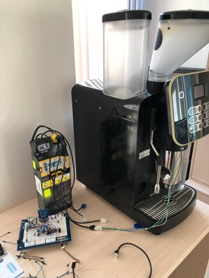

It was always interested in a device talking with another device, especially when you start  seeing responses back. Talking to vending machine using MDB protocol is one of that amazing adventures.
My goal is to prototype a simple payment system using RFID tags for paying for a vend. Payment policy can be extend and customised in many ways including using the same RFID tag across many machines and limiting the vends in day basis by storing information inside the tag.
The Setup
Test board, Changegiver, MDB Machine. Beside test board can be connected to the machine directly. Currently we are connected via MDB Loom cable.

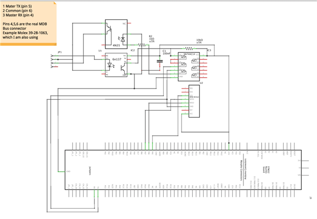

Interfacing MDB
In order to talk with vending machine, there must be interfacing part which will receive and send data via mdb bus.
1. 1x 6N137
2. 1x4N35( or PC133)
3. 1x 0.1mf capacitor
4. 1x 10k resistor
5. 1x 1k resistor
6. 1x C114 digital npn transistor
7. 1x CD74HC14 (Schmitt Trigger)
Schematic
Notes:
1. 4N35, can be replaced with PC113

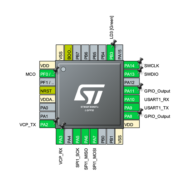

2. I am using Nucleo STM32F303K8
SMT32CubeMX Layout

We show ourself into MDB bus like Cashless Device with address 10H. In order to communicated with MDB master there must be implemented couple of commands. Main drama here is communication is with 9bit UART.
MDB is using parity bit like a mod bit to show if the value is address or data. I tried various approaches but one which works in my case is using STM32 UART configured on 9bit word length, without parity.

Moment of Truth
We have one selection(Hot Chocolate) which is paid(one with button switched of). When  the RFID tag is reader, we respond back with amount of 2.0(can be any currency) credits.
User selects vend, machine request approval from us. We say 'yes' and vend is made.
Finally I can enjoy cup of Hot Chocolate.
