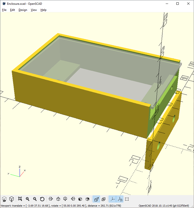

It's all very well deciding that the PCB itself will be the front panel for my lock, but it will still need an enclosure. I decided that I'd tackle the simplest lock first - and that was my garage door. The reason for this is that all I have to do is simulate a button press, At worst a relay across the existing push-button would do. Of course, that still leaves the issue of how to mount it outside the garage. Once again, this is probably the simplest use case. I can go with a 3D printer box and route the cable straight through the single-skin brickwork of my garage.
Being a coder at heart, my tool of choice for 3D modelling is OpenSCAD. It's very different from the more artistic modelling tools, but particularly suits a parametric design. I've tuned my workflow over the years and this is what I find works for me:
  • Make sure anything I think I might change is a variable. Depth of the enclosure, PCB thickness, clearances - all of these are easy to change after a bit of trial and error.
  • Use Visual Studio Code as an editor and set OpenSCAD to auto-preview whenever it is saved.
  • Include things like the PCB itself as a component. It will never be printed, but it helps visualize what;s going on.
  • Model the pieces (e.g. the main upper bit and the lower) in-place. Render them together and comment out all but one when doing a final export
<Here's the code for my enclosure. Notice that the PCB module is prefixed with %. This makes it partially transparent. Notice also that the lower is shifted with one (optional) line so I can visualise the whole thing.
$fn=50;
pcbThick = 1.65;
pcbX = 60;
pcbY = 100;
pcbZ = 1;
fit = .2;
wallThick = 3;
wallSlot=1;
wallInner = wallThick-wallSlot;
cutY = wallThick+1;
boxX = pcbX + 2* wallInner;
boxY = pcbY + 2* wallInner;
boxZ = 25;
fixZ = boxZ-12;
fixY = 7;
module main() {
    difference() {
        cube([boxX, boxY, boxZ]);
        translate([wallThick, wallThick+fixY, wallThick])
            cube([boxX-2*wallThick, boxY-2*wallThick-fixY, boxZ]);
        translate([wallThick, wallThick, fixZ])
            cube([boxX-2*wallThick, boxY-2*wallThick, boxZ]);
        slot();
        cable();
        mounting();
        translate([15,-0.1,10]) m3screw();
        translate([boxX-15,-0.1,10]) m3screw();
module upper() {
    difference() {
        main();
        translate ([-1,-1,-1]) cube([boxX+2, cutY+1, boxZ+2]);
module fixture() {
    cube([boxX,cutY+fixY,fixZ]);
module m3screw() {
    rotate([-90,0,0]) {
        cylinder(r=3,h=2);
        cylinder(r=1.75,h=cutY+.1);
        cylinder(r=1.4,h=cutY+fixY+1);
module cable() {
    cableY=62;
    translate([wallThick, (boxY-cableY)/2, -1])
            cube([boxX-2*wallThick,cableY, boxZ]);
module mounting() {
    translate([boxX/2,boxY/2+35,-1]) cylinder(r=2,h=boxZ);
    translate([boxX/2,boxY/2-35,-1]) cylinder(r=2,h=boxZ);
module lower() {
    translate([0,0,-boxZ-1]) { // Move so you can see both
        difference() {
            main();
            translate ([-1,cutY,-1]) cube([boxX+2, boxY, boxZ+2]);
module PCB() {
    translate([wallInner+fit, wallInner+fit,boxZ-pcbZ-pcbThick])
        cube([pcbX,pcbY,pcbThick]);
module slot() {
       minkowski() {
            translate([0,0,-fit/2]) cylinder(r=fit, h=fit);
            PCB();
upper();
lower();
%PCB();

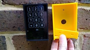

It took a few iterations. I didn't have enough clearance for the connections to the bottom of the PCB. The PCB was a bit too snug of a fit first time round, and I decided to have the back fairly open rather than just a hole for the cable. I prototyped in a yellow filament as I tend to use up too much of the black. I was almost tempted to leave it in yellow to make it easier to find in the dark, but I'm glad I went with the black in the end.
I didn't make a firm decision as to how I'd connect to the board when designing it. I created some SMT pads on a 0.05" spacing. Initially I soldered on a single row of through-hole header pins that I'd bent at an angle to make them surface mount. I worked pretty well, but I suspected that a attaching a female header a few times might left the pads. Also it stuck out a bit too much and fouled the enclosure I'd printed. I decided to make it lower profile by soldering wires directly. I used a bit of hot glue for strain relief - especially when sliding into the enclosure from below. I can detach the PCB from the rest of the circuit with a Molex microfit connector that pushed through the hole in the garage wall.imageimage
All in all, I'm pretty happy how it turned out. I was tempted to use a resin printer to get a nicer finish, but I've found from experience that it can be hard to get nice flat shapes printed without warping, and I think the end result is good enough - especially as it's hidden round the side of the garage out of view. This was the easiest place to drill through the wall.
