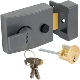

You know how sometimes you're drawn to the cooler but perhaps less practical option? Well, I think this is one of those times. Whilst looking at strike plates, I saw a nightlatch that looked reasonably chunky. I thought about a small gearmotor I had in the parts box. An idea formed in my head. Would it be possible to hide a motor an limit switches inside the lock itself? I had to give it a try. This is the exact model of lock I purchased.image

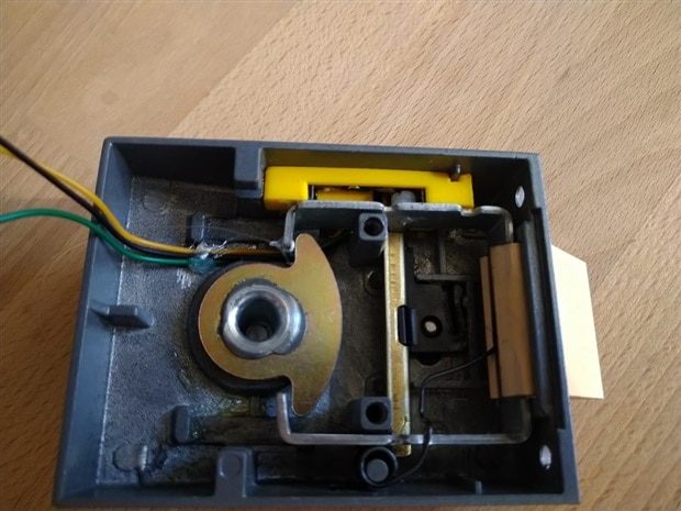

After much dismantling, tinkering, poking with a micrometer, etc. I decided that I thought I'd be able to get some limit switches in there and maybe the motor. Worst case, the motor could got externally with a small cover. The task was on!

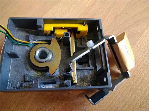

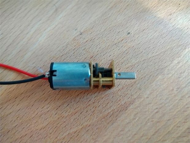

Motor was first. I struggled to find a way to get a cam to pull back the frame on which the lock tang was mounted, so I decided to go the minimum viable product route first of all and mount the motor externally using a thin wire to pull the lock open. I mucked around with various versions of the motor that had different rotational speed. I considered different sizes of wheel to wind the wire round. In the end I went with a medium speed motor and decided that the perfect size would be the diameter of the 4mm shaft itself! All I needed to do was drill a hole through the shaft and feed some wire through.
Was the motor strong enough and fast enough? Yes. Was the wire flexible enough? No. I swapped it out for some fishing line and that seemed to do the trick.

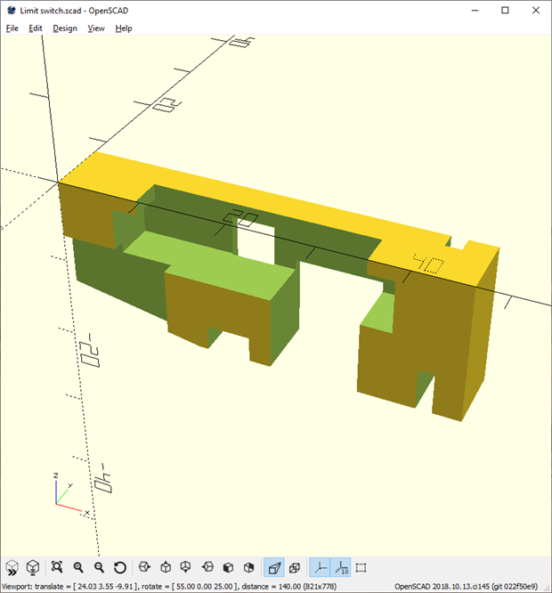

I has some cheap tactile buttons that looked like they would fit in a small space alongside the lock mechanism. I designed a 3D printed bracket to hold them in place... and version 2... and version 3... and version 4. It took a few attempts but I finally managed something that wouldn't foul the lock or the M3 nylon screw I'd added to operate the switches. Once again I used my preferred CAD tool of OpenSCAD.
{gallery} Limit switches
Limit switch bracket: It took a few attempts, but this is what I came up with
Limit switches in place: Note the fishing line to pull back the lock.
Now the lock is reseated

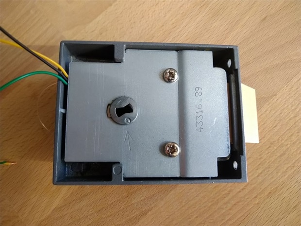

Lock reassembled: You'd never know anyone had been poking around in there!
A small gearmotor: Note the hole drilled in the shaft
