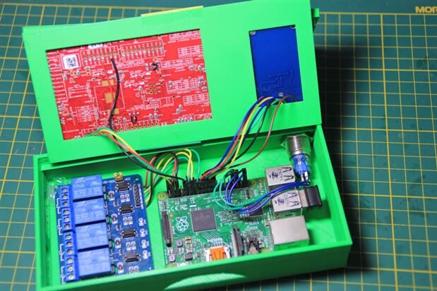

The proposed solution is titled “While You Were Away” because we intend to “sense” when the user is away and optimize consumption in his/her absence. The solution is much more than the simple Motion detector combo because the plan is to implement programmability to the automatic control aspect. The block diagram below shows the various hardware components and their interconnects in the final design.
alt text
The system is composed of 4 major components. The heart of the system is the Cypress PSOC Analog Coprocessor kit which interfaces with five sensors. A Raspberry Pi 2 is used to run OpenHAB Software that provides the GUI as well as other features. An MFRC522 board is used to scan RFID tags and a relay board is used to interface with electrical appliances. The PSOC runs a custom hardware/software design that is provided on github for download. The Analog Coprocessor reads sensors and stores the values in its internal memory. The raspberry pi 2 communicates with the PSOC kits over I2C and retrieves this data. A python script is used to parse the sensor values and then passes them on to an MQTT broker at iot.ecliplse.org . This architecture is chosen to facilitate future customisation where the PSOC may talk to an MSP430(Code provided) and send the data either via USART or other means.
The python script also enables reading of the RFID tag and listens to specific MQTT topics for commands. These commands are used to toggle the relays which in turn controls appliances. The rules engine, GUI and data logging is provided by OpenHAB which is a free home automation software solution. It runs on the Raspberry Pi 2 as well but can be a remote installation as well for IoT like applications.

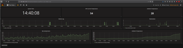

PS: I am still using this project to detect how long I stay at my desk. I use Grafana to visualize the data.
This is all in parallel with the OpenHAB2 system as described above.

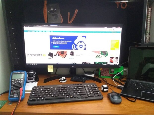

    Excellent project ipv1 I was thinking this kind of setup for a while ... apologies if you had this information already in your post, where have you placed the RFID reader? Like near the door so that it…
  • ipv1
    ipv1 over 7 years ago in reply to dixonselvan +3
    I;ve just added moar pictures! Hope that help. Can you spot the NFC board?

    Excellent project ipv1 I was thinking this kind of setup for a while ... apologies if you had this information already in your post, where have you placed the RFID reader? Like near the door so that it can be easy for anyone exiting the room to show their cards to the reader to make the system aware they are away?
  • ipv1
    I;ve just added moar pictures! image
  • dixonselvan
    dixonselvan over 7 years ago in reply to ipv1
    Thanks, ipv1 I think I should have framed my question like this. Where have you placed or planned to place the entire setup? in your bench or near the door? So that people while exiting can show their tags to the system to let it know they are exiting.
  • ipv1
    Originally, it was at the entrance facing my desk but now it is on my desk facing me. That way I can log the hours I spend working at my desk.
