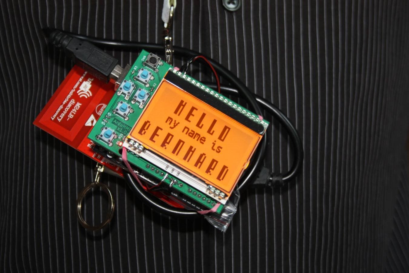

Badges are quite popular but updating their content often requires programming. Although some of them use Bluetooth or WiFi. I want to show that you also can use your smart phone and NFC to update the content.

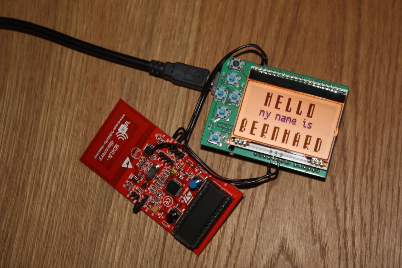

ST M24LR
My badge is heavily based on the ST M24LR (https://www.st.com/en/nfc/m24lr-series-dynamic-nfc-tags.html ). This device is a I2C-Eeprom (similar to the common 24C04) with a NFC interface to read and modify its content or, if you want to see it from the other side, a regular NFC tag with an I2C interface to read and modify its content. It comes in a 8 pin package (I prefer the SO8) and connects like a regular I2C eeprom to the I2C bus. Additionally on two of its pins the antenna has to be connected. The antenna consist only of a few windings on the pcb with a diameter of about 30 mm. Although getting the Antenna to work optimal will be very tricky.
Setup

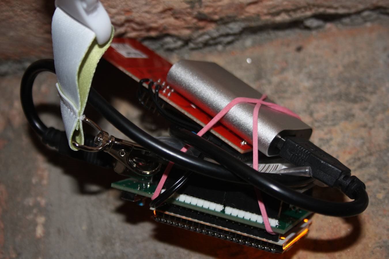

My badge consist of an Arduino Uno, a graphics display, the board with the M24LR and an USB power bank to supply the whole circuit. I think I don't have to say very much about the Arduino Uno.
The display is a EA DOGM128-6 (https://www.lcd-module.com/fileadmin/eng/pdf/grafik/dogm128e.pdf). It is a monochrome LCD with 128 x 64 pixels ant has a ST 7565R controller which can be connected to the SPI port. For my first setup I use a GPIO bit banging interface on the Arduino. The display is connected like in the application notes in the datasheet. Because the display only allows 3.3 V levels I used a level shifter to get them down from the 5 V of the Arduino Uno.
ST has several evaluation boards for the M24LR. The best fit would be the X-NUCLEO-NFC02A1 (https://www.st.com/content/st_com/en/products/ecosystems/stm32-open-development-environment/stm32-nucleo-expansion-board… ) as it could be directly stacked with the Arduinos. Although its onboard connection of IOREF with +3V3 is a bit tricky with the Arduino Uno. I only had a M24LR-Discovery (https://www.st.com/en/evaluation-tools/m24lr-discovery.html ) at hand. So I took this one, cut a few traces on the board and connected it directly to my Arduino with a few wires.
The power bank is any swag power bank.
Nevertheless the whole setup with the power bank is a little bit tricky and crooked.

If you want to modify the string you need a smartphone with NFC and the ST25 NFC Tap app (https://play.google.com/store/apps/details?id=com.st.st25nfc&hl=en_US ). After you place your phone over the NFC antenna you can change the NDEF text tag. After the next reboot of the Arduino Uno the text is displayed on the display. I will explain the app with more details in my next blog post.
