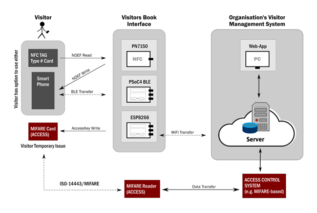

The new electronic Visitor's Sign-In interface is made up of three key modules:
  1. An NXP NFC PN7150 Controller - this provides three tasks:
    1. Reads NDEF messages from NFC Tags
    2. Writes NDEF text type messages to NFC enabled phones
    3. Writes Access Codes to MIFARE cards (for purpose of a pseudo access control system)
  2. A Cypress PSoc 4 BLE module - this provides one task:
    1. a secure means of connecting with an App on a smart-phone to transfer information
  3. An ESP8266 WiFi module - this provides one task:
    1. a wireless means of connecting to an Office LAN for the purposes of communicating with a back-end server

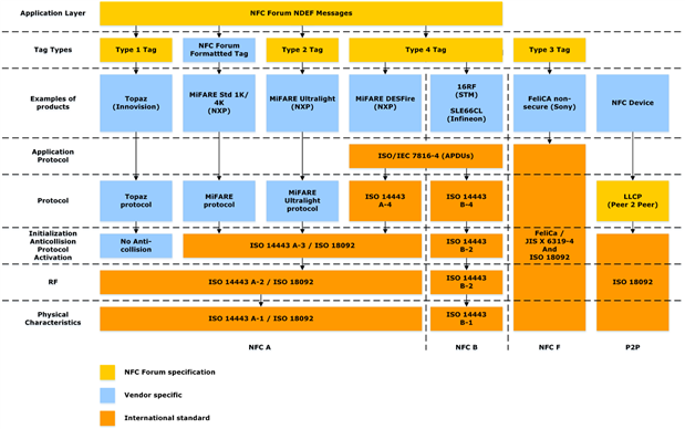

Image Source attributed to: By Erik Hubers - Own work, CC BY-SA 4.0, https://commons.wikimedia.org/w/index.php?curid=37867764
As can be seen in the above diagram by Erik Hubers, the creation and handling of NDEF messages is all in the Application Layer and NDEF messages can only be stored on NFC tags or cards that are formatted to store these formats. Not all tags and cards have the same data storage capacity so it is up to the developer to check first to ensure that the tag or card is suitable. The total amount of vCard data, for example, can be quite large therefore requiring an NFC Tag Type 2 or better.
Using a description found on Wikipedia, NFC Data Exchange Format (NDEF) is a common data format that can store and transport items ranging from any MIME-typed object to ultra-short Signature-based Record Type Definition (RTD) documents, such as URLs, for example.
The NFC Forum added a Simple NDEF Exchange Protocol (SNEP) to the spec to allow sending and receiving messages between two NFC devices.
According to the NFC global forum, “The Simple NDEF Exchange Protocol (SNEP) allows an application on an NFC-enabled device to exchange NFC Data Exchange Format (NDEF) messages with another NFC Forum device when operating in NFC Forum peer-to-peer mode. The protocol makes use of the Logical Link Control Protocol (LLCP) connection-oriented transport mode to provide a reliable data exchange.”

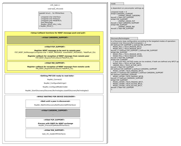

Let' start with the primary function called from main(), which is task_nfc():
Depending on the precompiler settings, this function will first register callback functions to handle NDEF message push, if P2P_SUPPORT is defined and NDEF message pull functionality. if P2P_SUPPORT or RW_SUPPORT is defined.
It then runs through a number of functions to initialise and then waits until a device is detected. Then when a Discovery Notification is received, this function will respond depending on what precompiler settings were defined.
For our application, only P2P_SUPPORT and RW_SUPPORT is required, so any card reader presented to the PN7150, which is associated with CARDEMU_SUPPORT, will get ignored.
So, for example, if a NFC enabled phone is presented to the PN7150 the function NxpNci_ProcessP2pMode() will be called first (to handle NCI protocol data packets) before moving onto the next function call task_nfc_reader() if RW_SUPPORT is enabled, while if a MIFARE card or a NFC Tag, for example, is presented then only the function task_nfc_reader() will be called as with cards only RW_SUPPORT applies.

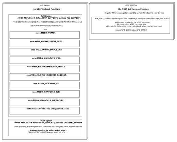

As NDEF is related to read and write or pull and push functionality, it is worth looking at the callback functions in more detail.
As shown in the diagram above, the PN7150 library has placeholders for all the key NDEF message types within the Pull Options callback function and also provides us with the ability to set and send messages to P2P supported devices via the SetMessage function and the Push Option function.
This is exactly what I need for my Office Visitors Book application.

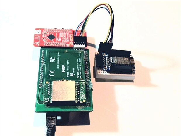

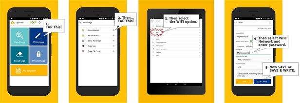

To achieve this goal, I used an NFC TAG (Type 2) to store my WiFi Network details. These details were written to the tag using NXP’s NFC TagWriter App, which is available for free download via Google Play app store.
The process, as illustrated here using NXP App screenshots, to choose the WiFi network details, enter the password and then save the dataset and write to an NFC tag is pretty straightforward:
Then all I do is present the NFC tag to the PN7150 controller and the WiFi details are collected and these are then transferred to my ESP8266 via UART.
Here’s a short video demonstrating how this is done. As you will notice in the demo video, I now have the library ported across and working on a Cypress PSoC 4 BLE module which is plugged into CY8CKIT-042-BLE-Pioneer baseboard.
