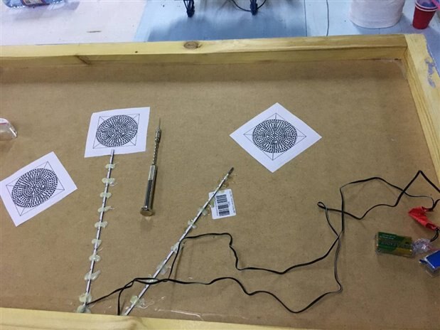

Three days of rain during harvest season has given some farmers reason to return to the model railway layout. With the RGBLED OFC's constructed, I took someone up on the offer to build the display and knit the strands through the holes.
{gallery} My Gallery Title
start of display2.jpg: Keep the beer fridge stocked for the help that volunteered to build the display.image
start of display.jpg: drilling holes and knitting strands, life of the extra helpimage

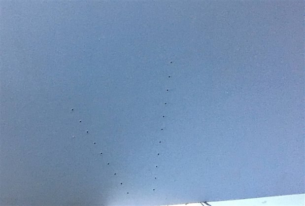

start of display3.jpg: nothing but blue sky, with hole poking through.image

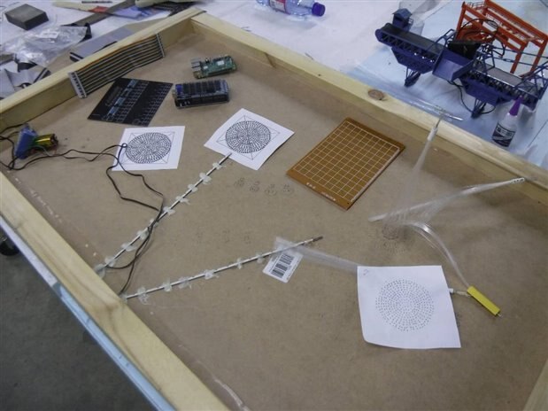

The display will have three fireworks burst circles. The bursts are number 1,2 & 3 from right to left. The bursts hole pattern templates or hole placement are shown. Each burst has three rings, each ring has holes to accommodate the strands from one RGBLED OFC with the exception of the outer ring having two RGBLED OFC's in parallel to provide coverage.  To the right of the picture you can see the start of RGBLED OFC's being knitted through holes in the display pane. The two LED strips in the center of the panel are the off the shelf sequential LED light strips that were kicking around the shop. When triggered they will create what is suppose to look like a fireworks launch.  Flipping the display board around you can see the LED light strip pattern holes poking through the blue sky background.
I confess the RGBLED OFC knitting is tedious work. First drill the holes according to the pattern and then individually push a OFC strand through the hole. With the aid of Elmers and heat shrink tubing a holding (yellow tube) can be seen attached to the panel for the RGBLED OFC to mount in. The heat shrink tubing secures the RGBLED OFC to the panel. The position of the holders is decided by the knitter as he completes a ring. I have been following the progress of the help and decided to make a beer run to keep the fridge stocked to show my appreciation. Model railroaders have all the patience in the world for this scenery stuff. I have watched them build fences that are meters long with one toothpick at a time.
