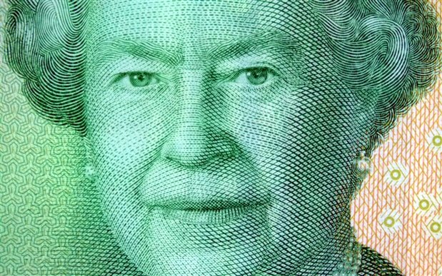

It is interesting to see how a bunch of lines can be organized into a passable likeness of the Queen. Try clicking on the image.

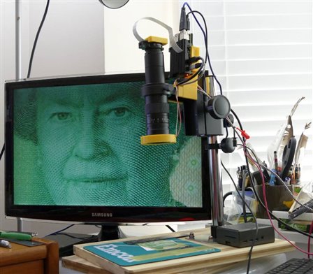

I have been scrounging and collecting parts to build a digital microscope for many months. My idea was to build a decent microscope around a Raspberry Pi HQ Camera. This required a good lens and adjustment mechanism, neither of which is cheap, I scoured the net for a long time to find the best possible deals. At first it seemed like an easy project - just add a lens to a camera and you have a microscope, that premise lured me into the project, and by the time I realized it was going to be a lot more effort than anticipated, I had spent enough money that I couldn't dump the project.
There were five 3-D printed parts in the finished project, which are expected to take quite a while to design, but I wasn't anticipating how long the base plate would take. Just flat counter-sinking the 4 screws through the wood at the correct depth took hours, mostly because I don't have the proper tools for wood working.
The steel torque plate took a whole afternoon to hack from a massive chassis, also because I don't have appropriate tools for metalwork.
I thought at least the software would be easy since many camera functions are built right into the operating system. In fact I figured there would be all sorts of programs that others have made that would do exactly what I wanted, which wasn't much.... just have a continuous preview, grab a still image at the press of a key on the keyboard, or start and stop video recording from the keyboard.
I read somewhere that you can't input from the keyboard when the preview is running. It even ignores control C.
I ended up writing some simple Python programs that can do what I need, but the software is still a work-in-progress.

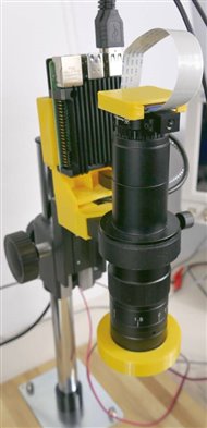

Here is a quick video showing the various 3-D parts from all angles.

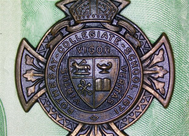

When fooling around with a microscope, there is a tendency to put anything you can find under it. I just pulled out a drawer looking for items of about the right size. Here is an example of a medal from my high school days...If you have ever analyzed medals you will recognize the quality of workmanship in this one.
The Hardware
Here is a video explaining the the microscope hardware....
The BoM
Item Image Notes
Raspberry Pi HQ Camera image
Angel Eyes LED Halo Ring Lamp image
48mm ID
12V 300 mA
$2.09
Raspberry Pi 4B image
50mm Diameter Adjustable Lens Holder image $19.44
25mm Industrial Microscope Limit Fixing Ring image $5.26
25mm Metal Fixed Microscope Stand image $13.80
Eakins Adjustable 180X Zoom C-mount Lens 0.7X~4.5X Magnification image $45.57
WD30 0.3X Barlow Lens image $8.07

A long time ago I did a project to implement a digital microscope for an semi-automated forensic analysis application using a $100K microscope system. Digital camera technology was not as good then as it is today, so this Raspberry Pi microscope could easily give that system a run for its money. I am very impressed with the clarity and resolution this new system creates. I wonder what we could do with $100K today.
It is always cool when you can squeeze 3 different Raspberry Pi products into one project. Raspberry Pi 4B, Raspberry Pi HQ Camera, and a cameo by a Raspberry Pi Pico.
This project involved hauling two back-burner projects off the shelf and putting them on the front burner:
  1. a digital microscope
  2. a solder tip maintenance project
Microscopes are both fun and useful, so despite the long gestation period, I like the result - it produces great images and video with a very useful range of magnifications. There are still lots of opportunities to improve the system, but it is useful as is. The digital microscope is easy to experiment with and is does help with some of the issues I have with my stereo microscope, but a stereo microscope would still be my first choice. Some stereo microscopes have a camera port, but that is beyond my budget.
The Raspberry Pi HQ Camera does a great job in this application, providing high resolution images and video and the C mount makes finding an appropriate lens easy.
The lens provides a large working space and it can slide up far enough to use a vise to hold a PCB or other item of interest.
The Raspberry Pi 4B is of course a fully capable computer, so this system is more than just a microscope. Since it has a big HD display it can also be used for all the computing and information access needs on the bench.
The soldering iron tip maintenance project was interesting and a good application for the microscope. I learned a bit about how to re-condition tips while tackling this bucket list project.
The final note about solder tip maintenance is just what everyone agrees on - always leave solder on the tip and turn off the heat whenever you don't need the iron for soldering.
I am very happy with this build and the performance of the microscope.

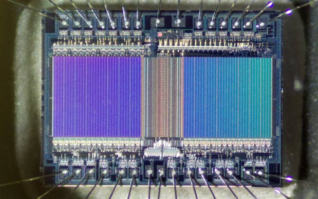

Who remembers EPROM?  This blog shows a 27512 EPROM chip imaged with this microscope
