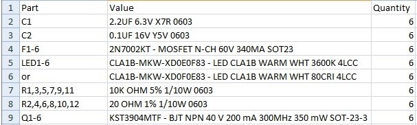

The Lighting elements - The basis of all the Lighting elements is a 6 channel, constant current, LED module.  Here are the layouts and schematics:
The basic concept of the schematic is a simple constant current source to drive each LED.  The target current for the LEDs is 30mA.  At 30 mA, the sense resistor (20Ω) develops a 0.6 volt drop which begins to turn on the transistor, which in turn, begins to shut down the MOSFET that drives the LED.  The current measured turns out to be right on 30mA, and the current only changes slightly over a +/- 1 volt swing of the input voltage.  The final size of the PCB is 1.0" x 1.0", which gives plenty of room for the PCB to fit inside the light module. I decided to go with warm LEDs (3700-5000K) as I am not a big fan of the super white/blue light output.

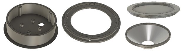

Here are 3D designs for the new parts:
Each Deck/Stair Lighting Module requires four the conical reflectors, two of the bridge pieces and two of the standoff/supports than fit into the end of the plexiglass tubes.  The bridge pieces are bolted together (small standoff facing towards the inside) and hold the lighting boards into place (along with their reflector/lens assemblies. Here are some images of the resulting assemblies:
