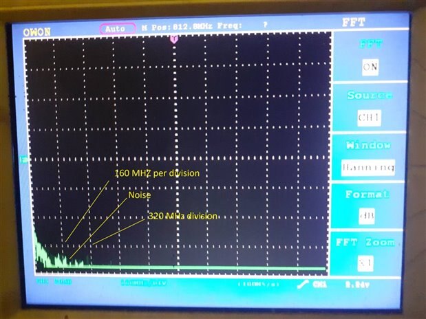

Series of experiment for setting criteria:-
experiment 1:- (selection of frequency spectrum for the project)
Because of demonstration purpose we are going to choose spectrum that are free from any noise. Bellow is the image of spectrum analysis for frequency spectrum.
Frequency up to 320 MHZ is filled with noise. considering per division as 160 MHZ.

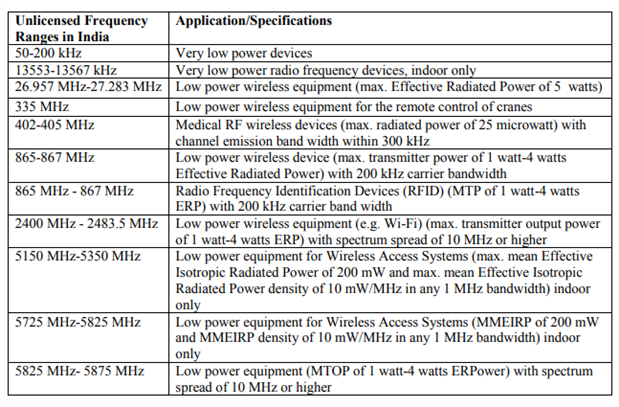

List of Existing licence-exempt bands in India.
For our project 865 - 867 Mhz is the perfect choice.
