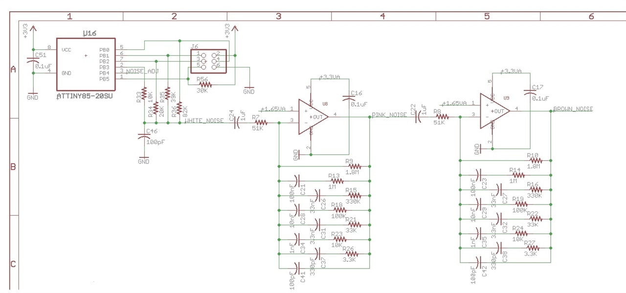

Here is the updated schematic fragment of the noise filters (White -> Pink -> Brown):
So, now we can take a look at the noise filters.  First lets take a look at the White, Pink and Brown noise sources, while the noise generator is commanded to a single bit noise signal:
The first image show the White and Pink noise signals.  The Pink signal is 180° out of phase from the input, as the filter is built around an inverting amplifier circuit.  The second image shows the White and Brown noise signals. The Brown signal is in phase with the input, due to two inversions, and can be seen rising and falling slightly with the peaks in the input waveform.  To get a better appreciation of the effects of these filters we will look at the resulting spectrum captures:
The spectrum views were captured between DC and 20kHz.  In both images the input signal is virtually flat out to 20kHz. In the first image, the Pink spectrum is down ~10dB at 2kHz ans ~18dB at 20kHz. The second image, the Brown spectrum is down ~20dB at 2kHz and ~36db at 20kHz, or very close to twice the attenuation of the Pink spectrum.
