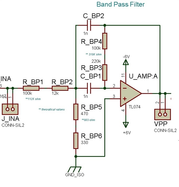

Bandpass Filter - [Fc = 10KHz]
It removes signals with unwanted frequencies and emphasis the 10KHz carrier frequency.
filter parameters - Multiple Feedback Topology with Butterworth response
Center frequency = 10KHz with 1KHz narrow bandwidth.
+3dB at 10KHz
-3dB at 9.5K to 10.5KHz
-20db at 40 KHz

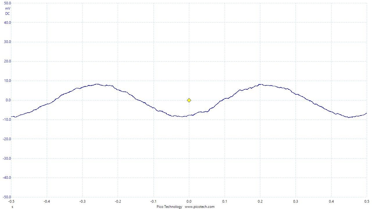

Test Output of the Voltage Measurement
{gallery}Voltage Measurement Test Output
Test Input: Sample 10KHz 1mV input at INA from external signal generator
INA output: 10KHz output from INA with first stage gain of 150 - signal includes little bit 50Hz mains noise too
Bandpass output: 10KHz clean output from the bandpass filter. Amplitude reduced.
Rectified DC average output: DC output from the rectifier with smoothing filter. carries the modulated respiration signal within the window.
High pass filter output: 0.7Hz high pass filter removes the DC part. Output shows the demodulated respiration signal of about 2Hz and only about 16mV.
Final output with gain: Second stage gain of about 100 provides a suitable respiration signal of about 1.5v peak to peak.
