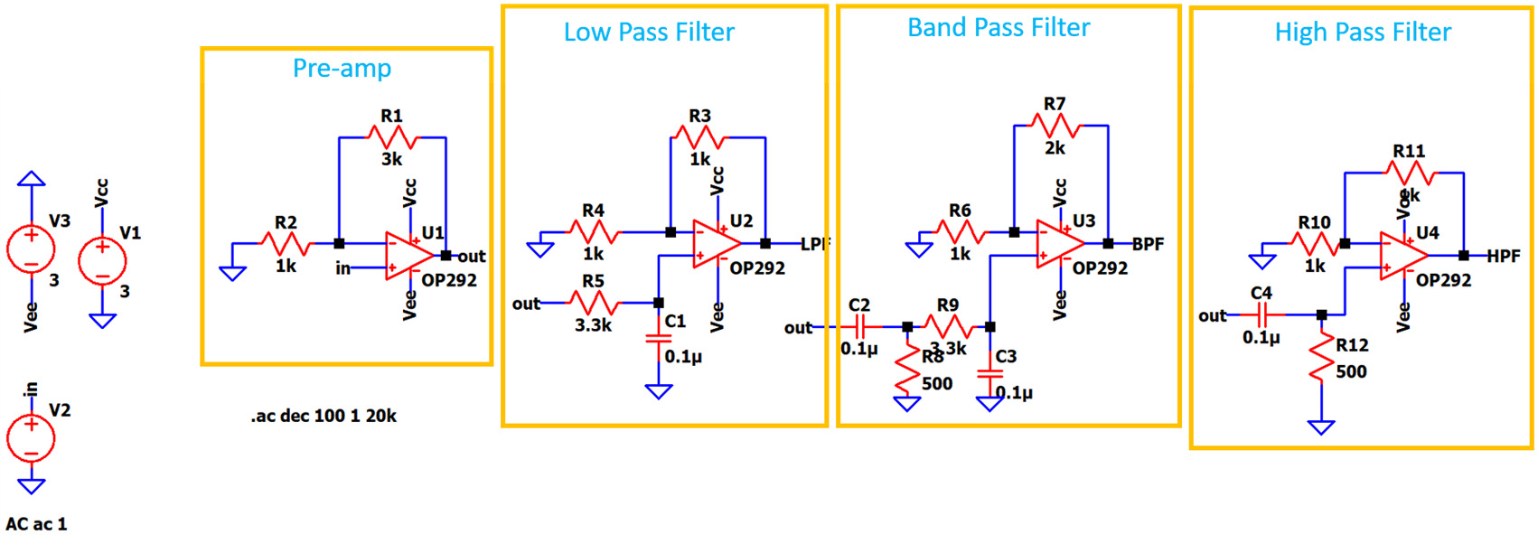

In this blog, I will do the calculations for the values of the components required to build the active filters and run some simulations before the final hardware build of the circuit. I will be using RC filters with Butterworth response.
The first block in the design is the pre-amplifier. A pre-amp is needed as I'm planning to use the audio out of a smartphone which is in the range of few millivolts. This signal needs to be amplified such that it can be fed to the three opamp filters.
The preamp is a very basic non-inverting opamp amplifier with a voltage gain of about 4-5.

Active Low Pass Filter
In the last blog, I briefly introduced the active low pass filter circuit. Considering the same circuit and as decided from the above table, Band 1 means a cutoff freq. of 480 Hz, which means fc = 1/(2*pi*R*C) = 480 Hz. Since we have a huge range of standard resistors available but the range of capacitors is limited, a standard value of C is chosen which is 0.1 uF.
By doing the calculations, the value of R is found to be 3315.72 ohms, so the closest standard value for R is chosen as 3.3 kohms.
Hence, design values for the active LPF are R = 3.3k and C = 0.1 uF. This gives the cutoff freq. of 482 Hz which is quite near to the actual cutoff freq.
Now, to set the gain of the filter, a nominal gain of about 2-3 works fine. For calculating the resistor values for gain, the simple gain formula for non-inverting opamp is used.

Hence, using the same formula of LPF, the R and C values for fc1 and fc2 are found to be R1 = 500 ohms and C1 = 0.1 uF and R2 = 3.3k and C2 = 0.1uF. This will give the values of fc1 = 3.18 kHz and fc2 = 482 Hz.
Active High Pass Filter
For the last block, a high pass filter is designed. The formula remains the same. The fc for HPF from the table is fc = 3kHz. The values for R and C are decided as R = 500 ohms and C = 0.1 uF.

I simulated the entire circuit in LT spice to check if it works properly. The simulation setup is AC analysis to check the filter response. The opamps work on a dual rail power supply of +/- 3V. For simulating the audio signal, I have used an AC source.
The below image shows the final circuit diagram along with the individual blocks labeled.
The preamp gives a voltage gain of 4 (non-inverting configuration) and the signal from the output of this preamp is then fed to three filter blocks. The outputs of these filters are connected to LEDs(not shown in Ltspice).

    jc2048 over 4 years ago in reply to rsjawale24 +1
    Could it be that your 'Pre-amp' section needs a dc path to the non-inverting input? If it is being fed from a source through a coupling capacitor, the op-amp side of the capacitor charges on any leakage…

    rsjawale24 over 4 years ago in reply to jc2048
    Thanks! I tried to feed the filter directly without the preamp, still, I'm getting the same results. I'll write a new blog soon and update all the results as well as the problems I'm facing. I'm a little surprised as this should work without any difficulty. Maybe I'm making a mistake somewhere. This is definitely going to be a good learning experience for me.
    Could it be that your 'Pre-amp' section needs a dc path to the non-inverting input? If it is being fed from a source through a coupling capacitor, the op-amp side of the capacitor charges on any leakage from the op-amp (whatever that might happen to be) and the preamp output could end up anywhere in dc terms. Quick way to find out would be to put a 10k resistor from the point marked 'in' to ground. That then pulls the average dc input to near zero. It will easily overcome any small leakage current, but is still easy enough to drive from any sensible piece of audio equipment.

    rsjawale24 over 4 years ago in reply to DAB
    Unfortunately, it's not working. I'm not sure what is wrong. Conceptually, it should work. For the LEDs at LPF, they remain always ON and for HPF LEDs always stay OFF. I tried debugging, but I do not have the required test and measurement instruments
