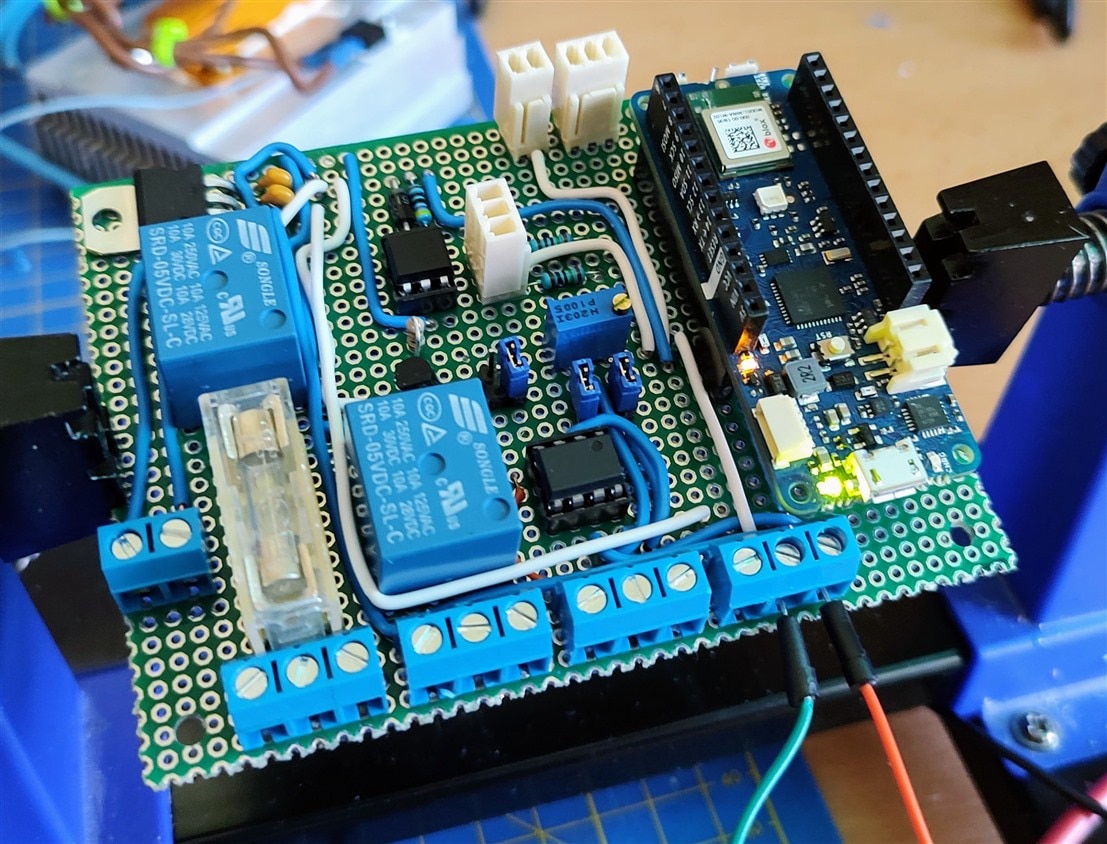

This is the part of the build that took the most time. Besides the Op-Amp, the system is based around the power resistor and MOSFET-s meaning that I had to make sure that they had adequate cooling. I found a heatsink from the CPU cooler of my first computer (a Pentium4) and first cleaned up the old thermal paste of it.
After cleaning it up nicely, I first measured the holes for the power resistor which I had to mount in the middle due to its size of it. To mount it, I drilled and tapped 2 M3 holes for mounting.
After taking the resistor off, I drilled and tapped 2 more holes on the sides for the 2 MOSFET-s I planned on using in the build. Another thing I did also was to get some thermal paste to make sure that the heat transferred as efficiently as possible to the heatsink from the components. Here is what the finished heatsink looks like.
The other part of the electronics is the carrier board for the Arduino with the Op-Amp and all of the other components. I made the board so it fits a standard MKR layout board on the top, but I managed to fry the MKR WiFi I planned on using by accident, so I just wired it directly to an Arduino Nano 33 IoT, but the code, and everything else, stays the same.
The thing I suspect killed the Arduino was the 3.3V regulator where I shorted it by accident. For it to not happen again, I later added a small standalone linear 3.3V regulator and used that.
