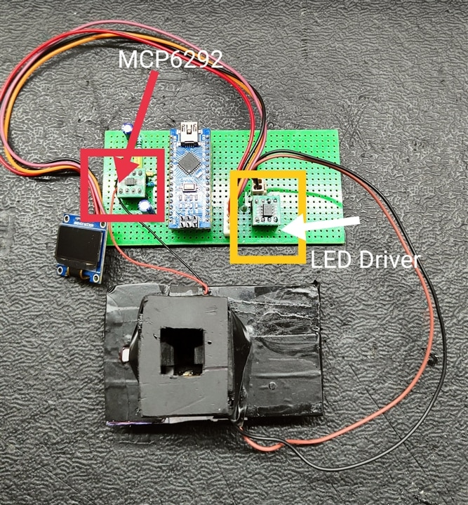

Chemical samples are analyzed through the photodiode and light source, The photodiode signals are fed to the amplifier circuit(MCP6292) to amplify the signal. The amplified signal is then filtered through an RC filter. after filtering the signal the analog signal is sent to the analog to digital converter pin of Arduino Nano. the microcontroller collects the converted data and processes the results and then transfers the data to the computer over the USB and  Parallelly displays the data on the OLED Display.

In this project to amplify the Photodiode signal, I have used A Op-amp mcp6292-e/ms along with the Arduino Nano and a led driver(PCA9533D). this device is powered through the USB cable which we normally use to program the Arduino nano. To place The liquid sample inside the device we need a cuvette, Here I am using Use and through Cuvettes.

Fig. Components And PCB assembled inside the Box

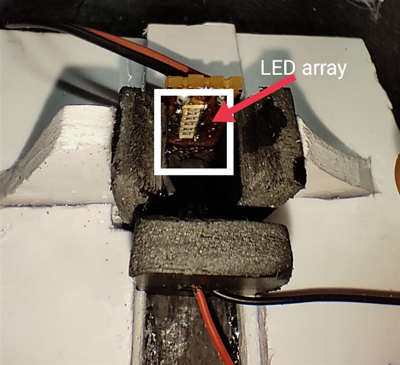

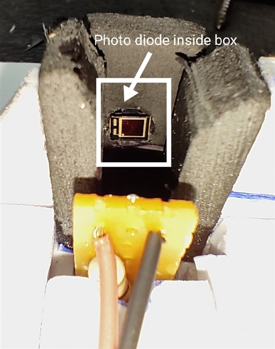

in this project placing the source of light(LED Array) and Photodiode to test the liquid through the cuvette need to be more accurate, In the below images you can find the placements of the LED Array and Photodiode.
In the below images you can see the Open view of Cuvette and Photodetector with LED Array
In the below images you can see The arrangement of MCU, Photodetector, LED Array
